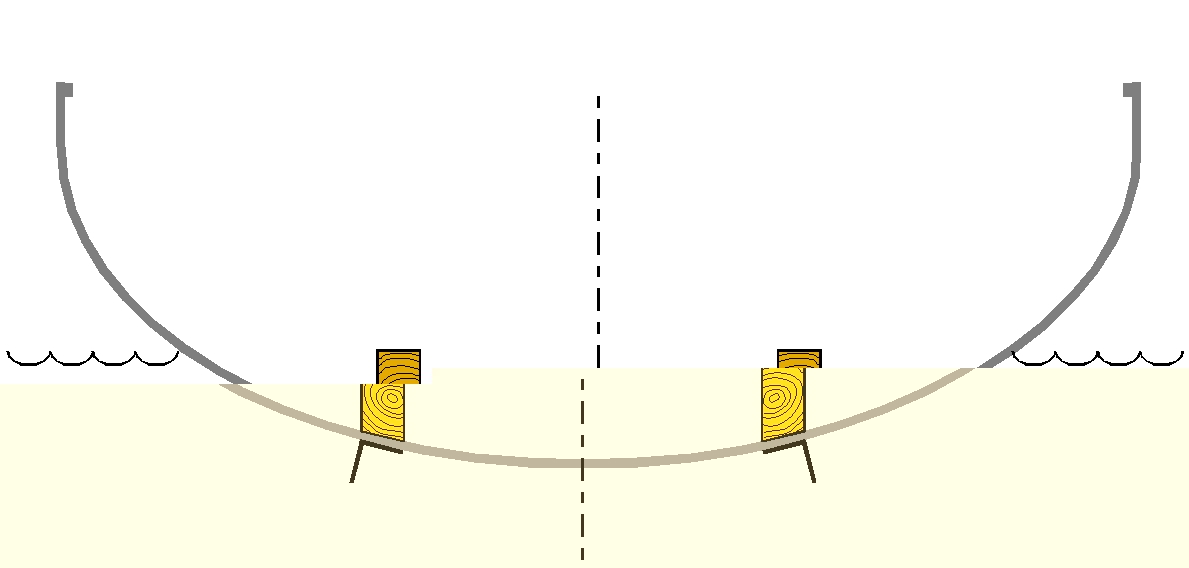

I have converted a fiberglass sailboat to electric power (so I could run with the steamboats while my sidewheeler was building). After cutting out the centerboard well and fiberglassing in a propeller shaft tube, I mounted "Bilge Keels" on the exterior of the hull, which gives good steering stability, and greatly reduces rolling in a typical sailboat hull that has a round bottom. These are made from aluminum angles, on my 14 ft boat I used 2" x 2" x 1/8" angles, your boat should probably have 3" x 3" x 3/16" angles. The bilge keels are bolted through the fiberglass hull, into wood engine/machinery mounting stringers that are mounted on the inside of the hull. This gives a strong setup with minimum work. The wood interior stringers should be bedded into fiberglass mat, or 3M 5200. The bilge keels should run about 1/2 to 2/3 the hull length, terminating near the stern. The interior stringers can run further forward, and will make a good mounting base for boiler, engine, floors, etc.
For efficient propulsion you need a big low speed propeller, the diameter should be about 10% of the hull length, with a pitch somewhat larger.
- Section through fiberglass hull sailboat conversion to steamboat.
- BilgeKeel.jpg (63.96 KiB) Viewed 14565 times

Hi Fred,
The bilge keels are a great idea ! I will definitely go that route. The hull I am going to use curves up a fair amount in the stern so I dont know how far back I will be able to take them. I will have to take a closer look at it in the day light. They might also provfide some protection for my condenser piping since I dont have a keel onder the midline of the boat.
jon
jon

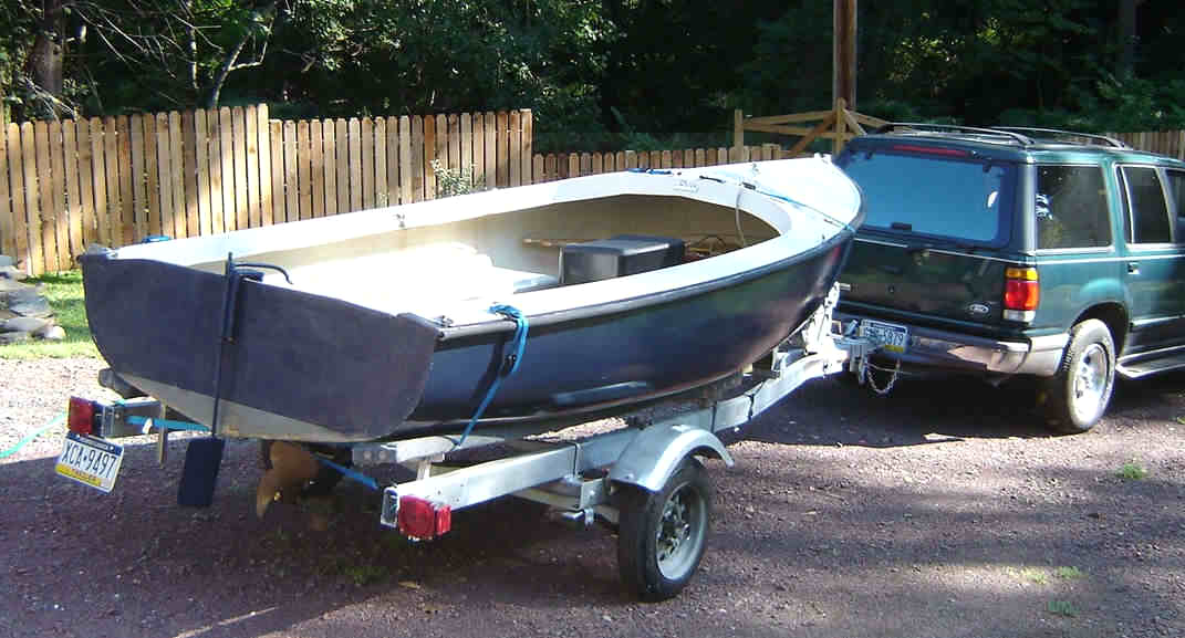

You can get more details about the conversion of a sailboat hull to moderate power at http://groups.yahoo.com/group/electricboats/
Get the file "Building an Electric Javelin" .
Now that I have a steam sidewheeler, I no longer need the electric boat. I am thinking of making the Javelin into a fast steamer, something with over 10 shaft horsepower, capable of about 15 knots. I would prefer to use a 17 foot Thistle Hull, but I already have the Javelin, converted to propeller drive.
- 14 ft Javelin with moderate electric power.
- Robert-EB SMALL.jpg (57.97 KiB) Viewed 14545 times
