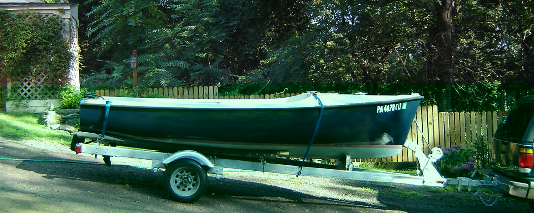

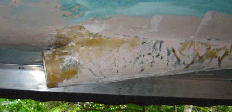

I did a similar job on a fiberglass sailboat conversion to indoard propeller drive, and have some photos of this work. It has worked well for 5 years now, with several groundings in shallow water, although it is only a 14 foot boat.
stern tube installation
Re: stern tube installation
- JAV SHAFT TUBE.jpg (22.22 KiB) Viewed 9063 times
- 14ftJavelinElectricProfile.jpg (110.65 KiB) Viewed 9063 times

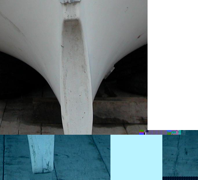

here is a shot of the stern from inside and the keel. the keel is about 3-4" wide
- keel.JPG (26.74 KiB) Viewed 9060 times
- stern view.JPG (65.84 KiB) Viewed 9060 times
John,
Yes, that is totally different than what I was visualizing. That shouldn't be much trouble.
Just determine the height of the engine from the keel, prop location and then calculate the angle.
