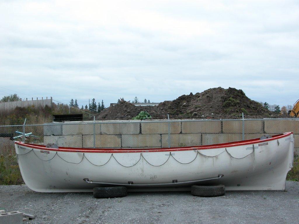

what is the besy way to drill the keel on a fiberglass boat, and at what angle so i can install a stern tube?
Re: stern tube installation
I think we would need to see an outboard profile drawing of the boat hull to best determine the shaft position. Can you post this?
As a life boat wouldn't she already have a stern tube and wouldn't it already be at the optimum angle?

no stern tube, never had an engine in her.

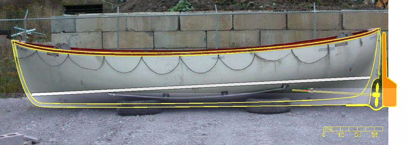

Here is a sketch with a starting point for discussion. I have assumed the 20 ft waterline length, marked with the white heavy line. Keel draft aft is about 9 to 10 inches more than the draft forward. The propeller is 17 inch diameter, with about 4-1/2 degrees rise from the keel. A rudder skeg is probably a good idea. Looks like a nice hull for a reasonable steamer, some parts are not ideal, but close enough to make a real nice boat.

Thanks, that's what i can visualize in my mind but in a couple of weeks i'll have to get the drill out and mak it happen. i'm trying to think of away to start the drilling process and finish it ending up with a straight hole. maybe a long hollow tube with a bit on one end and a shank for the drill on the other. that way it won't wonder. i can put a angle degree gauge ont he drill and as long as i maintain my angle and stay swaure to the keel with some guides it should work? sorry for the elementry remarks but it's my first boat build let alone steam boat.

Looking at your drawing closer, if that internal line in the actual profile of the keel inside, that won't be any problem to drill. I thought it came up a lot higher that that.
