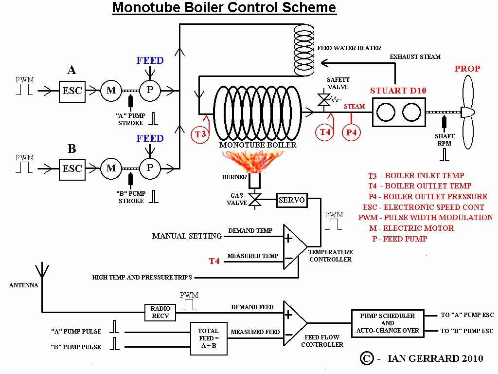

Hi,
Here is the monotube boiler controller schematic.
Note: the ESCs are the bulk standard pulse width modulation (PWM) to electric motor interface - the name is a misnomer, since, by themselves, they don't actually control the motor speed and they require an additional shaft sensor and controller to control the pumps strokes per minutes and hence feed flow.
Ian.
Ian.

Re: Perfect control of monotube boilers in our lifetimes!
Many larger monotube control systems run afoul of the substantial feed-forward delay caused by trying to measure boiler exit temperatures; a common solution is to measure temps about 2/3 of the way along the coil.
I continue to think that a Lamont type boiler is simpler, with the possible exception of the need for a circulation pump.

Hi Bart,
This feed forward delay was noticed very early on in the project even with my small boiler.
The current control system detects changes in feed water demand by looking at the incoming signal from the transmitter.
With an increase in feed demand, rather than wait for the outlet steam temperature to drop, it “heads them off at the pass” by opening up the gas valve in anticipation.
The amount of opening and its duration depend on the change in feed flow demand and a manual offset setting of desired steam temperature.
Likewise, if there is a reduction in feed demand, then the gas valve closes in anticipation of a rise in steam temperature.
This method of feed forward control is tunable by manually amending the sensitivity of the gas valve control to feed demand changes.
The analogy is when you drive a car and see a hill approaching – you don’t wait until the car slows down before applying the throttle, you apply it in anticipation; the same applies in going down a hill.
The big advantage of the software based approach was that different control ideas could tried without modifying the electronic or mechanical components. Different control versions can be downloaded in a few minutes.
All the best
Ian

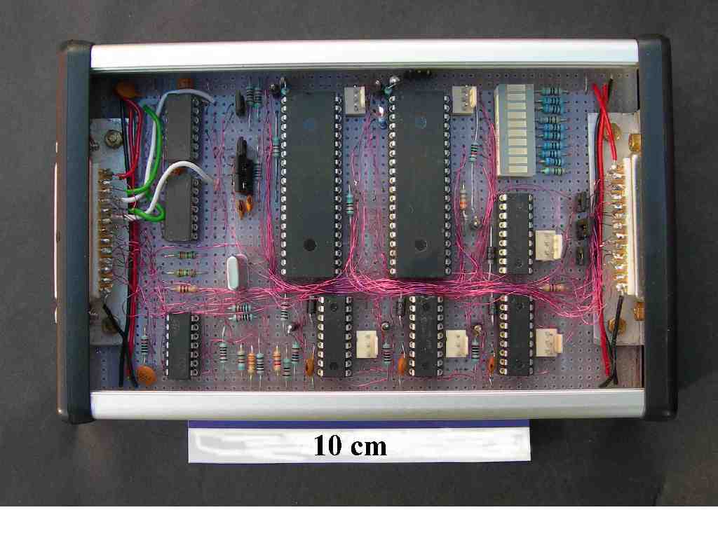

Please find attached a photograph of my “black box”.
All the best.
Ian.
All the best.
Ian.
That looks like a neat project... but my experience with wire wrapped boards in high vibration environments has not been good; the wire fatigues after a while. For a boat carrying people, I'd want to make sure things kept working. Perhaps it's our roads, but the vibration and shocks of trailering tends to take its toll. Also. the marine environment is a hard taskmaster. My brother sailed in the South Pacific for eight years, and carried two GPS units and two sextants - and found himself using the sextant more than once.
