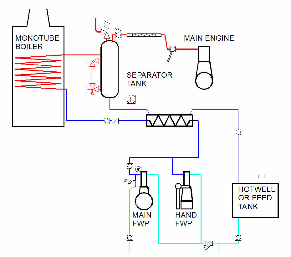

Monotube Boiler control, automatic with no moving parts.
Arrange the feedwater pump to supply about 150% of the steam generation rate. Steam/water mixture exits the monotube, and enters a separator tank, steam leaves the top, going to engine or superheater. Excess water leaves the bottom, and is drained back to the hotwell, flow regulated by a simple needle valve. Counterflow heat exchanger, with water from separator traveling in one direction, cold feedwater traveling in opposite direction. This recovers much of the energy that was used to heat the water in the monotube boiler, and cools down the hot water that is returning to the feed tank. Regular sight glass on the separator tank allows monitoring of water level. I also place a thermodynamic steam trap just above maximum separator level, this will come into play and prevent water carryover to the engine if the return water line is throttled shut too much and water builds up in the separator tank. This scheme has been used on monotube railroad steam heating units in the last century, and keeps all the monotube from overheating. Generally difficult with hand firing, but fine with oil/gas firing that can be held fairly constant.
MONOTUBE BOILER CONTROL SCHEMATIC
Re: Perfect control of monotube boilers in our lifetimes!
This "no moving parts" monotube boiler control setup requires a couple of percent extra fire, about 2% more than would be required for an ordinary drum boiler.
