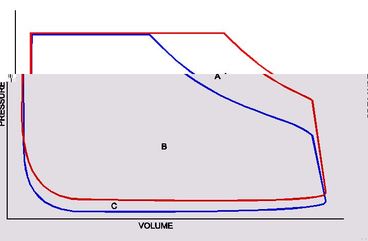

Pat, your reply :
“You can't dismiss any restriction in a steam engine, all will limit the power produced.
You can have too small a steam supply line, too small of ports and passages, too small an exhaust pipe, all can greatly limit the engine power.”
That statement is entirely true, and I did not intend to imply anything contrary to that.
I was having difficulty with the statement “He (the Stanley owner) says the shorter cutoff at higher speeds is not for efficiency, but due to a minimal sized exhaust port and pipes, and the shorter cutoff releases the backpressure from the engine after release, and allows the engine to make more power."
What I was trying to say is that, for any given engine (in this case a Stanley Engine with restricted exhaust), longer cutoff will always give more power, assuming all other relevant parameters are being held constant. The relevant parameters in this case being inlet steam pressure, engine RPM, and exhaust passage size . If steam inlet pressure, RPM and exhaust passage size are held constant, then longer cutoff will always give more output power, and this is true if the engine has excessive exhaust restriction or not. This is also true at any steam inlet pressure, and at any given RPM.
The attached P-V diagram illustrates the point, two PV diagrams, the Blue curve ( Short Cutoff and lower exhaust pressure) and the Red curve ( Long Cutoff with extra exhaust pressure buildup due to restricted exhaust passage) The red curve shows extra work of long cutoff, giving more diagram area “A”. The Red curve also suffers a loss of work due to exhaust pressure buildup, area “C”. However, it can be shown that the area “A” (gain) is larger than area “C” (loss), thus there is a net increase of power output by increasing cutoff. The Blue curve has higher efficiency, but lower gross output power.
There can be cases where the application of longer cutoff would lead to lower power output, for example if the boiler was undersized and not capable of keeping up steam pressure. All parameters being equal, longer cutoff does indeed consume more steam, so the boiler pressure would drop off as longer cutoff was applied with an undersized boiler. In this condition, shorter cutoff could be applied, and the engine’s efficiency will improve, and output power would increase. But here the reason for the increased power is the better efficiency generally associated with higher steam pressure and shorter cutoff, contrary to the Stanley owner’s statement.

SteamGuy
- Posts: 50
- Joined: Wed Nov 03, 2010 4:50 am
- Boat Name: To be determined
- Location: Central USA
Re: Stephenson's Link Hookup Question
Fred-
I guess I don't really follow your arguement very well (my lack of knowledge).
I will have to ponder those ideas for a while.
Den-
I am also confused about changing the cutoff using the links in a marine compound, since it was said that the lp cylinder really did not need a shorter cutoff, but then someone else said they operate their marine engine with the throttle full open, and regulate the engine speed using the links to shorten the hp and lp cutoff?
A bit confusing.
So does that mean you remove the lap from the lp valve? or do you just shorten the cutoff on the lp cylinder as the link is adjusted?
Den-
A bit confusing.
