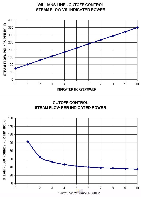

With any fixed inlet steam pressure, I don't think that statement could be true. Longer cutoff will always give higher output power, at any operating speed, and/or at any exhaust pressure buildup due to restricted exhaust.
An easier way to understand steam engine performance at part loads is with the "Willians Line". Documented in the late 1800's, it was shown that virtually all steam engines with cutoff control had a very nearly linear steam flowrate vs power output, up to the point of the engine's "best efficiency point" (BEP). For throttling control of engine output, the "Willians Line" was somewhat curved, showing higher steam consumption (higher than an equivalent cutoff control engine) at loads below 100% of BEP.
The attached graphs show the Willians Line, and the resultant steam consumption per horsepower, for a cutoff control engine. The later graph compares the performance of cutoff control vs throttling control. Note that at 100% of BEP load, both engines have the same cutoff and no throttling, so they show the same steam consumption and efficiency. At low loads, linking up (reducing cutoff) will always give better economy than throttling control, although the difference will be small at relatively high loads.
- WILLIANS CUTOFF.jpg (75.32 KiB) Viewed 28840 times
- WILLIANS LINE - CUTOFF VS THROTTLE.jpg (92.11 KiB) Viewed 28840 times
