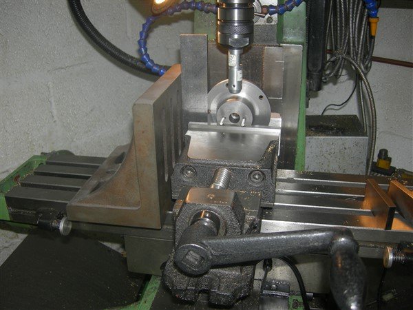

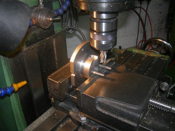

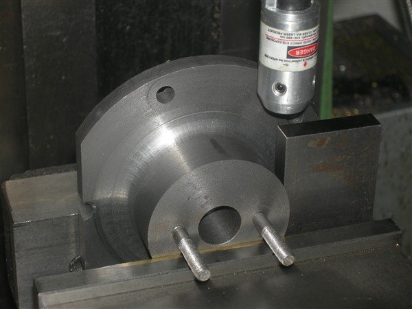

The job is cutting the bedding pad on the bottom covers for the slide bars, I have a laser centre finder but don't trust it totally, it seems to fit differently every time, and setting up is as painful as resetting the miller head to zero, so not undertaken lightly. It also isn't wonderful on curved surfaces (might be my cataracts). The first part is to set up the cover in the machine vice. Large angle plate and a parallel to get the cover vertical.
Next to find the extremities, I got round the curved surface by setting a short parallel against it and using its corner, zeroed the DRO, then transferred to the other side, and used the 1/2 function to get centre. (I actually did it several times to be sure).
Set the depth, and fire up.
Result!
Side two another day.

Mike R said: "I have a laser centre finder but don't trust it totally, it seems to fit differently every time..."
When using a laser center finder, I found it needed to be rotating during use.
That eliminated any angular errors.

Exactly what I do, find the offset in whichever direction suits, then mark and rotate 180 and go again. A lot easier than trying to centralise it.RNoe wrote: Mon Dec 21, 2020 6:41 pm Mike R said: "I have a laser centre finder but don't trust it totally, it seems to fit differently every time..."

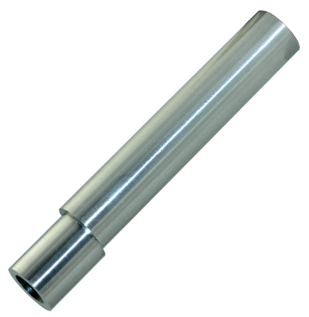

Any reference device needs to be spun to average errors associated with it's mounting and collet runout.
The inexpensive laser devices are a sad joke to the machinist, about as accurate as eyeballing. Yes, machining centers use them,but they are a far more precision laser.
Get one of these, an edge finder, pick up one side of your cylindrical object, zero out, move across, pick up the other side, then divide by 2. That is the center.

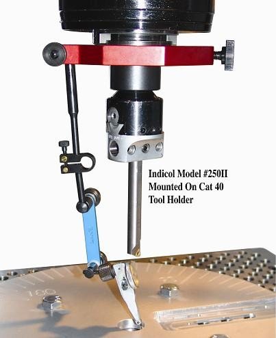

For indicating center of bores, holes, outer diameters, I use an Indicol/interapid combination. Any machine shop you go in, the edgefinder and the indicol and interapid or some close variant of it are the two mainstay referencing implements. I've seen so many machinists try those laser devices and after inaccuracies causing the spoil of a few workpieces, it gets tossed.
The indicol is also used to sweep ground standards after boat stoning the table to align the head ninety degrees to the work surface. Or 'tramming' the mill. Can also surf angle plates to check their ninety degree accuracy and parallelism to z axis. Lots of uses. Those two are the mainstay.

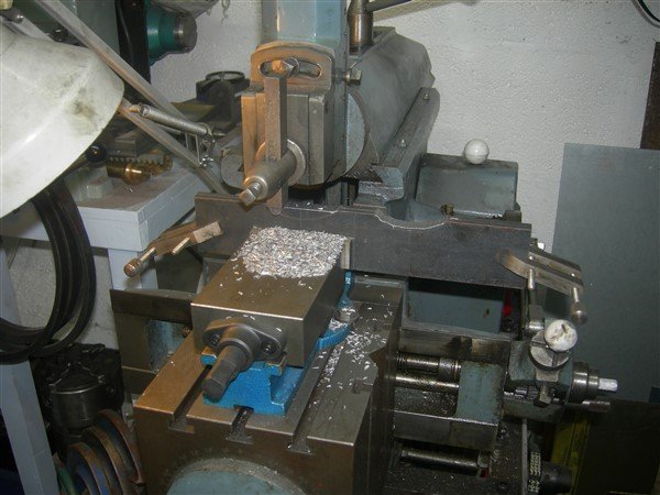

Today I cut the other slide-bar pad, and drilled and tapped the mounting holes. I'm not particularly a fan of socket head bolts on steam engines but this time they seemed to suit the purpose rather than the look, and they were 'to hand'.

I've made up the cyl. mounting plates. I roughed them in the shaper then finished off in the mill with a fly cutter.
