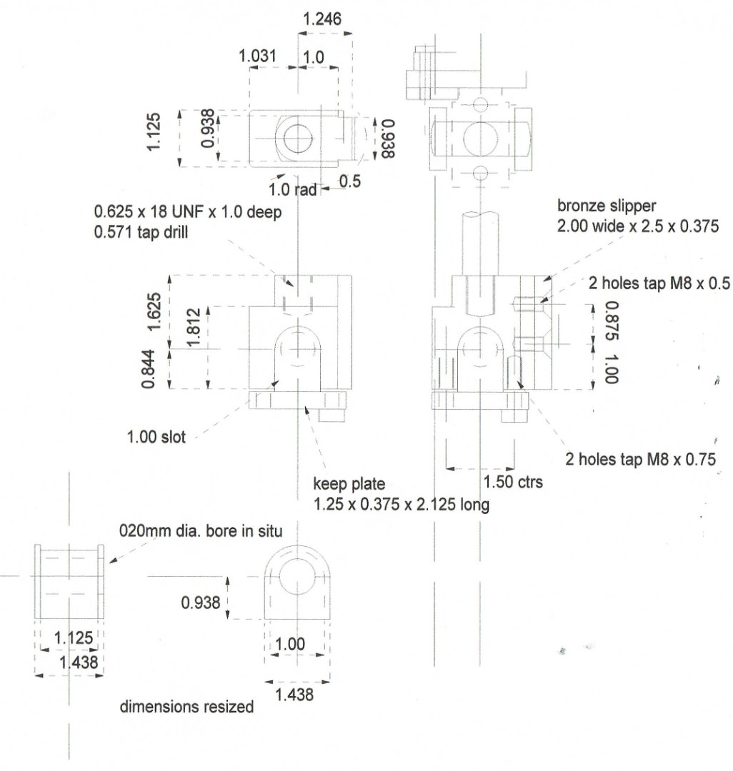

I think he's working on his piston rod, piston and crosshead. I like your valve gear solution but I don't think it would stand up to the the forces on the piston rod.
Re: And Now for the Twin
I've seen DT's method used a lot on hydraulic 'wrist' pins. I think it's quite neat. Yes I am looking at the piston rod to cross-head joint.

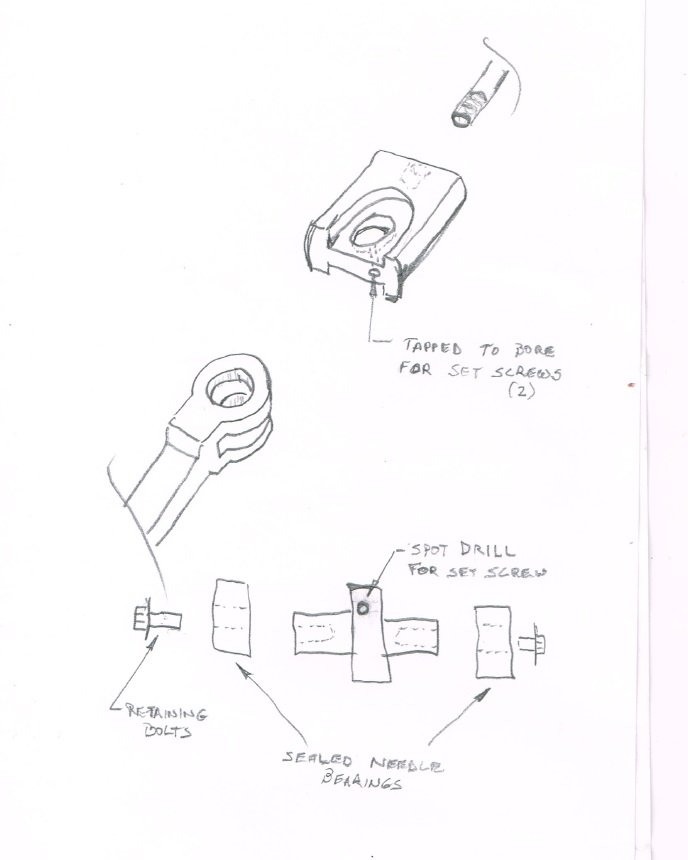

Mikes,
This is how I fixed the wrist pins. Use two set screws, one behind to lock it. That ensures that the pin will rotate in the bearings and not in the crosshead.

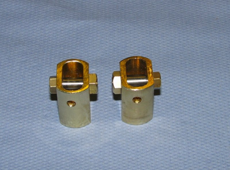

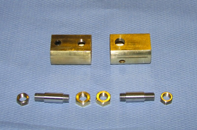

The correct name is a "crosshead pin bearing" known to sea going engineers as a "top end". below is a copy of the style I have used on all my recent built engines, using a pin which is fitted and dowelled to the conn rod, the bearing is adjustable and can be easily lubricated through the crosshead. I have used sealed rollers in the past with double style conn rods but these are of course wider and need lubrication holes through the pins. Lubrication of these bearings is essential and the clearance of the bearing fit should be the absolute minimum.

I have, with my usual bent for '3.00 AM engineering', come down on the side of shouldered and threaded. The rod is 10mm so M8 should cut it. That will make it tight at the bottom and still adjustable at the piston end as Mike L. suggested, as those are lock nutted. All the others I have done have been tapered and pin locked, but with the benefit of more 'head room' in the cyl.
