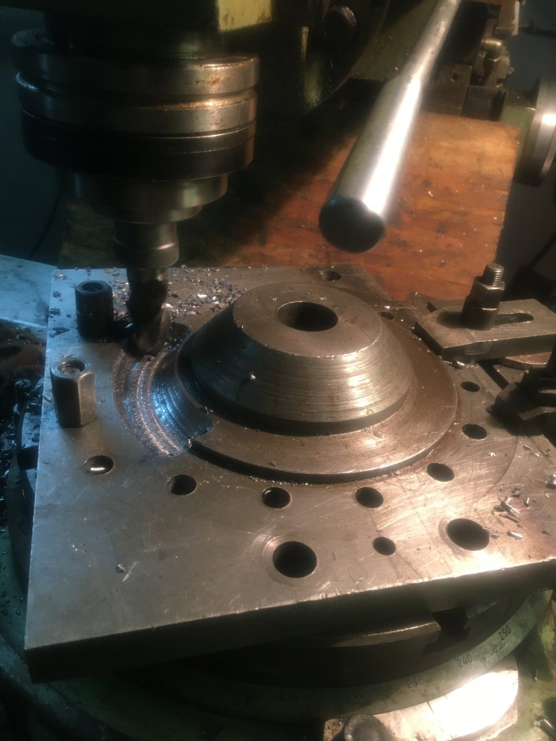

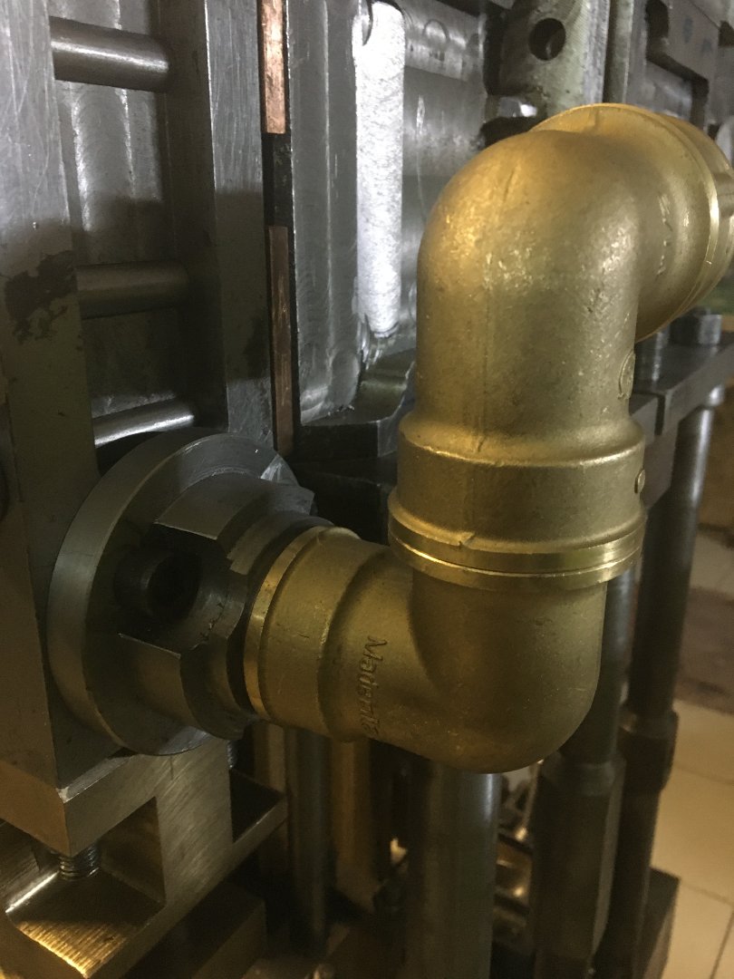

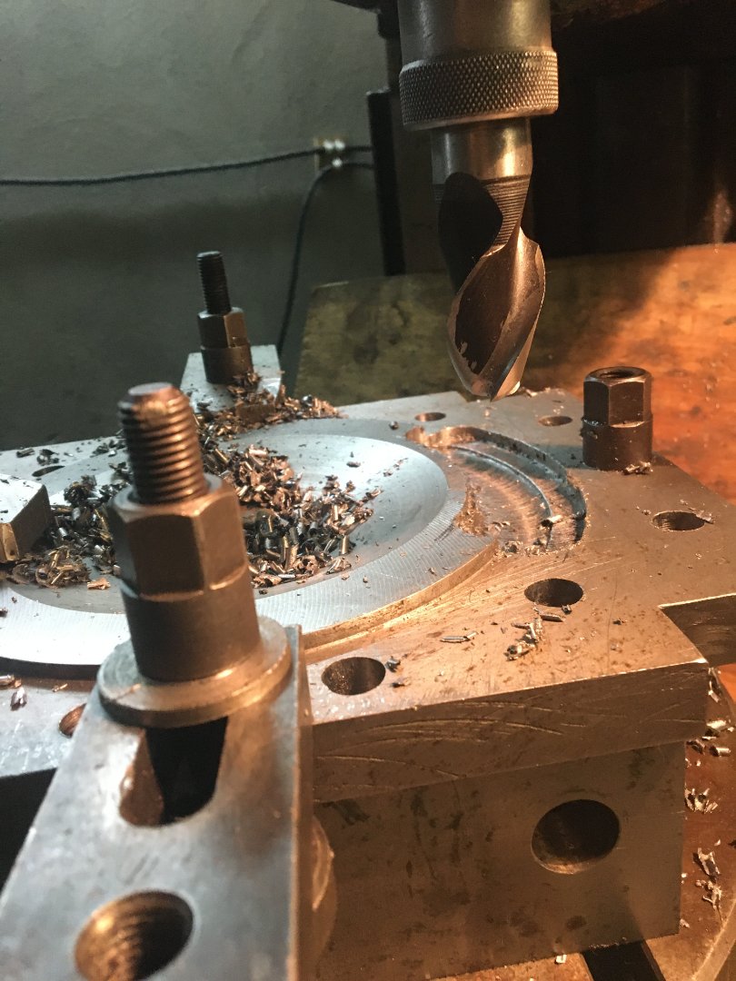

Continuation. I managed to finish the steam flange, besides i have already finished valve box mechanism.

Post by Freezerrr12 »

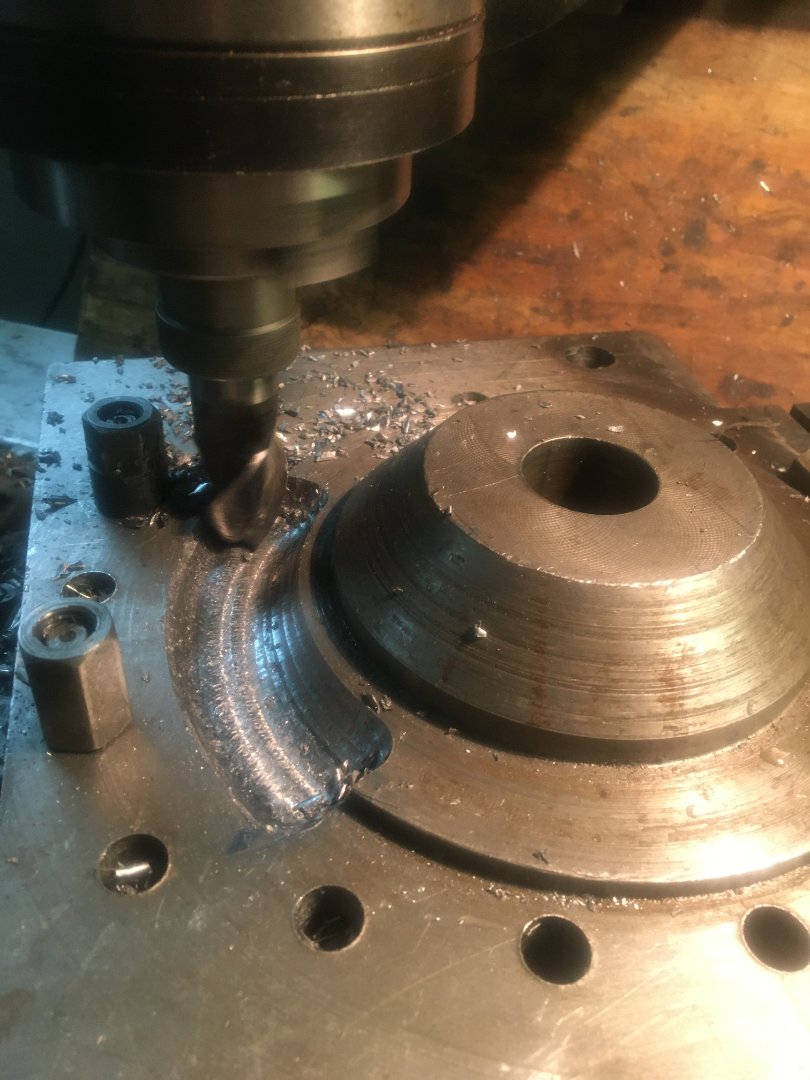

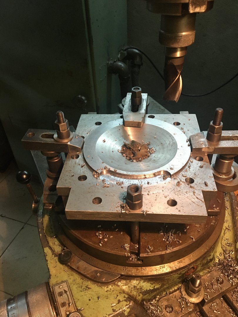

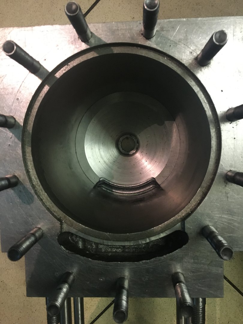

And this is the work under the cylinder cover.

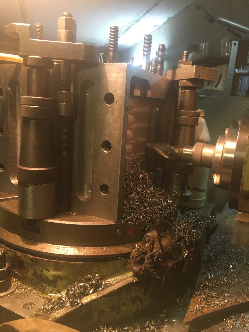

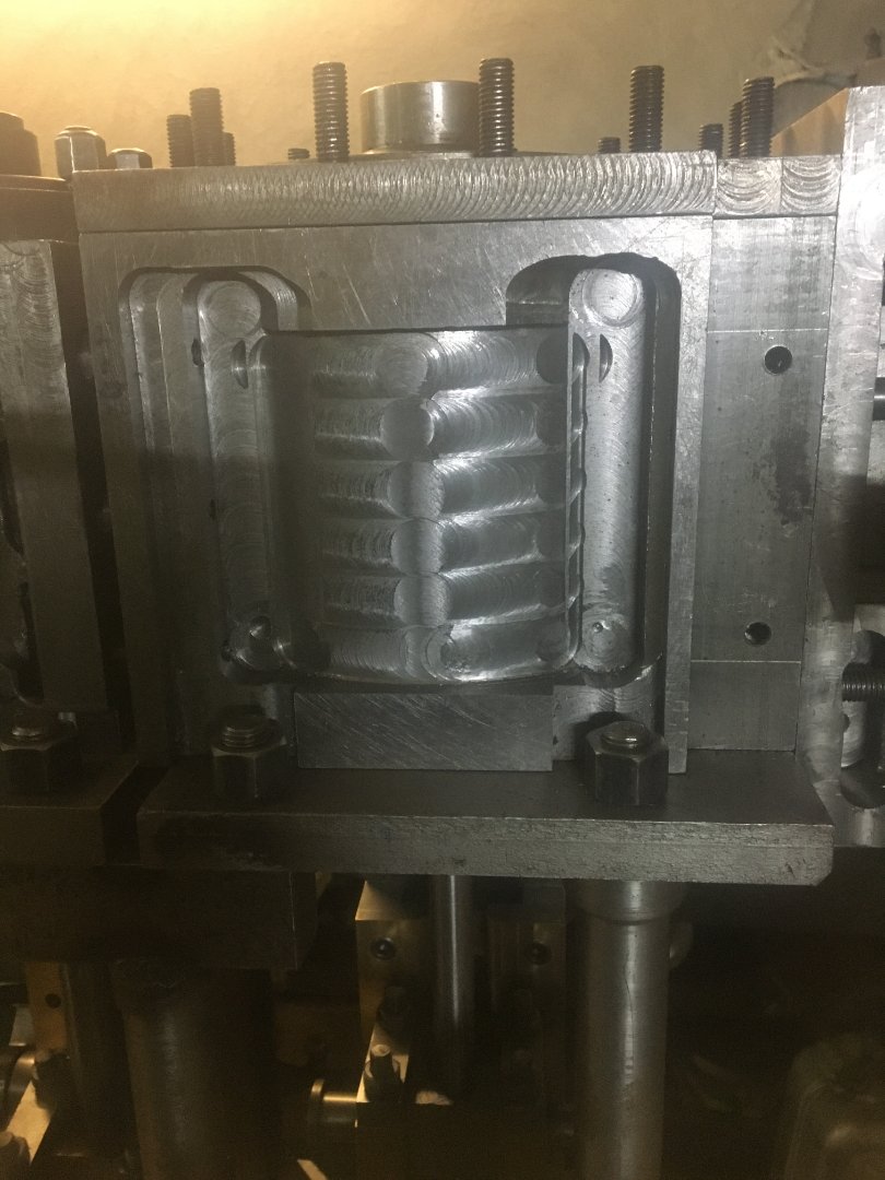

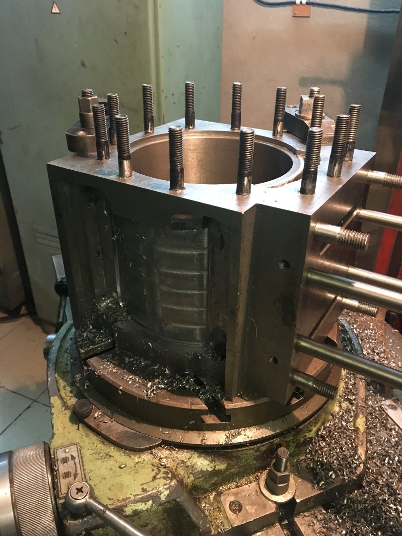

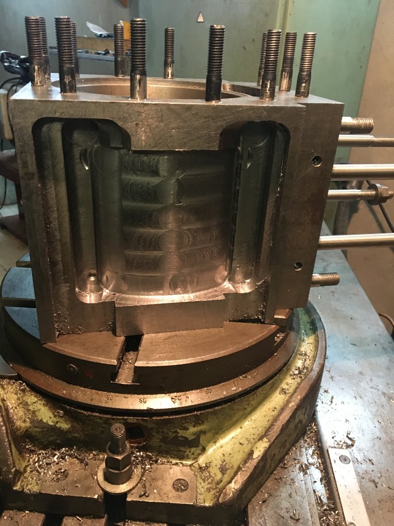

I welcome all forum participants, especially those who give me advice and recommendations for the further promotion of my project. Despite the unfavorable circumstances, I continued the external processing of the cylinders. This work is visible in the photo. The cylinder has become 2,5 kg lighter.

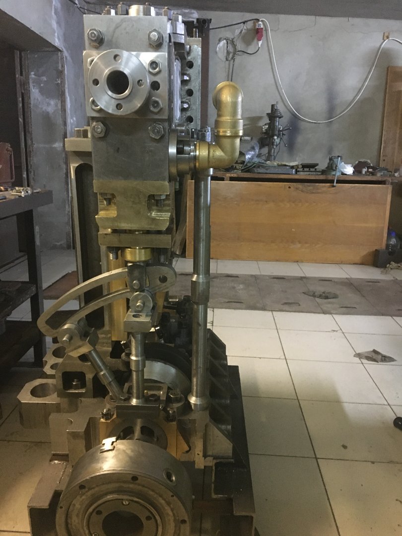

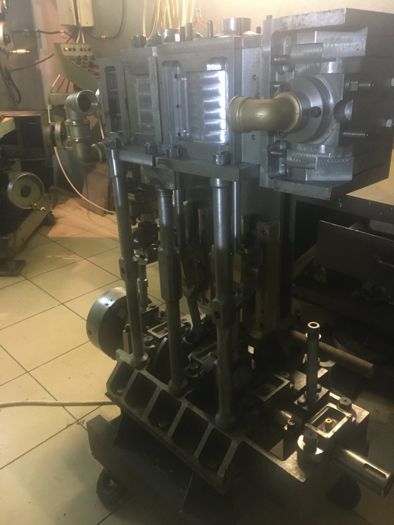

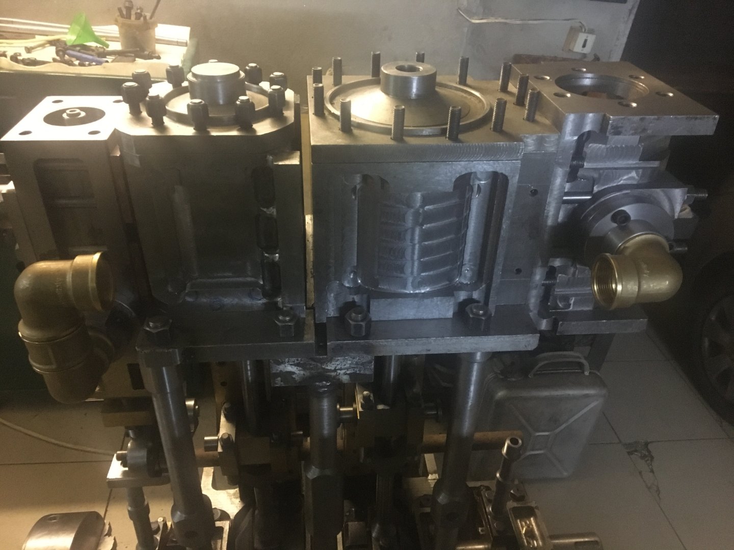

A general approximate view of the steam engine is also on the photo. The bronze fittings (elbow pipes) are 1 1/2 inches in diameter. The copper pipe is the same size. Advise to what extent it is necessary to increase the diameter of the copper pipe between the cylinders? Is a receiver between the cylinders really necessary?
The length of the copper pipe is 0.5 meters, the diameter is 1 1/2 inches. The approximate volume of steel pipes with bronze elbows is about 1,000 cm3. ( 1 liter)
This volume is equal to the volume of the high pressure cylinder.
