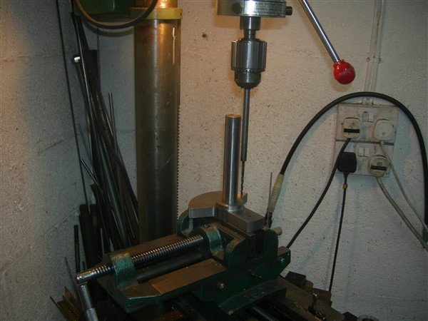

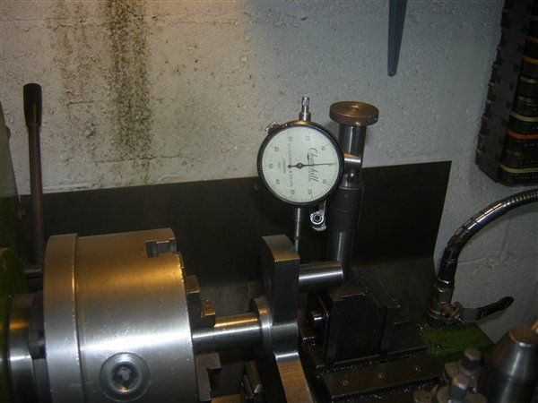

With the crank pin pressed in (no 'keyed'), I returned it to the lathe for checking and correcting.
Crankshaft (31) (600 x 450).jpg (50.28 KiB) Viewed 27171 times
Crankshaft (32) (600 x 450).jpg (51.73 KiB) Viewed 27171 times
I then discovered that it was too close to the main shaft to clear the drill chuck. :roll:
Crankshaft (34) (600 x 450).jpg (57.67 KiB) Viewed 27171 times
Some guys say Loctite is sufficient for drill extending, I use soft solder. Either way the drill is recoverable.

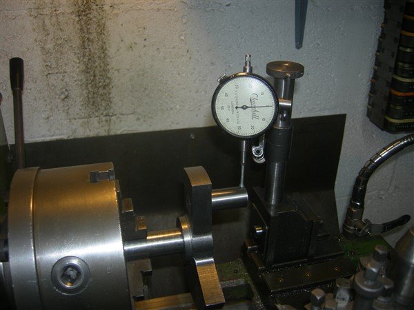

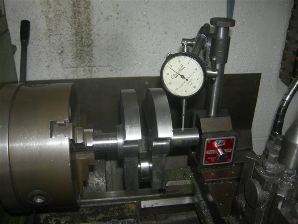

The next section main shaft was checked before final assembly in the lathe gripping the web in the outside jaws. Over the whole exercise I changed jaws back and forth so often that I resorted to the De-walt battery drill - and flattened the battery! :?
Crankshaft (35) (600 x 450).jpg (53.14 KiB) Viewed 27166 times
Aligned with the DTI at this stage, assisted by a soft hammer, then keyed of course.
The end of the centre main pin and the next web were cross-marked with the lathe tool to get the right-angle for the crank throws. Here I failed to take sufficient photos to show the whole process.

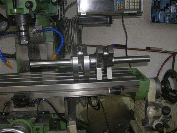

The crank-pin was pressed in, checked for true (as before), keyed and the unit pressed on. The last section was then pressed on and clocked this time by reversing the whole assembly in the chuck so as not to stress the first sections. Keyed again with the use of the extended drill. The result wasn't perfect probably due to errors being cumulative, but within a few thou. I wouldn't want to do a V8! :o
Crankshaft (40) (600 x 450).jpg (64.69 KiB) Viewed 27166 times
Fitted to the bed it rotates freely and the weights are sufficient to make it return to base.

I'm curious mike would turning between centers have helped eliminate some of the run-out experienced with the 3+jaw?
Maybe I'm missing something. Trying to play on forum between harpooning people's arms...
Re: And Now for the Twin
Wesley, I hear you about between centres, and if any further machining had been required at that stage that would have been the way to go, but it would have made adjustment difficult with nothing to push against (chuck). Doing it between chuck and centre, pushing a centre into the end of the hanging shaft could have given (I feel) a false reading, by pulling that end of the shaft out of it's natural line. The way I did it was the way we used to do the motor cycle ones (nearly sixty year ago!). The only recourse that one has is to rotate the web on it's crank pin and bring the two parts of the main shaft onto the same centreline, hence having to monitor the run-out of the chuck before making the adjustment and hope to repeat it. if for any reason the centres of the crank-pin holes aren't exactly the same from the main centre, then there will certainly be a discrepency, and over several, it could accumulate. In my case they were all bored on the same jig at the same setting so 'should' have been exact apart from any tool flex or miss-setting by yours truly of the boring head. One is also of course, at the mercy of the machine manufacturer, but I have no beef on that score. By the end there was a small amount of error, but acceptable and it cant be felt in the bearings. Talking of bearings, the eccentric ones arrived today.
