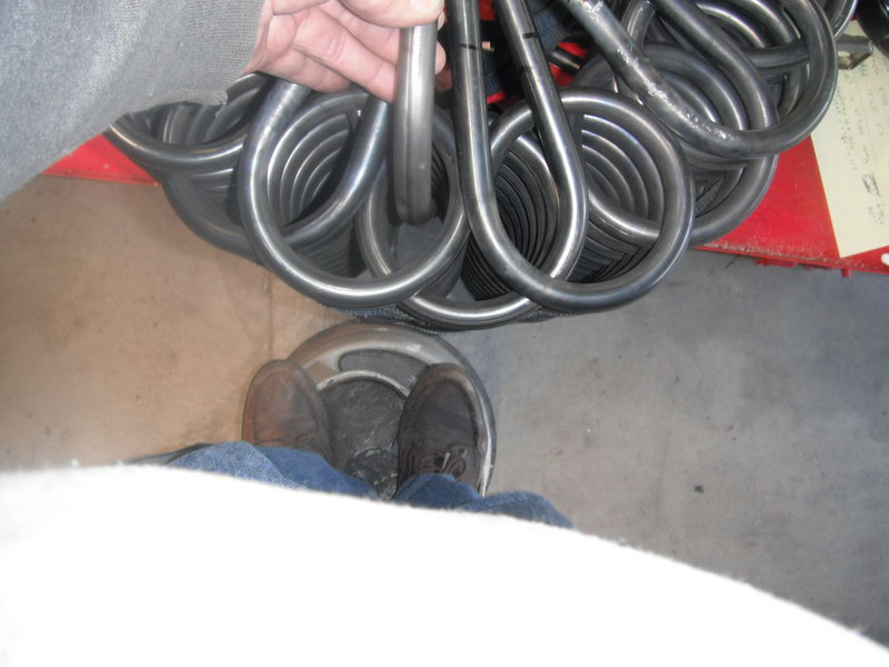

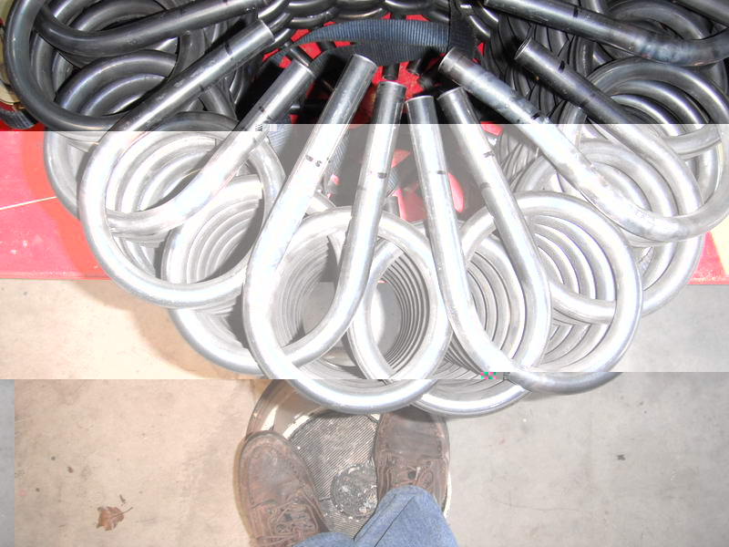

Pics before welded into drum, downcomers have to be assembled in two parts into coils BEFORE they can be installed into drum otherwise no way to install them !

Thanks for the pics, Ron. Definitely an impressive and neatly arranged work.
