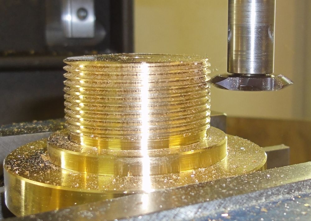

it's me again - it did some excursus to other hobby's... Now it becomes cold outside and I started machining my two sets of Navy-K valves
My home made CNC-mill is a big help with making such big threads. I had to learn all of this first. I changed from the original 1.5" - 16 TPI to M42 x 2 - nearly the same.
Movement frozen by the flash light. The special thread mill is spinning with 1000 rpm while it is circular and downwards guided around the bolt by CNC. Upper part is already ready machined. Lower part is missing 0.35 mm thread depth.

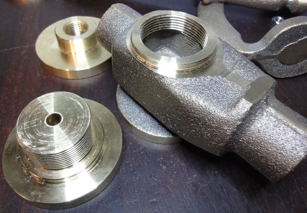

The body was machined with the same tool but software settings for inner threads.

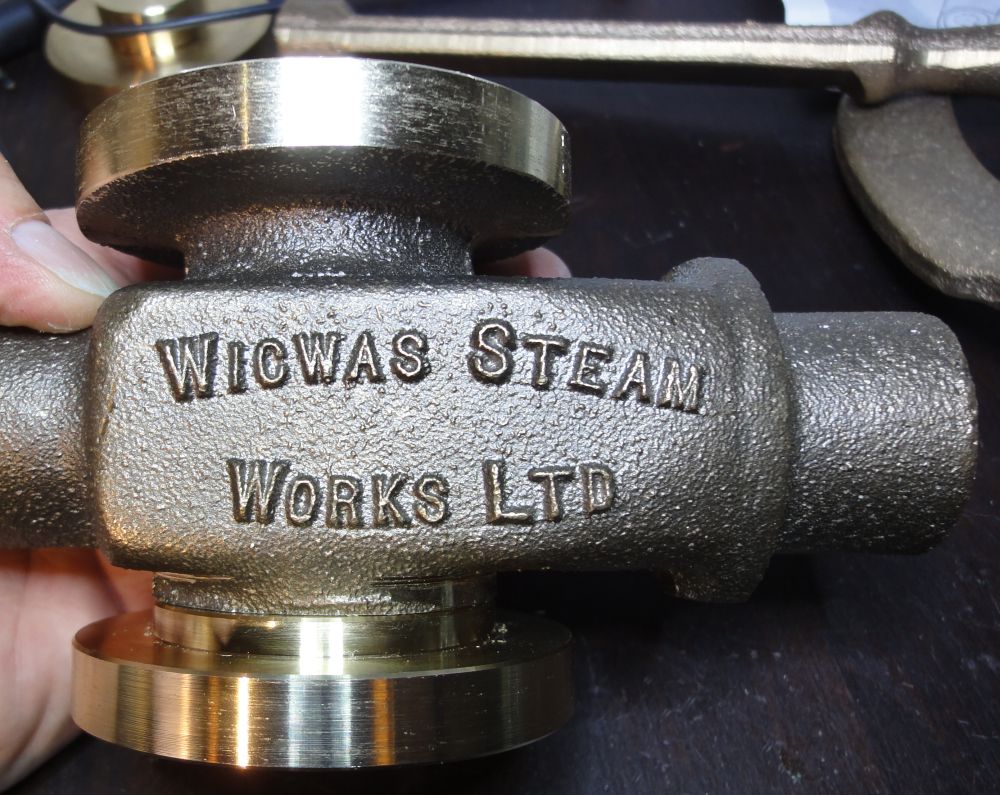

The flange and the body sits face to face against each other. This will secure the bolt orientation in the body and give me the opportunity to machine a V-shaped valve opening for best fine regulation.

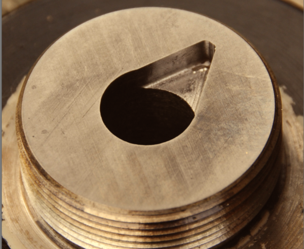

With the set of castings I got some pictures also. This shows such a V-shaped opening - any comments about the best form for this? Has anyone else machined this set of castings already?

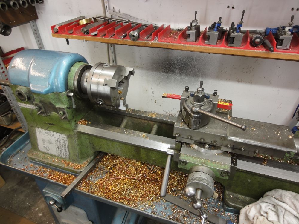

You are right but I am happy to find someone to turn the house because how to machine a thread with this lathe?Lopez Mike wrote:- like a joke where the light bulb is held stationary while the house is turned.
It is powerfull and precise - but without any gears...
But anyway - did anyone machined this valve already and can tell me which shape of V-slot is the best?

Rainer,Rainer wrote:Hello Boys,
Haven't started my casting set yet. I don't remember were it was mentioned, in the build instructions perhaps, that the V was added after the fact to give the throttle a bit more progressive opening. My guess is that Dave added the V detail and it worked so he didn't pursue the shape further.
You could stay "steel safe" and make the V narrower/shallower than in the prints and open it up after seeing if the throttle response is to your liking. I think the rate in which the area opens up is what is important and the current shape looks about right, not that that really means anything in a technical sense. My plan is to make mine look like the picture unless you find that something else works better.
Keep us posted with what you end up doing.

For reference, I have a simple ball valve throttle and the opening rate from closed is quicker than I would like. Its opening rate can probably be approximated by one circle uncovering another. Model locomotives have used a rather long, narrow and shallow groove but they are plagued with poor traction and spinning of the wheels.
As Ken suggests, start small. It will still have full flow at full opening.

OK - thanks - for the suggestions!
Will start small and machine away a bigger grove from backside. I have to install it on my friends boat in the US during my autumn vacations. There I have to use a file to enlarge it - because there is no mill available. But anyway - with a file I can do and test it on the boat instantly...
