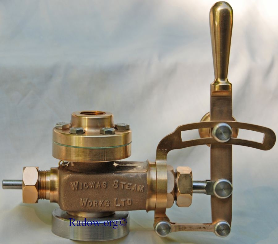

a friend of mine asked me to machine a valve.
First off all I thought "Why making your own valves?"
Than I got this pictures as appetizer:
It's a replica of a US Navy Type K Engine valve. I already found a picture of the original in the "STEAMBOATS & Modern Steam Launches" May-June 1962 issue.
Now I am desperately waiting for the over seas parcel with two sets of castings and hope to convince the customs officers not to take all my holiday money to buy Miss Merkel a new NSA proved cell phone.
Till than I will make new metric 3D drawings of all parts - first start:

That is a beautiful throttle valve. How did that work inside? Is it a sliding cylinder with a cross hole? Or is it a tapered cone? I can see the cylinder for flow regulation, but it would be difficult to seal it 100% off. A tapered cone could seal completely. I'm working on a Locomobile steam car project and I think it had the same type of throttle. Straight push and pull in the body.
Re: US Navy Type-K VALVE
That looks like boat jewelry to me... where can one get those castings :)?

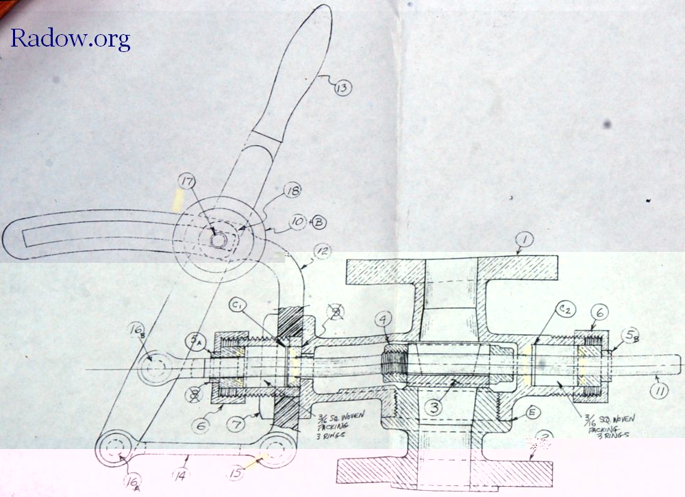

Have a look here - it's a D-valve. If you like you even could give the valve plate a V shape or what ever design to enable a fine opening curve:
You can mount/remove the D-valve (3) through the bottom flange (2). I will change some things of the connecting rod (11) and valve design but in general will take over this layout.

Is this a copy of an original valve? A few features are a bit confusing. Behind the valve seat there is a "plateau" or raised surface drawn in line with the surface of the valve seat for the valve to transfer over to in the open position(left of numeral 3 and below the numeral 4). From the drawing it looks impossible to machine (without a special right angle boom).
