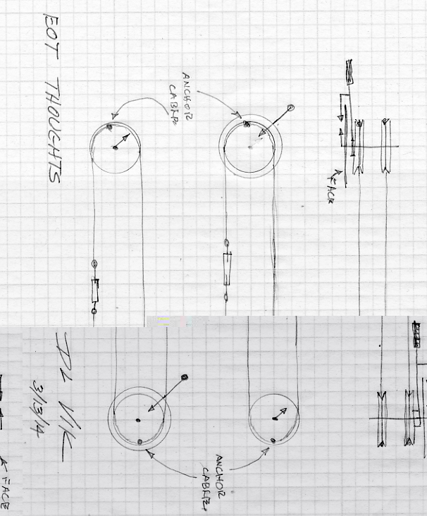

Mack,
I attached a little drawaing of what I was thinking of. In order to have the faces work right since they are mirrors of each other the would they would have to be configured as shown. If you needed to invert the engine room EOT it could be done but it would require crossing cables to provide proper rotation to keep ahead toward the pointy end of the boat. What I'm trying to show in the drawing is that the cables are rapped around the sheaves ( I too finally got it spelled right I ) with the ends cinnected at the turn buckle. The cable is secured to the sheaves with a clamping screw of some kind if that is possable.
All the best
Dave
All the best
Dave
- img226.jpg (247.04 KiB) Viewed 14561 times

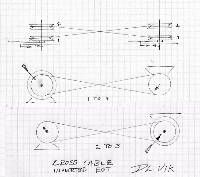

hears the concept for the crossing the cables to allow operation with one og the EOTs inverted. Mike,
How much can you expect from a guy that still uses a pencil?
It's all about having fun
Dave
