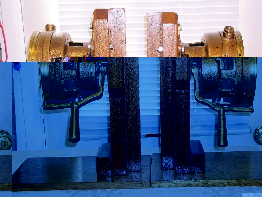

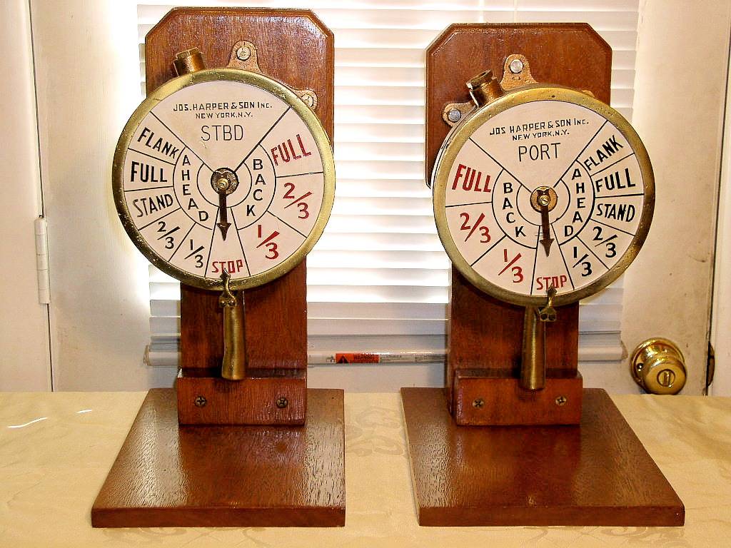

Well, Happy New Year Steamboaters!
I am happy to share that I have at last acquired a pair of matching EOT's for my boat project. To have found a matched pair, in workable and from I can see, serviceable condition is an amazing find. They arrived yesterday, were exactly as advertized and in exceptional condition. They are Port & Starboard Engine Room EOT's (due to their bulkhead mounting orientation) from a WWII Minesweeper. Unfortunately, the seller was not able to supply me with information on which vessel as they were picked up at a Nautical Flea Market from a guy that had a family member who salvaged them when the Minesweeper was being broke up for salvage.
I intend to install one in the Wheel House and of coarse the mate in the Engine Room. Even though they will say Port & Starboard on the face plates, I would rather not alter their original (or near original ) condition; who knows, maybe later.
I believe I have worked out the manner for connecting them via cable. I have not open them up yet to ascertain how to attach the cables (probably a set screw or anchor point), but have confirmed these units used cables, for there are no sprockets inside for a "chain" application. I figure it will take at least two cables for each wheel - one to pull clockwise & one to pull counter-clockwise on each wheel. It appears the Response Indicators on both units have been re-fabricated out of inferior lightweight plate brass. I will endeavor to have proper solid brass indicators fabricated at some point in the future.
I had dreamed of adding that "just perfect" touch of authenticity to my steamboat project, but was very doubtful that a single lever EOT would be found that I could afford, they are very rare. But a matched pair, I dared not hope for. However, the Good Lord has provided, as he always does, in His own time and manner.
I give thanks to Him and to a Seller that offered the exact item I needed at a price I was able to afford and the Sellers willingness to help my project forward with a much appreciated accommodation to his initial price. I WAS extremely lucky.
I will post pictures of their install & pics of my boat project as soon as I have the project ship shape and "Bristol Fashion"!
Happy New Year to ALL!
Cheers,
Mack
Cheers,
Mack
- Matched Pair EOT's
Jos. Harper & Son, Inc.
WWII Minesweeper - Matched Pair EOTs_1.jpg (133.29 KiB) Viewed 20018 times
- 8" diameter x 6 3/4" depth
- Matched Pair EOTs_5.jpg (119.32 KiB) Viewed 20018 times
