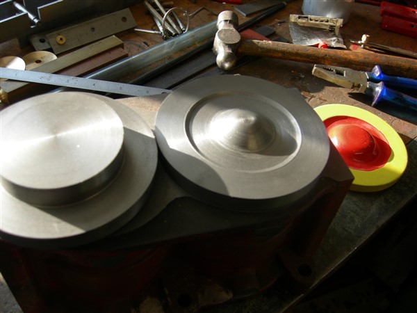

Well, I really hadn't realised that it was quite so long since I did anything other than think about this job. Over 3 years! I have to say I have not been totally idle, I did finish off a 16 year long loco project. (long, that's both the time and the loco
I have now made a start (re-start?). I've been thinking a lot about Mike's thoughts on pistons and that part is getting there. I'm not a 'drawing worker', I will/can use them when required, but generally if I can visualise what is required, then I just get stuck in and make it. Someone else can draw it afterwards if they wish.
The cylinder cover pattern has been discarded as that was one of the hang-ups, getting enough patterns together to make a trip to the foundry 40 something miles away, i.e. 160 miles total over some of the worst Motorway in the country, worthwhile.
Some slices of continuous cast iron bar have been obtained locally and the covers are now almost complete. A far simpler way to go. Shouldn't have wasted the time on the pattern in the first place.
Several thoughts are now in the air. Normally 6 fixings per cover, but should they, for looks reasons (or any other) be studs (I hate making short studs!) and nuts (what nuts), or bolts (which sort, hex, socket head etc.)? Also as the two covers are 'fitted' together between the bores what is the best orientation of the fixings, one between the cylinders (11 total), or avoid that place (12)? I propose to use the mill's DRO P.C.D. function so they can all be drilled in one settup.

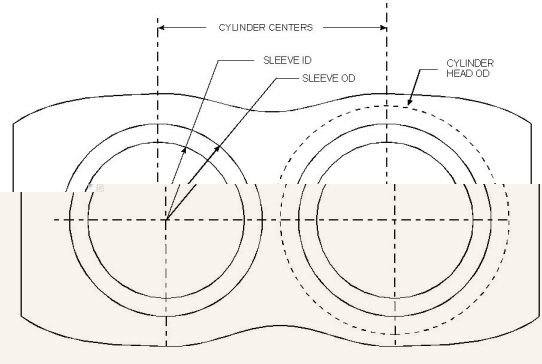

As far as cylinder head bolting goes, the best arrangement depends on available dimensions. If you could "fill in the blanks" of the attached drawing, I would be glad to suggest something.
- DIMENSIONS NEEDED
- 2CYL.jpg (31.96 KiB) Viewed 37580 times

Thanks for that Fred. The bore is 2.5", the liner is 1/8" wall (0.125"), and the centres are approximately 3.3" (within a thou or two). I'm thinking twelve, but the centre four will be slightly close.fredrosse wrote:As far as cylinder head bolting goes, the best arrangement depends on available dimensions. If you could "fill in the blanks" of the attached drawing, I would be glad to suggest something.
Ron, I'm glad to be back on it. I've located a supplier of Stainless dome nuts. The studs I've found so far are threaded the same both ends. Not what I was taught, but probably the modern way.
I've also measured the distance between the port edges and it is 3.5" exactly, so I think for safety a stroke no longer than 3.25" that will allow a 1/4" for rings, and on that thought I may go for two in the one groove or even a single Clupet ring. The Clupet doesn't need to to be wider than about 0.187" (they're made to order) which will mean it will never get fully to the edge of the port (assuming I don't B.U. any crank, or rod dimensions).
