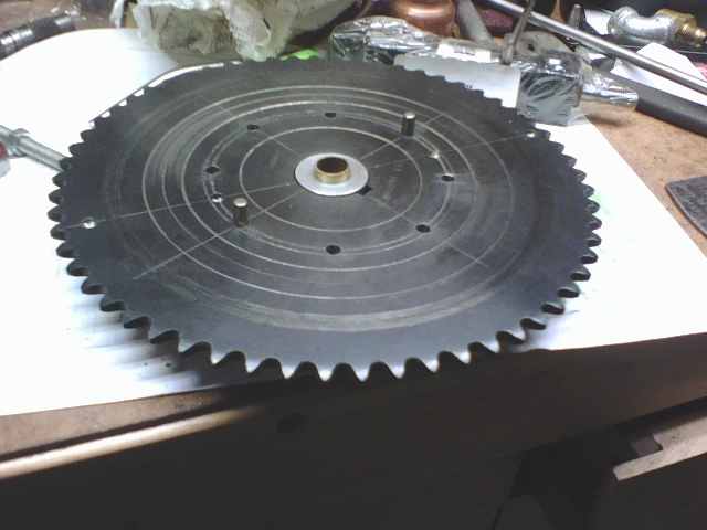

Completed the cylinder and steam chest parts.
Used a drilling template for the cylinder heads made from a common chain drive sprocket. The sprocket hub (other side of the picture) was bushed to match the cylinder bore, inserted into the bore, and clamped in place. Pilot holes drilled with reasonable precision.
The number of sprocket teeth can be selected to give reasonable spacing of bolt holes, without use of an expensive indexing device. In this case I needed 16 equal spaces for 8 bolt holes, straddling casting centerline, so I used a 64 tooth sprocket. Bolt circle diameter is scribed onto the sprocket face while mounted in the lathe, then pilot holes drilled.
If anyone is building this engine, I will lend the drilling templates for the cylinder flanges and valve seat surfaces.
- BC-Template-s.jpg (22.3 KiB) Viewed 11124 times

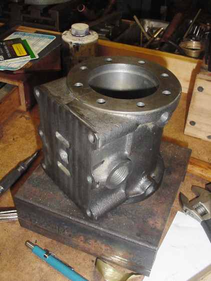

Completed cylinder casting, bored, counterbored, milled, and tapped
- Cyl-drilled-tapped-s.jpg (23.53 KiB) Viewed 11124 times

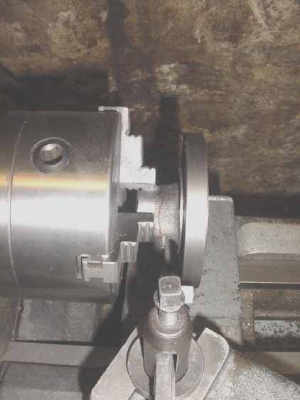

Machining the crank end cylinder head is a special case, as the mating to the cylinder bore and the crosshead bore must be accurately concentric.
In this case the ridges for both of these bores as well as flange faces could be made at a single chucking in the lathe, as the casting has an extension (for the piston rod packing gland) allowing the machining of both flange faces while maintaining perfect alignment. These ridges and flange faces need to be accurate so that the cylinder bore is alligned concentric and parallel to the crosshead bore.
Light cuts taken here, due to the small chucking diameter.
- CrankEndHeadChucking1-S.jpg (18.01 KiB) Viewed 11124 times

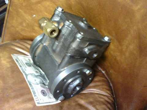

Completed cylinder and steam chest assembly. Steam into the steam chest 3/8 NPT on the side, with a port, 1/4 NPT on the cover, which might be used if a balanced valve is used.
I made drawings of this machine work if anyone needs them, let me know
- Cyl-assy-S.jpg (15.1 KiB) Viewed 11124 times

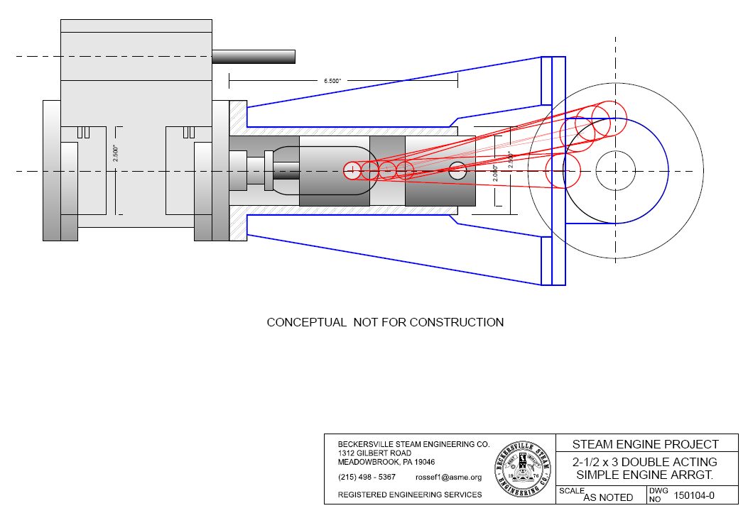

Preliminary planning, a Vertical Inverted Engine, fairly typical for most launch engines, except the baseplate will be mounted above the crank main bearings. Marshall-Bremme valve gear of course. Still in the conceptual stage. I have the crank and connecting rod from an IC engine. Overall height will be alittle less than 20 inches.
I plan to make the crosshead and support columns as a weldment (additive manufacturing is the "new" term for this), rather than a casting. With proper stress relief that assembly will work fine, and look like a casting. The rest of the engine will be fabricated similar to the methods used for the sidewheeler walking beam engine.
