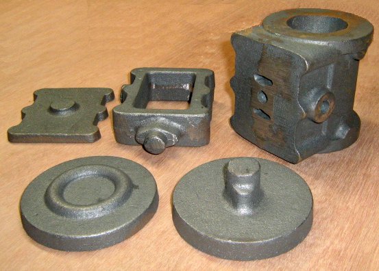

Bought the casting set from Rappahannock Boat Works to build a small auxiliary engine. The castings look good, and need to be machined.
I would appreciate any suggestions as to how the cylinder casting can be effectively clamped to the milling table. I am sure there are many ways to do this, and would appreciate the knowledge of someone who may have already worked on these castings.
The attached photo shows the casting resting on the milling table.

Re: 2-1/2 x 3 Simple Engine - Cylinder Castings Set
My inclination, looking at these castings and where there is extra material, would be as follows:
* clamp cylinder upright on the table (use tow clamps on the ridge at the ends) and finish one end of the cylinder.
* flip, clamp down as before but this time on suitable spacers, and finish the other end and bore the cylinder w/ a boring head.
* With a substantial through bolt, clamp cylinder horizontally to an angle plate aligned with Y travel, leveling surface as much as possible. If you have a real milling vice (Kurt or similar) that has enough throat, you can also use that. Finish steam chest mating surfaces and clean up ports.
I'd choose this order because there isn't a lot of extra protrusion of the cylinder end past the steam chest side, but that detail is worth preserving from an aesthetic point of view . There is obviously ample material in the bore, and cores shift sometimes, so trying to use that as the primary datum seems awkward.
You should also check the casting for obvious problems (ends of cylinder not parallel, for example) but this level of checking can be done w/ a T square, your right angle and a flat surface. If that is a dual horizontal/vertical mill, you can of course forgo the use of the angle plate.

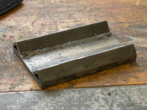

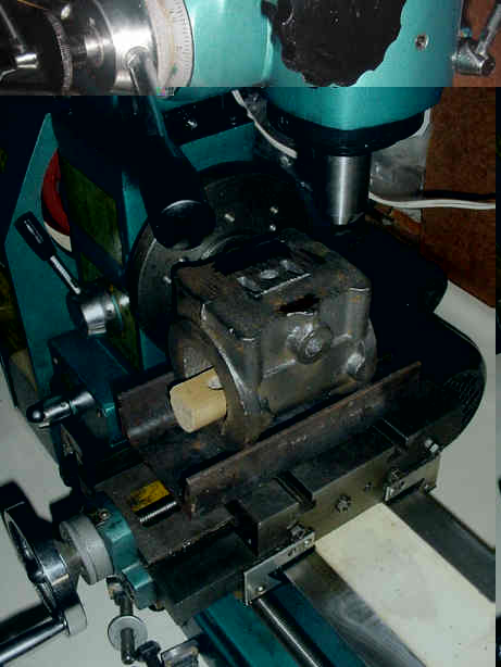

I have machined several similar cylinder castings and my method is to start with the largest flat surface, in this case the valve face. Then true the ends to that, and finally the bore. Having said that, one must be conscious of the restrictions placed by what machinery you have available. When I did my first set I didn't have a milling machine, only a shaper. That was over twenty five years ago and they are still going strong.
The piece of channel section shown would be fine if the sides were a little more rigid, though probably Ok if lighter cuts are taken. For holding down I would use a bar through the bore, clamped at both ends. The picture (if it loaded Ok) is of the jig I used for the last set. The two angles were set parallel at a suitable distance to keep the casting just off the base. If needs be, to level the casting, shims can be placed beneath the jig.
Beware, there may be a tough skin on the casting.
Thank you both for the advice. My milling machine only has 3 inch spindle travel, so I am going to bore the cylinder (4-1/2 bore length) and face the cylinder flanges in a lathe. The milling machine will only be used for the valve face surface, and for drilling/tapping operations.
The 4 inch channel shown in the picture is rigid enough for the milling work, and raises the casting about 1/4 inch above the channel in the center. I will set this up as Mike suggests, with shims as required.
Fred,
I haven't machined mine yet, but as Mike points out a bar through the bore to machine the valve face is the good way to go.
On the 3-in-1 not a lot of options for a large irregular piece like that. Using the C-channel, I would weld two vertical studs at each end on center of the channel web. Then run a bar through the bore. Then four holes drilled through the web of the channel to secure it with hex bolts to the T-slots on that spacing. Could use that fixture for other cylinder castings as well.
I will just go ahead and make a flange drilling template with a stub shaft to allow chucking the template in the lathe. This will allow turning the head flanges outside and face with it firmly bolted to the template. This will allow the drilling of the cylinder flange holes for tapping with relative ease.
I will also weld some anchor points to the 4 inch channel to properly anchor the casting to the milling table. Too bad my son has borrowed my good MIG machine, I guess I will be stick welding to make that fixture.
