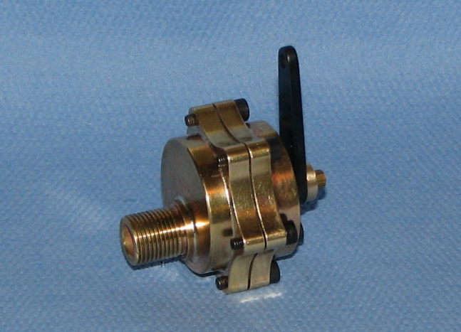

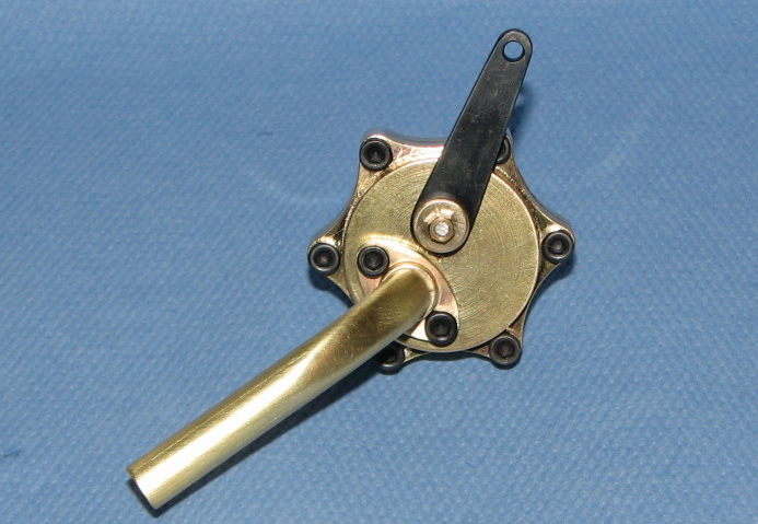

Hello,
i have built a special D-Slide-valve as blow-down-valve for one of my model-loco-boilers. It works well. You can buy it from different suppliers.
- AblV_ED03051klpubl.jpeg (71.28 KiB) Viewed 12767 times
- AblV_ED03048klpubl.jpeg (62.29 KiB) Viewed 12767 times

I use one of those blowdown valves on my locomotive too. They look just like the full sized prototype and work well.
