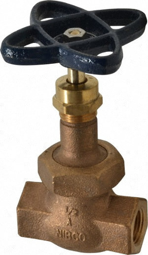

I use one of these 1/2" NPT Bronze Nibco globe valve - Class 300 (My mawp is 200psi) as my engine throttle. The inlet for the Toledo is 1/2" NPT.
I learned the value of having an main steam walve plus throttle again. The main steam walve is an Apollo 1/2" NPT 1/4 Turn Class 250 Bronze Ball Valve closest to the boiler.
I have twice now gotten into a condition that I am not happy about with the nibco...
I find that the steam hose has filled with condensate, and the nibco valve is sputtering and can't be turned properly and seems to be oozing water.
Luckily I had the isolation valve upstream, so I turned off the main steam walve - opened the engine petcocks and carefully took apart the valve and readjusted the position of the valve shaft which is a male thread inside of the valve steam and put it back together.
What I find is that the actual plunger of the globe valve has unscrewed from the end of the valve stem.
Why is this happening and what can be done to fix it? I don't like this happening - it left me dead in the water until it was repaired - 5 minutes. Plus I don't like messing with valves, even with an isolation up stream, when under steam.
Is this a job for a specific formalization of locktite/retaining compound?

Cyberbadger's original question hasn't been answered: why is the valve head unscrewing?
I don't know the answer, but when a globe valve stem has an external thread, and the head screws onto it, there is usually a locknut or the screwed stem has it's end rivetted over. It doesn't sound as though CB's valve has any locking mechanism, but is otherwise satisfactory and might be worth a little work to make it so.
Loctite might be an answer, but it would be working above its rated temperature, and might fail causing something like the original problem. Or might not. Given that the other valve exists in an emergency, it might be worth a try.
Otherwise what is the material of the valve head and what temperature will it take? Silver solder might be an answer. If that isn't possible, some locking mechanism is still required, so what about a 1/16th inch hole (or preferably slightly less) through the screwed parts of both stem and head, ends slightly countersunk, and a pin inserted with ends rivetted into the countersinks?

When we stipulate and pay more for "steam rated" accessories, it is the manufacturers responsibility to issue a working trouble free product, not a project. Should need no further engineering and should provide trouble free service under normal circumstances. He said he has had the same issue with two different Nibco valves - becoming inoperable in service requiring dismantling and repair. That is unacceptable and he should try to return them for a refund, or at the very least avoid that brand of valve and go with something proven reliable. His question was really answered, replace them.

Since no one here seemed to be answering my actual question I tried the smokstak because these are the same kind of valves the traction engine folks use.
Some one suggested I maybe be tightening down too much hot vs cold. I'm going to try to monitor myself next time I'm out.
Pete Labelle:
"Maybe its a function of how hard you are tightening up the valve to close it, or seating it while hot, then trying to loosen it when cold, resulting in more turning force on the contact point in the valve. "
