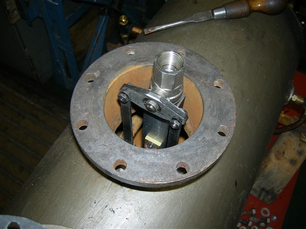

We've been using ball valves for regulators on locos for donkeys years. They are reliable and don't open/close too quickly, unless you want them to. Since I fitted the first one I wouldn't consider anything else (as long as there's room for one)
Regulator (600 x 450).jpg (63.02 KiB) Viewed 12794 times
