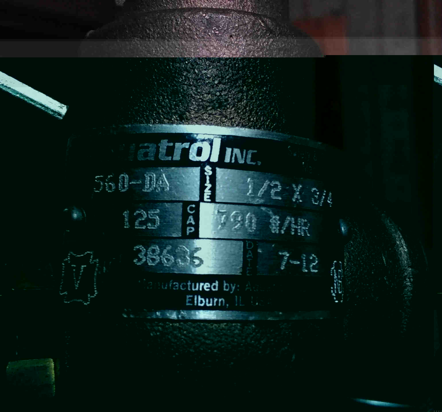

Attached is an image of the safey valve I have. I also have available - but it's not set for anything right now an adjustable single spring ATAM 15mm relief valve.
- aquatrol.jpg (119.15 KiB) Viewed 13306 times
Re: What are the concerns/safety of an unfired >100C vessel
That safety valve is somewhat small for the 1/2 inch ID connection, I would use 1/4 inch ID connection.
