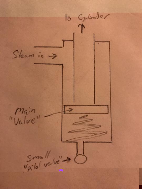

Back to the original questions from Tom: "Would it be possible to actuate the opening and closing of valves directly by using steam?"
ANS: Yes,is possible, some USA automobile manufacturers (and others) have dabbled in it.
"Essentially, I'm thinking of a situation where a small amount of steam could be admitted to a small cylinder via a small solenoid. This steam would then force itself against the piston, which is attached to the main valvegear (presumably poppet), thereby opening the valve against the pressure of the steam and admitting steam into the much larger main engine cylinder. It seems like this would be a good way to electronically control an engine while at the same time allowing very fast valve actuation, without the issues inherent in using much larger solenoids to control the admission directly."
ANS: That is a common application for many "Pilot operated" control valves, using fluid power, controlled from some small energy source, to produce bigger motion in a larger valve, nothing new there. High speed response, long life are solvable problems, but low cost and low complexity would suffer in the realms you are considering.
I work with quite a few of these (mostly made by hansen). A 12v sel. pulling less than an amp opening 3" valves , but that equates to pretty slow response. There are two types however, vent pressure in to open a larger valve, or the less commonly used ones have a small spring holding the main valve shut, a small orrifice to a balance chamber, and the sel. Vents the balance chamber. The second on is the direction I would look.

Back on topic, here is a sketch of a very simply set up. Leak by around the main valve pressurizes the spring side helping it seal. When pilot valve opens the pressure on back side of the main valve decreases, spring is compressed, main valve opens. Pilot valve closes, pressure equalizes and spring closes main valve. Very fast acting, requires very little in the way of pilot valve, simple
