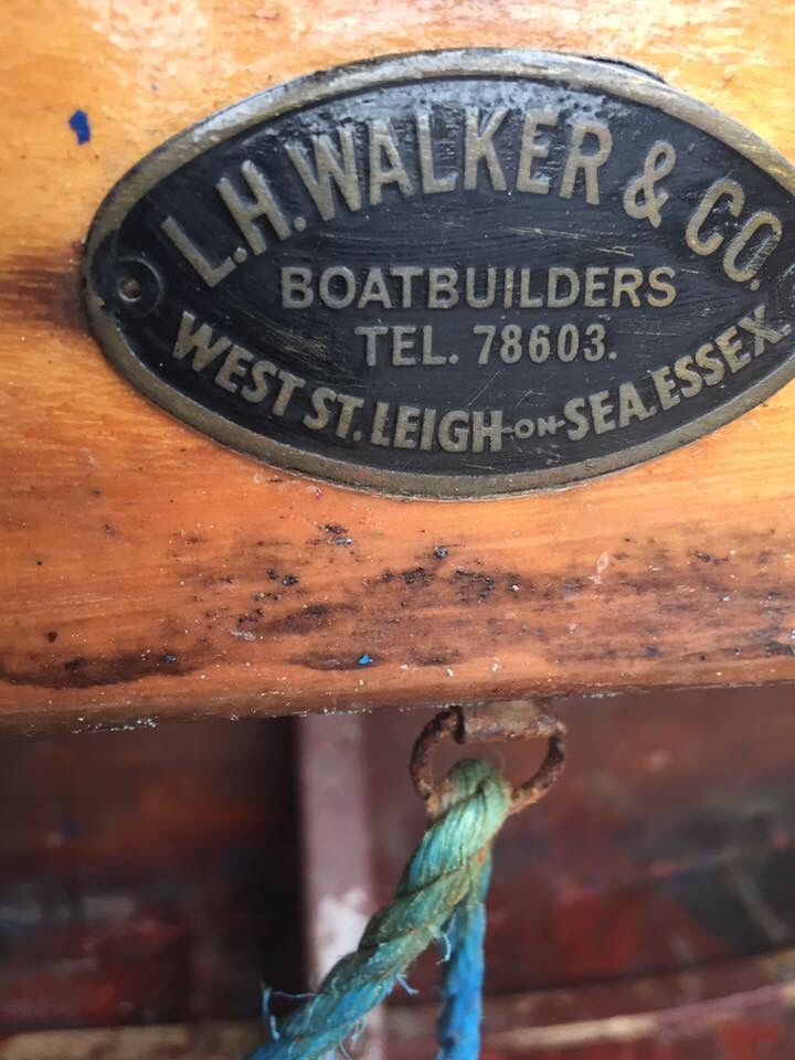

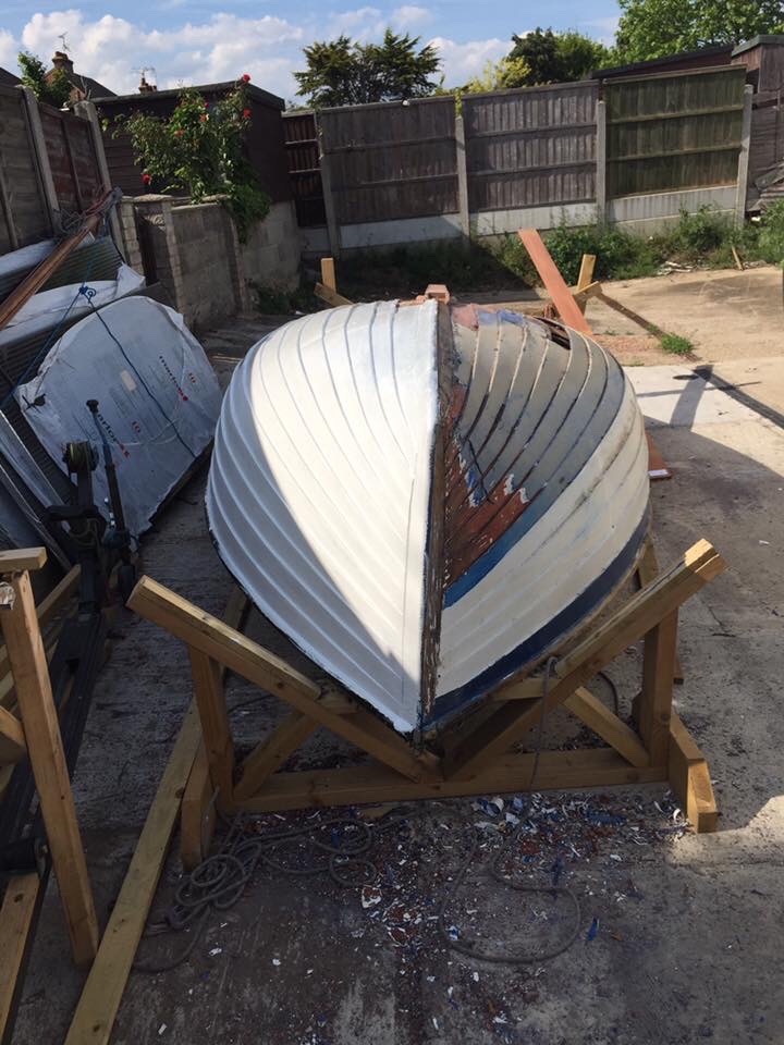

I've done some research and discovered that my boat was built in 1963 a year before I was born
It was constructed by LH walker in Leigh on sea , that's 5 minutes up the road from Southend on sea were I live !
Mr walker was a very well known boat builder, I hope he's not too pissed off with what I'm doing with his boat after all it's going back in the water instead of being broken up, it has been left laying on its port side at sometime in its life and that's caused it to rot away, but fear not I'm going to save it and use it again, it's 56 years old so I might get a vintage boat discount when buying a day licence for the canals! Every cloud lol

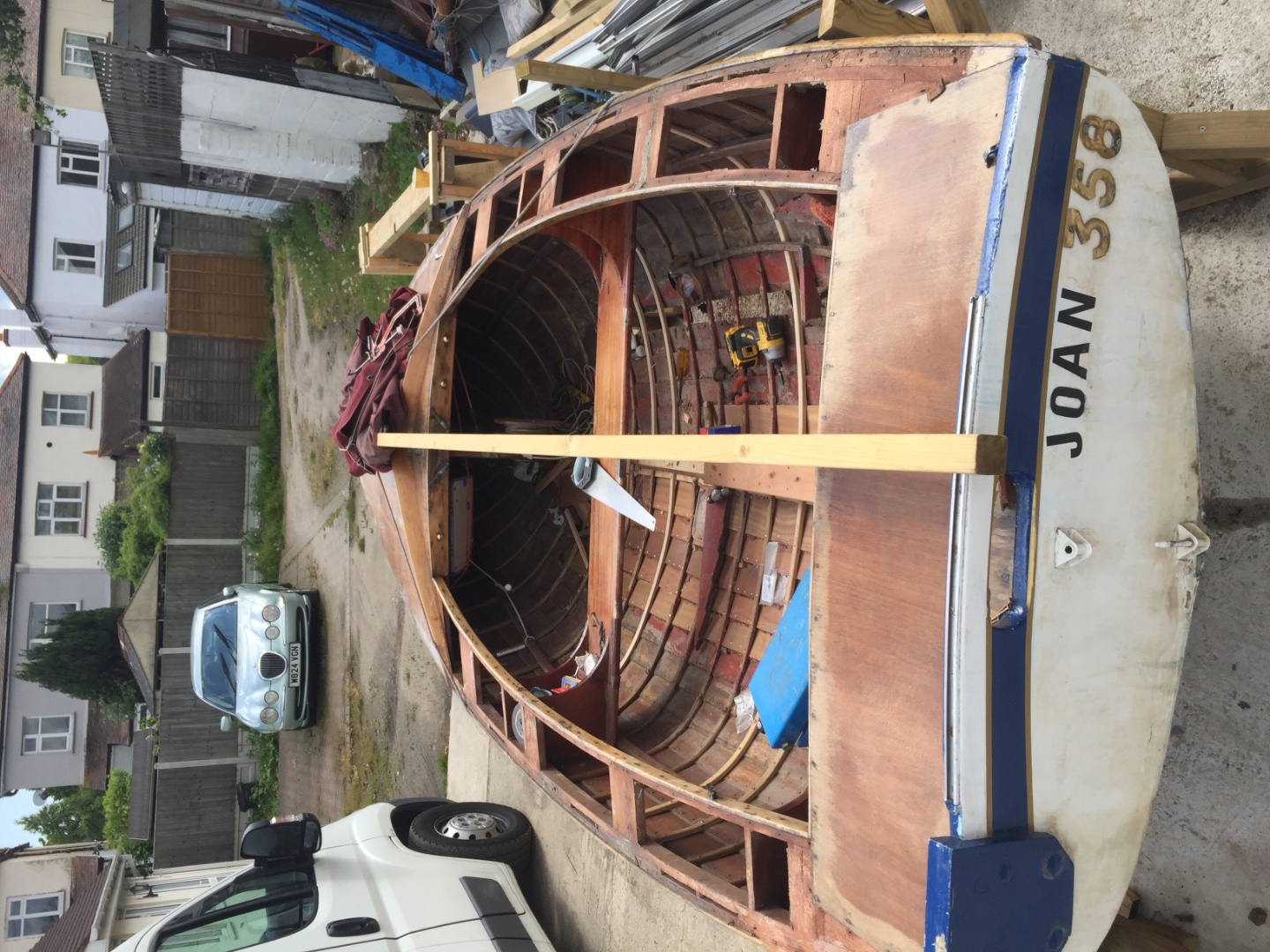

thankyou for replying, that's great news for me, now I can carry on with the shaft installation,
Pictures to follow

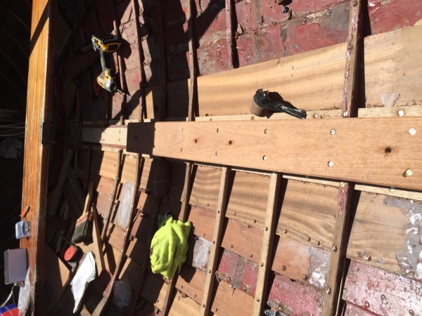

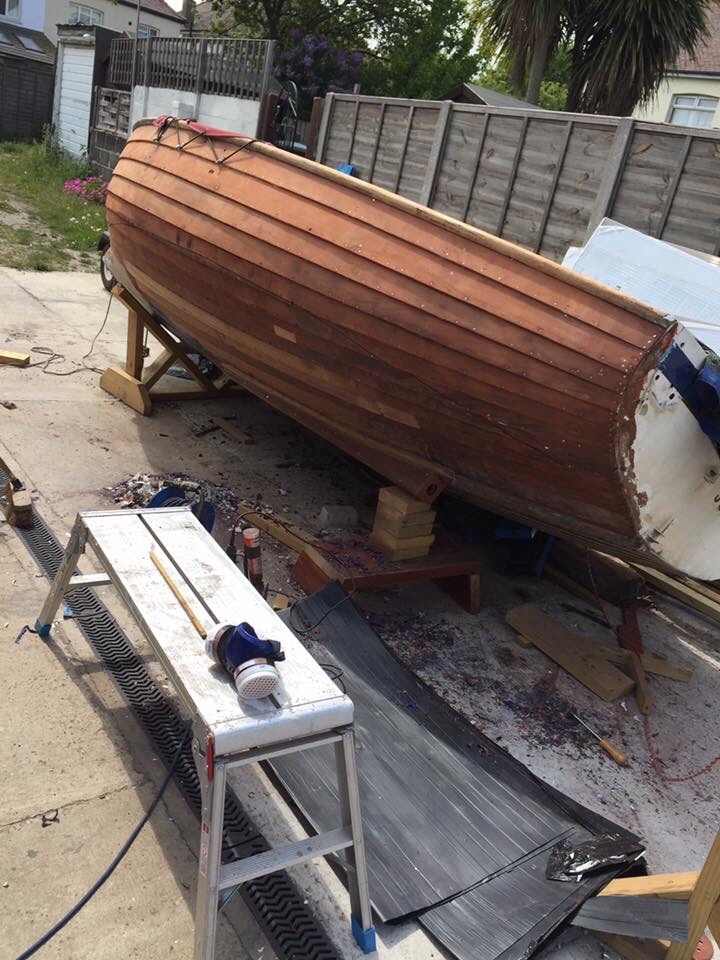

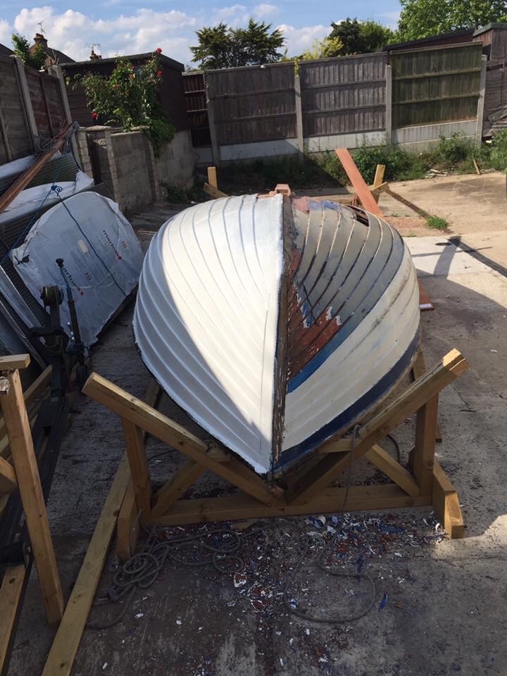

Got the last bit of the keel done today
now for some ribs

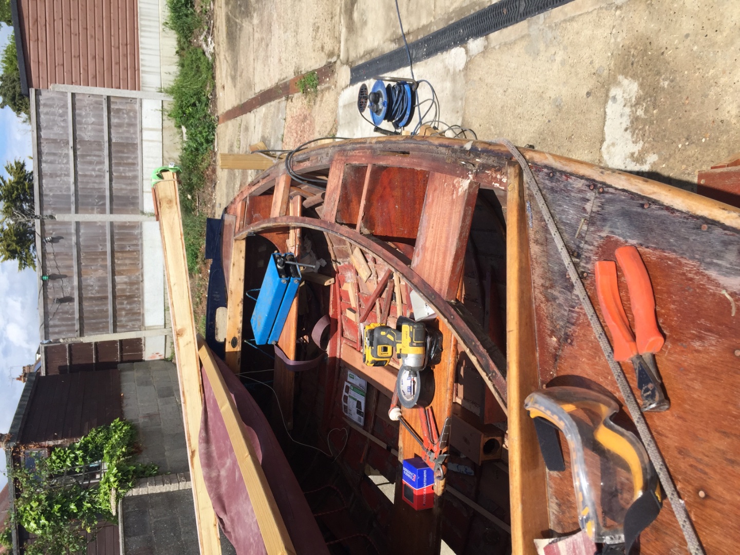

time to remove the sailboat seating on the sides and make some more room inside

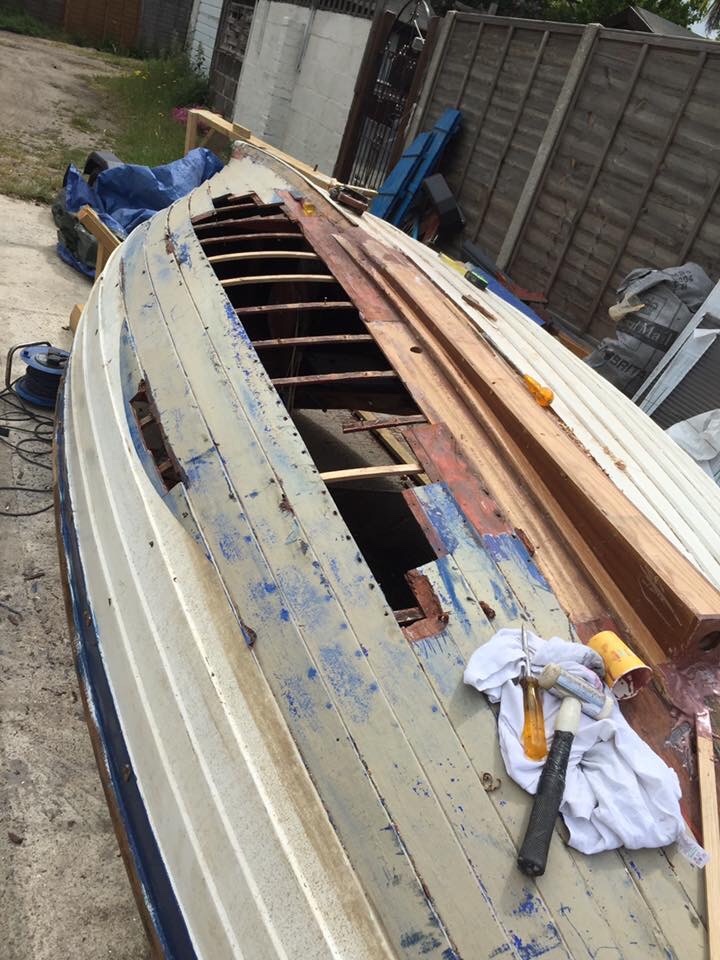

Post by Colin chandler »

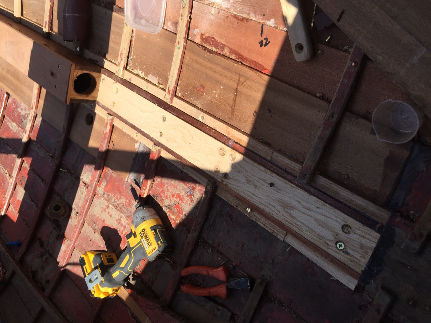

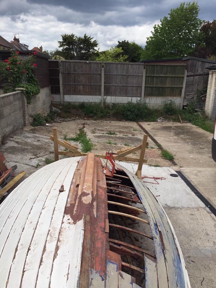

Tops are off and now it's time to remove the framework and make some more space for seats inside

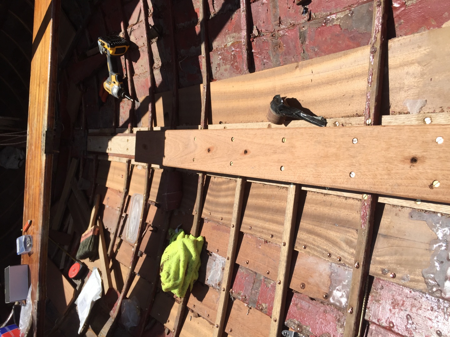

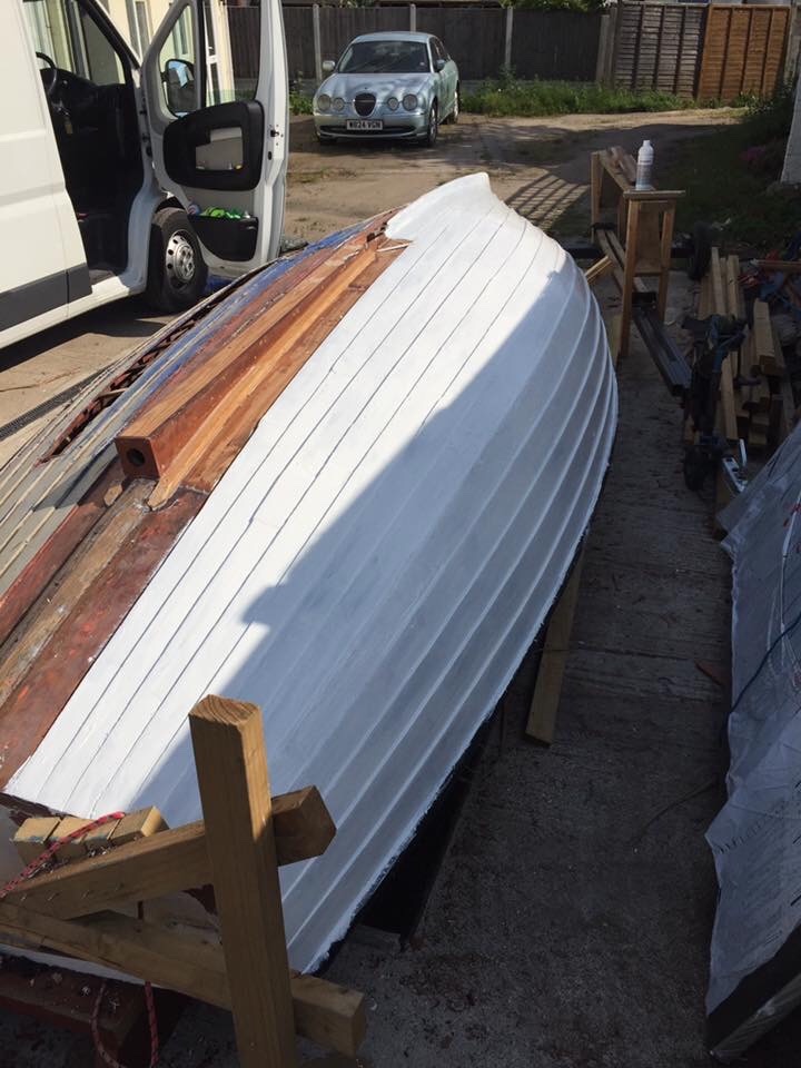

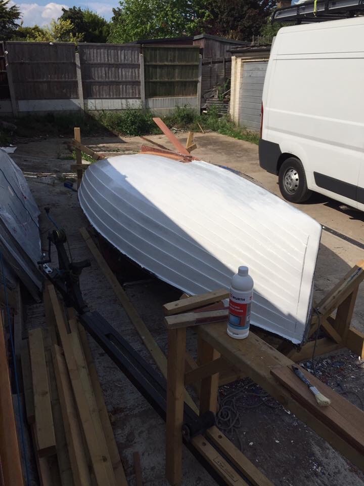

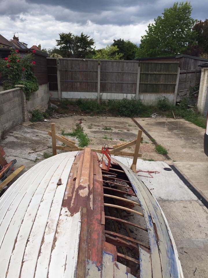

some pics of the boat one side done now it's time for the other lol

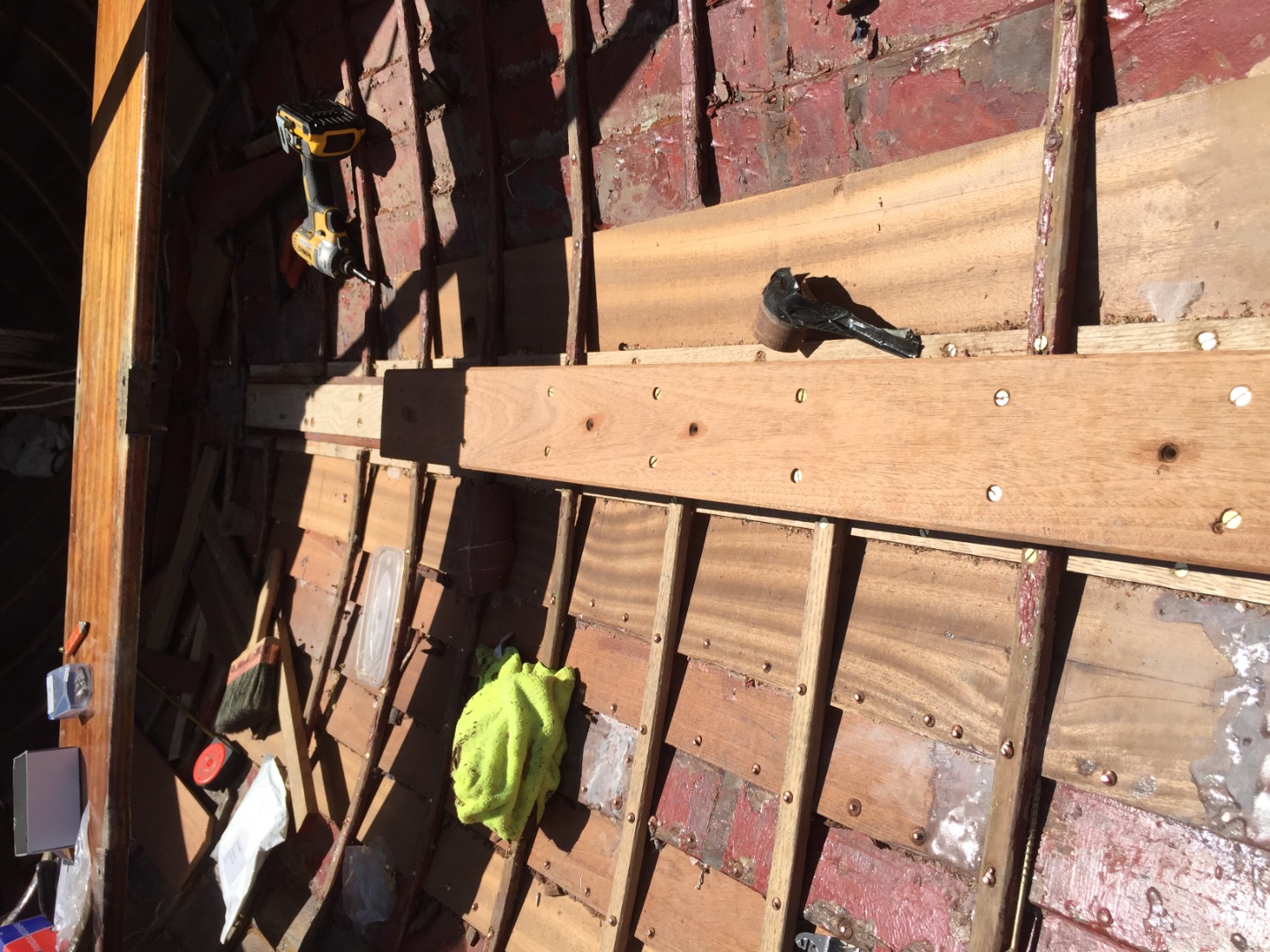

Getting on to the other side now, looks a bit daunting but one step at a time
