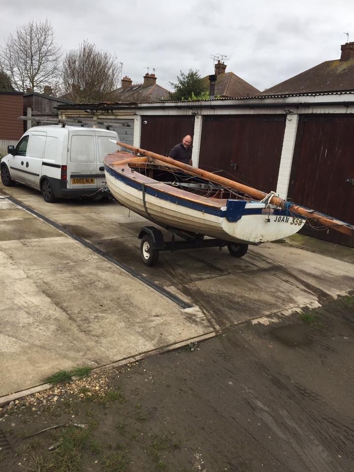

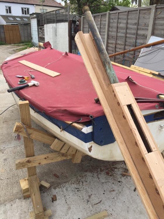

This is a project to turn a rather rotten day boat into a steam boat, there's no big 30k budget so I'm hoping to get a steamboat for a working mans budget,
So far the trailer has cost £120 on eBay I had to dismantle it and put it on the roof of my van because I didn't have a tow bar,
The van in the picture is my mate Dave who helped me for the day
The boat was found locally on Facebook and cost me. £150
So I'm all in for £270 so far, there's some rot so it's time to get on utube because I don't know anything about boats !

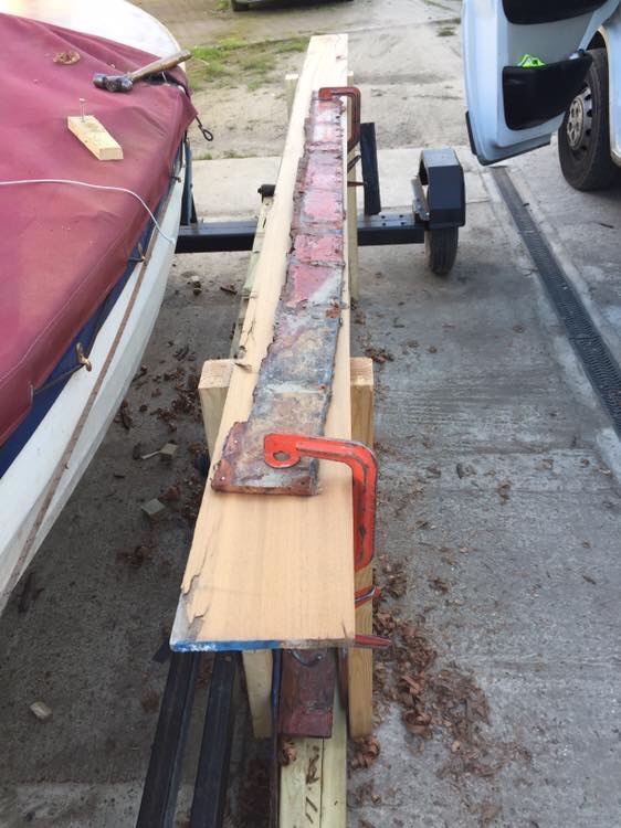

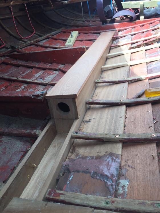

Here we go let's get the first one out, looks like the nightmare has begun, lol,
The copper nails are easily cut through with my oscillating multi tool and so is the plank so it just slides out

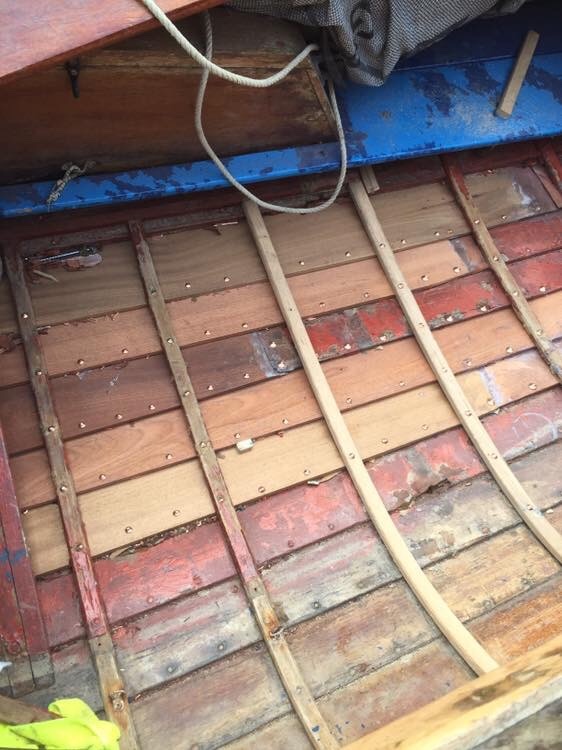

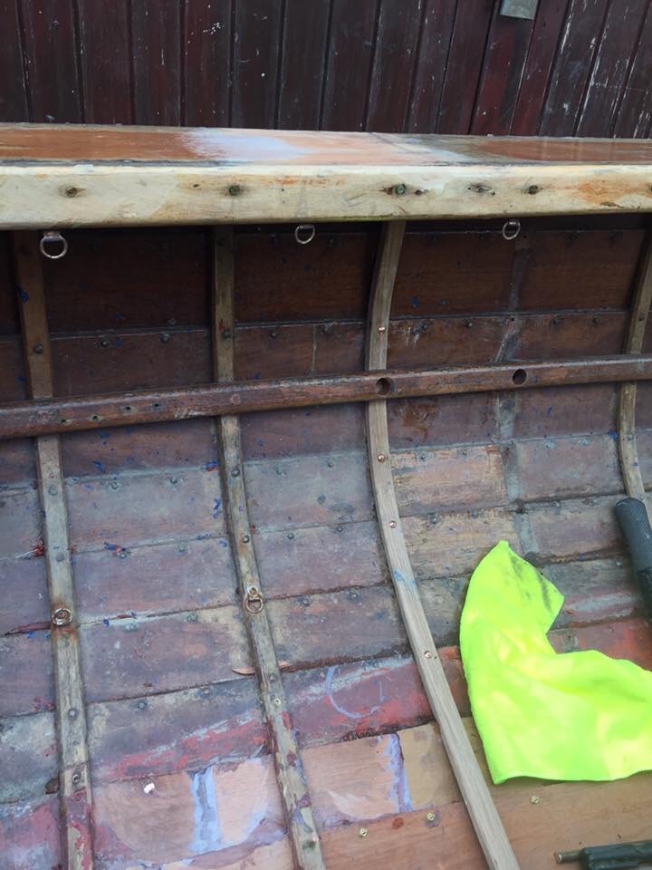

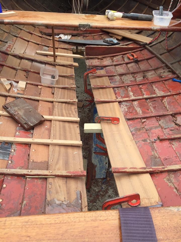

Once you've done one the rest get a bit easier, I've got a bit better at doing the nails and roves and I've actually steamed a couple of new ribs in place
The attachment IMG_0839.JPG[/attachmentattachment=0]IMG_0840.JPG is no longer available

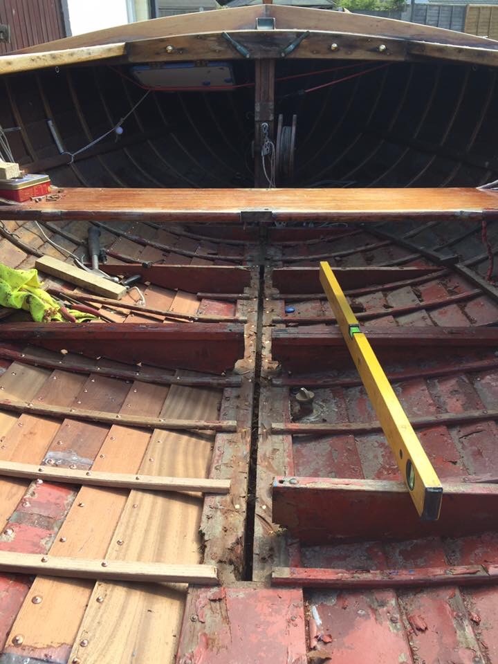

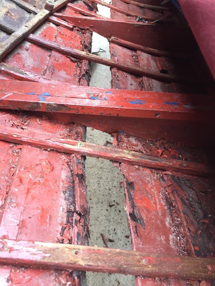

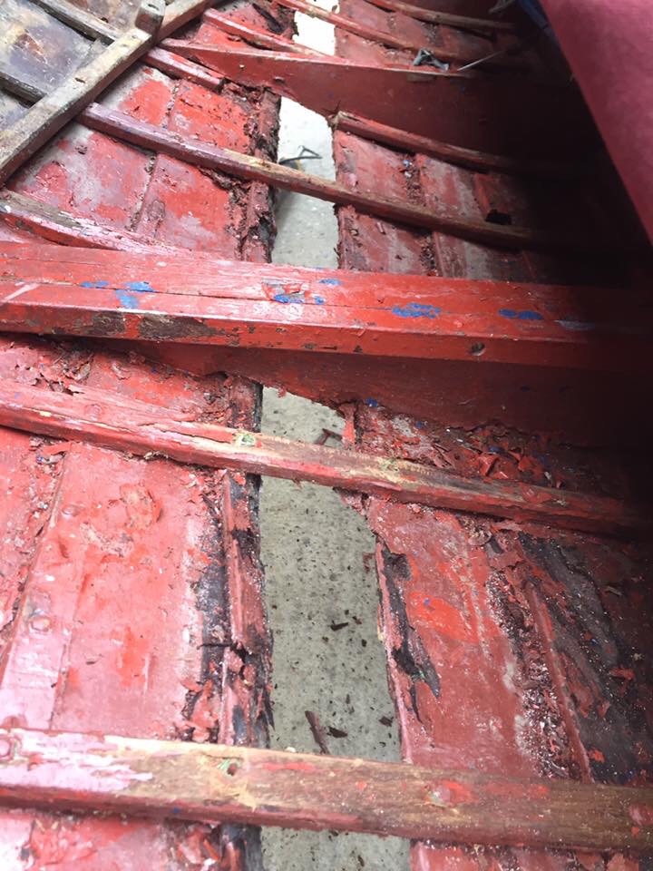

The keel is being removed, it's pretty rotten and it's got a big gap in it for the drop down dayboat keel so it's coming out

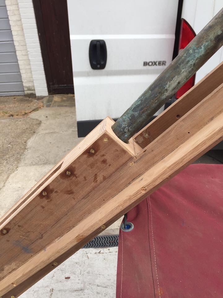

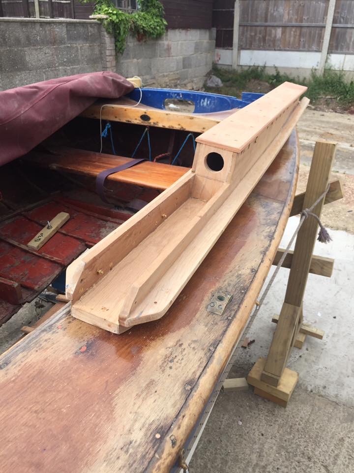

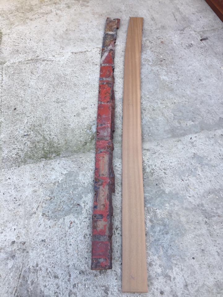

This is the new prototype keel
