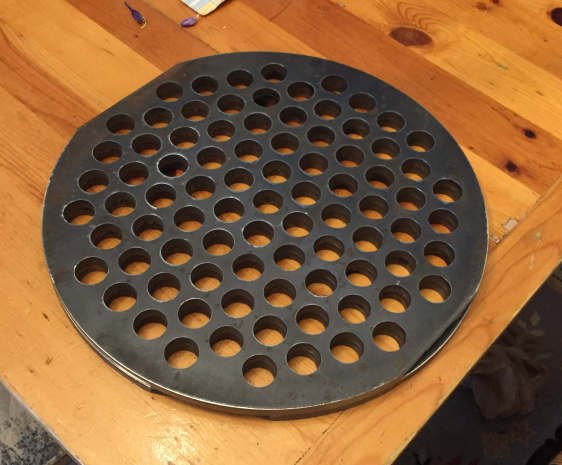

Yesterday I picked up new tubesheets for a 16 inch diameter vertical firetube boiler. 85 firetubes, one inch nominal diameter.
I supplied the boiler plate, 3/8" thick A516GR70 steel, which I have material certifications for, which complies with the ASME Boiler Code as far as allowable material here. The steel cost about $30US.
The tubesheets were cut using a CNC plasma cutter, and the commercial shop where the sheets were made had to convert my PDF drawing of the tubesheet into proper CNC cutting code, a task that took them far longer than machine setup and cutting. Then they made the two tubesheets, all for the total price of $58US.
I had them make the holes about 0.040" (1mm) smaller than the tubes, so I will ream out the holes for a close fit to the tube diameter. That operation can be done very fast as there is very little material to remove. Then I must grind a bevel on the outside for a full penetration weld on the 16 inch boiler shell, and countersink a chamfer on the tube holes to allow seal welding after the tubes are rolled in place.

Looks good!
I really like the modern CNC cutting capabilities: Water jet, laser, plasma.
And I hope you will perform the tube hole reaming after the sheet is welded to the main boiler tube?
Otherwise hole deformations might occur?
