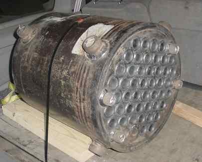

The original pressure vessel shell for the Margaret S. Boiler, a simple Vertical Firetube (VFT) made in 2010. 16 inch OD x 18 inch high, 48 tubes, 1-1/4 OD x 0.095 wall. 20 square feet heating surface, 60-80 pph steam output.
This boiler was designed and fabricated to the American Society of Mechanical Engineers (ASME) Boiler Code, and could probably be modified to suit British, and EU requirements, while still complying with ASME. Who among us has technical knowledge about British and EU boiler design requirements?

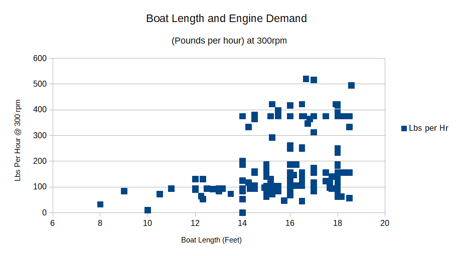

As an exercise I have downloaded a chunk of data from the old SBA Steamboat Register (the up to date register does not allow a search by length of boat strangely) for boats of 18ft and less. Using that data I have worked out the steam consumption in lbs/hr (E & OE!) for all their installed engines. My first impression is that a lot of the boats are over engined, but see what you think. My intention was to get a feel for the typical smaller boat engine but this has not really achieved that goal. More work required I expect.

It seems that the SBA boiler design library does have a firetube design for an 18" diameter X 24" high pressure vessel that was drawn up by David Beale. I have been passed a couple of pictures for Fred (coming to you later tonight or tomorrow Fred). There is positive interest which is encouraging.
