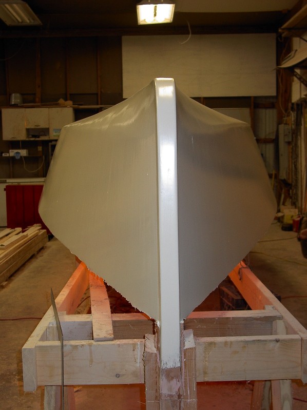

A warmer day Saturday, so another coat of epoxy base ...
- Epoxy Base Coat (2).JPG (92.18 KiB) Viewed 37820 times

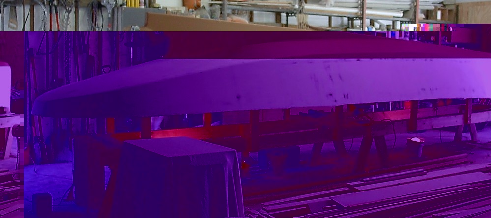

Bottom paint is on. I'm still fooling with the topsides prior to painting.
- Bottom Paint (Resize).jpg (118.55 KiB) Viewed 37773 times
