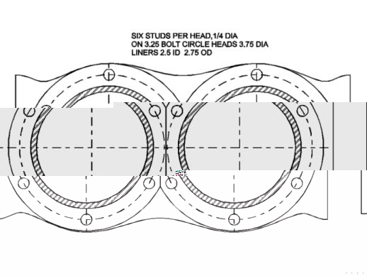

If the cylinder heads are to be full circle they can each only be 3.3 inches diameter. Often the cylinder heads on twins have a section cut flat where the heads meet between the two cylinder bores,to get more flange area all around. I assume you are going to have that arrangement, so what is the turned diameter of your heads?
The attached sketch may be close?

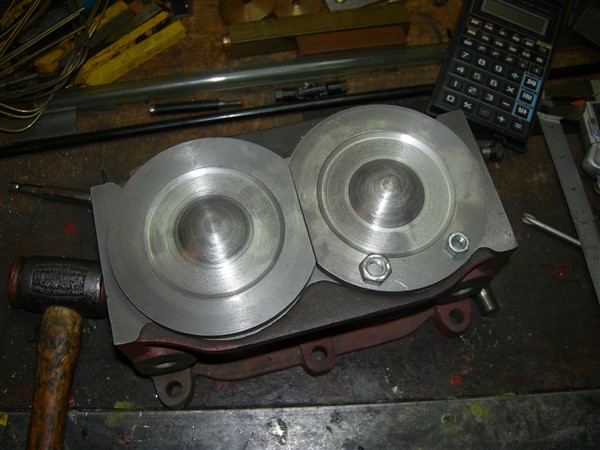

Fred, that's exactly it, the heads intersect, and why my wondering if one shared bolt at the join would work better or just as well as the arrangement you draw. An East/West axis, rather than your North/South. I'm thinking the two pairs between the cylinders will be very close together and may 'spanner' foul. I need to get the heads finished (today, maybe) and fitting together.
The heads are currently 3.85" -ish O.D. so don't quite reach the edge of the adjacent bore.

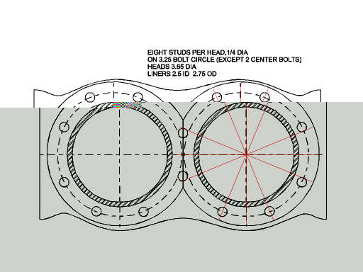

If you put two bolts on the line where the two heads meet, then an 8 hole pattern could work well, and allow cylinder drain cocks at 90 degrees from the cylinders axis. That would reduce the distance between bolts on the valve port end, and you want to avoid restricting the steam port with bolting that pierces the port passage, although that is not necessarily a show stopper.
The sketch attached shows this arrangement, along with 22-1/2 degree red lines that would represent even spacing for 8 place bolt circle. Some deviation from the true bolt circle, as well as the angular position of bolt holes is compromised somewhat, but still acceptable geometry.

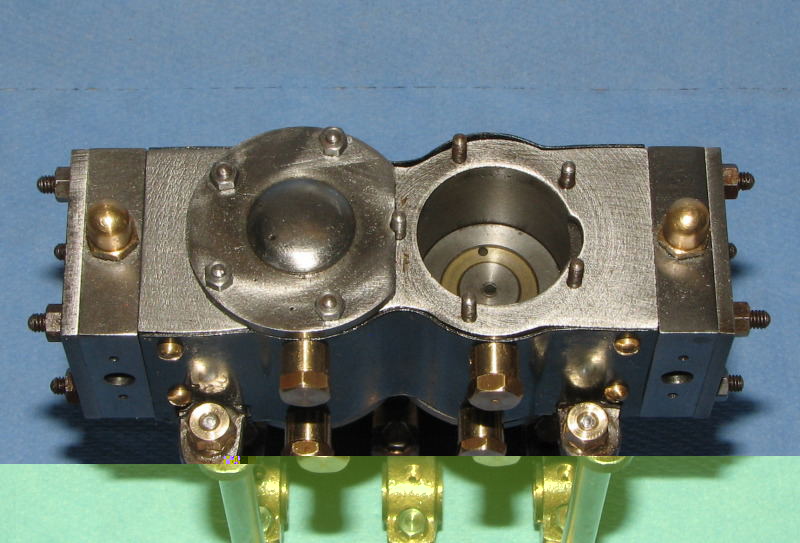

Hi Mike,
what do you think about a 5- or 7-bolt design like this. It is from my STUART Launch Twin-Steam engine. So you can also set the drain cocks into the standard /original position.
Cheers Dietrich

Hi Dietrich, the DRO doesn't care how many you want, just enter the number, it works out to co-ords.dampfspieler wrote:Hi Mike,
Cheers Dietrich
The only minor concern with the East/West positions would be that one stud(?) is directly over the port, but I've checked the casting thickness there and it will manage fine without breaking through. The drain cocks are then completely clear (11 stud).
Also the stud on the joint line will still be on the PCD (slightly adjusted).
Both covers are now ready for their flats.

Yes, that takes those two off the P.C.D, though not really a problem, just a case of resetting the DRO, or drilling them independantly.fredrosse wrote:Second post of mine on 27Feb, 14 studs on two heads.
Stud stress is 3700 PSI at 150 PSIG Cylinder pressure, well within limits for 1/4 inch studs.
I was thinking of using all Metric threads, Imperial stuff here is still available, but Metric is so much less hassle, even available over the counter very locally. M6 is where I was, M8 being a bit heavy looking.
Edit :- Covers now completed to drilling stage.
I laid the nuts M6 and M8 on for size impressions, I'm now not sure that M8 is too big, it certainly fills the land well.
