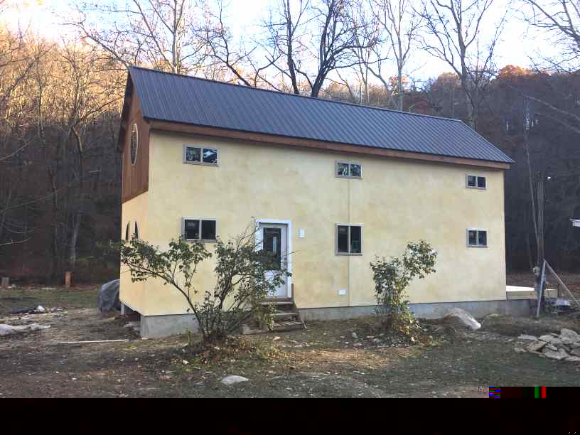

Engine cylinder assembly is still sitting on the workbench, I need to get a special part that seems to be impossible at present. Anyone know whereI can get a "round tuit"?
I have been building a house for my daughter, with money from overtime on my day job, very taxing for this old man, who turned 70 a few weeks ago. My son is helping, along with a kind friend sometimes. We now have the building tight to the weather, so progress can now proceed at a more leisurely pace, but I still have to do the drain piping, hot & cold water piping, the electric wiring, heating system, then insulation and sheetrock, fixtures, etc.

I can definitely understand the hold up. That's quite commendable of you to build it for her out of your pocket and time. Looks good and energy efficient.

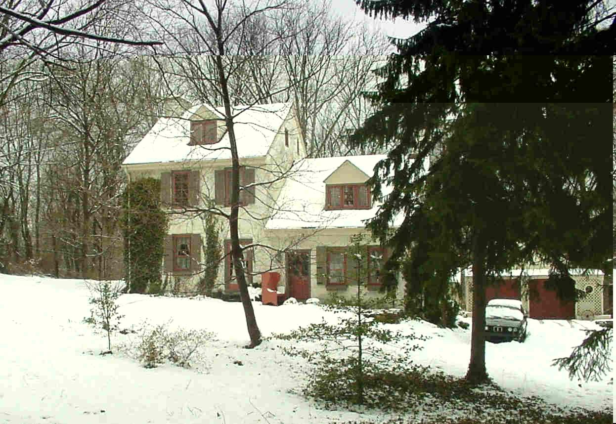

RGSP, from England, where wonderful houses several hundred years old are to be found, nice to see your lovely house.
In America, the oldest houses are much younger, and ours is one of the earliest, built 1692, very old for the USA. The right side of the house was built way back then, with a large addition on the left built in 1838. It was going to be torn down, Katharine and I got it for the price of the lot, and it has kept us busy in restoration for nearly 20 years now.
