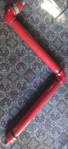

150MAWP Fireless Pressure Vessel
There is a quarter on the right elbow for a sense of scale.
It can be folded side by side using two elbows - but then the drain and steam space isn't as ideal.

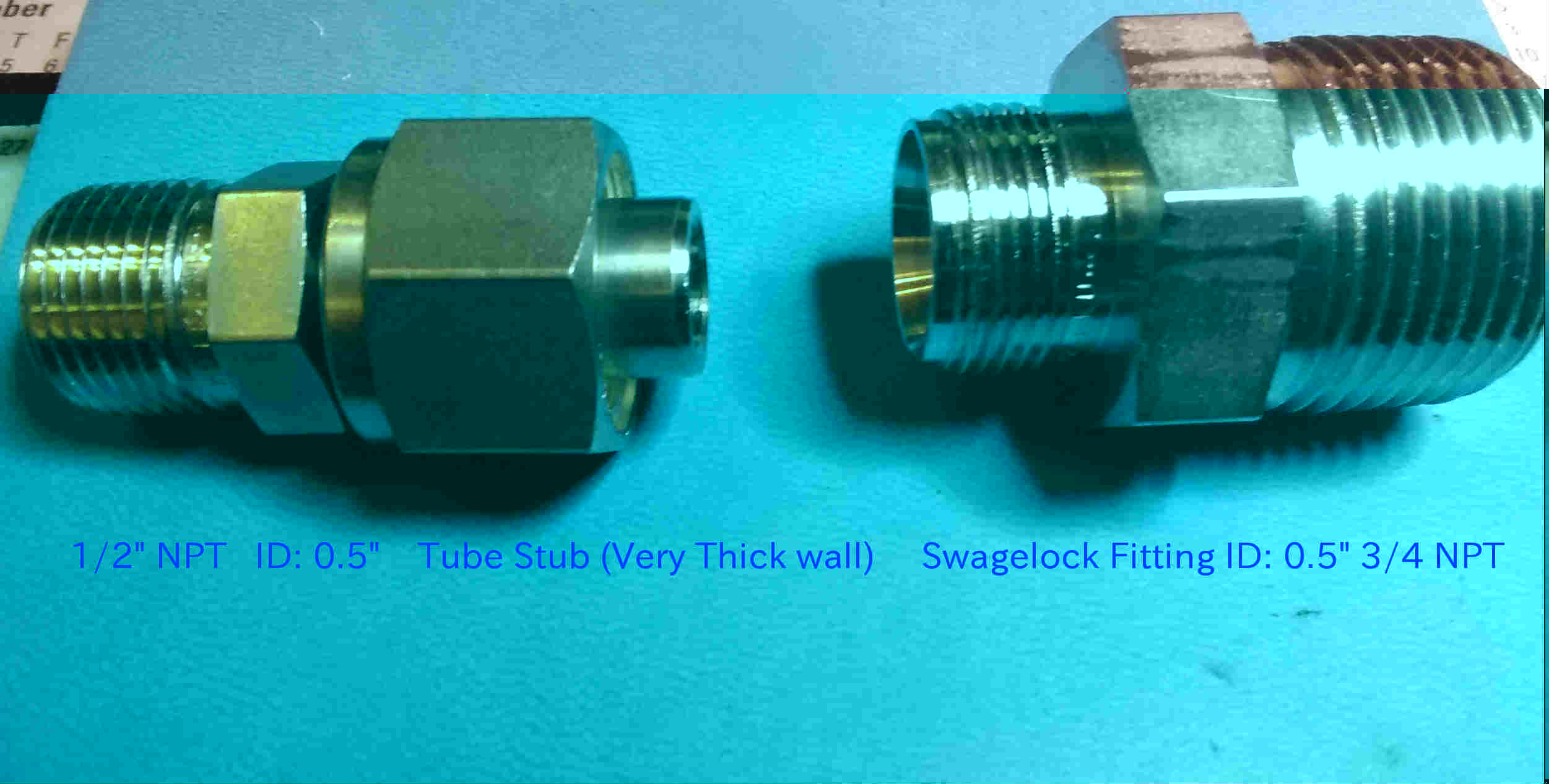

Well, I should be getting some swagelok to try...
Re: What are the concerns/safety of an unfired >100C vessel
And the swagelock fitting.
So I am going to start putting this together, then a hydro.

Any ideas about the sizing you were talking about?
I could put either the ASME 125set Aquatrol or (not following the code exactly) the single spring ATAM relief valve could be set to 150psi.
