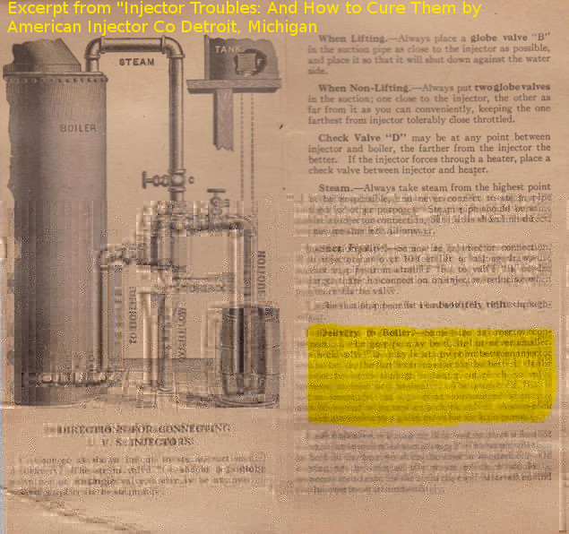

Sort of answering my own question...
an Excerpt from "Injector Troubles: And How to Cure Them"
by American Injector Co Detroit Michigan
Deliver to Boiler. - Same size as injector connection. Large pipe may be used, but never smaller. Check valve "D" may be at any point between injector and boiler, the further from the injector the better. If the injector forces through a heater, place check valve between injector and heater. The stop-cock "E" is not necessary, but is a great conveinance when you wish to regrind or replace a check valve. A stop-cock is much preferable to a globe valve for such purposes."
an Excerpt from &quot;Injector Troubles: And How to Cure Them&quot;<br />by American Injector Co Detroit Michigan
Re: Pros/Cons Piston Valve and Balanced Slide Valve
