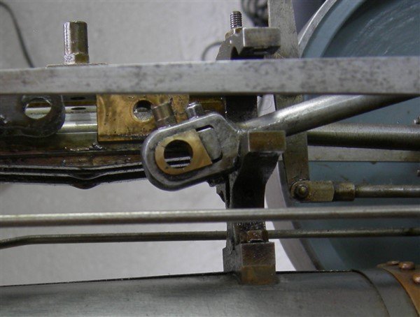

The first time I ran this engine I detected a clunk from the crank, on checking I found the flywheel loose, I tapped the taper key home and thought that's that.
I ran it again having messed with a few other bits and there was still a clunk. Not the flywheel. When cold again I found a bit of clearance in both small ends. I carefully stripped the slide bars off this morning, and then removed the outside slide and pin and this is what I found.
DSCN7515 R (600 x 454).jpg (48.29 KiB) Viewed 15867 times
Whoever built this thing did a fantastic job, the only thing here is that the bearing halves appear to be butting so will need to be trimmed. That gudgeon pin is only 5/16" dia so you can see how small all this is.

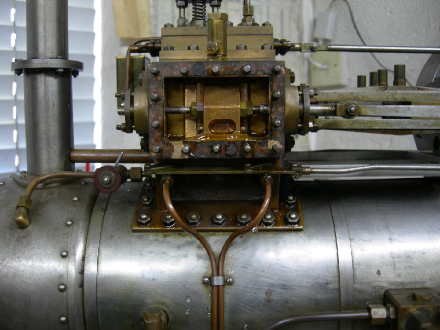

Talking of the little twin, today, under full lock-down conditions, that thing the executed the feline took hold, and I removed one of the valve-chest covers. This is what I found.
IT is a lovely piece of work throughout, worthy of a museum model.

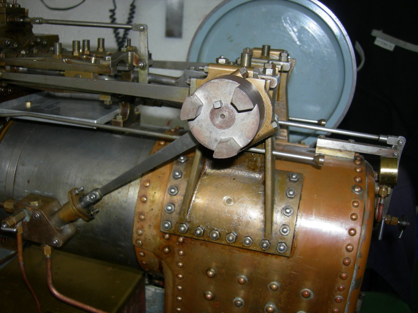

I also, having to hand a Lovejoy coupling, bored and keyed it to the crank.
I'm not sure how far this is going to go but, 'tis fun none the less!
