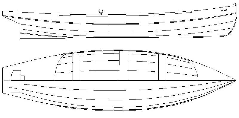

I have found this rather nice design:
Fairlight 13 Canoe.jpg (49.74 KiB) Viewed 104028 times
This is the Fairlight 13 sailing canoe which the vendors say has been developed to meet a family need for a paddling, rowing, motoring and sailing car top boat. The first thing that struck me was that it looked like a nice little steam launch, but obviously of diminutive dimensions. Could this become a two person car top steam launch?
I look forward to your suggestions on how that might be achieved.

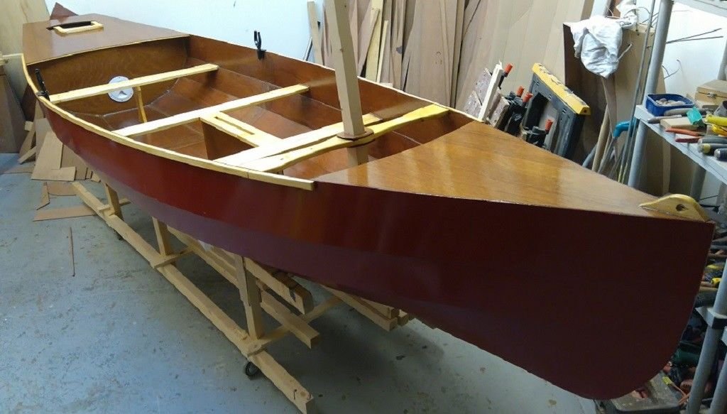

Here is a photo of the boat:

Re: Antidote to Caabin Fever?
Appreciating that it has been built down to a weight, steam equipment is heavy, so it may not be suitable for 'car top' unless such plant is easily removable? I believe some steam canoes already do this, so perhaps not too great a problem. It is rather attractive, but I see a couple of places where I think it could be improved a little for little or no extra weight.

Re: Antidote to Cabin Fever?
Hi Mike and friends
Yes, I agree that the steam plant is heavy, but it has been done successfully before. Looking at Taniwha built by Mike Robinson (SBA) [https://www.steamboatassociation.co.uk/page-1117882} he reports a boiler set up of 12kg. That is about the weight of a light bicycle. Unfortunately he does not report the weight of the engine.
My understanding is that the plant removes as two bits to put in the car while the canoe can be lifted up onto a roof rack. I am sure I have spotted a video of Mike doing that (on the SBA website I suspect).
What would our engineering folk suggest as a suitable achievable weight? The Fairlight 13 is a two person canoe, so perhaps the weight of a person - 120 - 140lbs, 54kg - 63kg. The trouble with that figure is that it implies making the boat a single person boat. Perhaps one could use Mike's achieved boiler weight of 12kg and make an allowance of the same for the engine and plumbing. Is that realistic? I would assume that the plant would use filtered lake feed and not bother with the weight of a condenser, or would a condenser be worthwhile?
So what do you feel needs to be done to the boat?

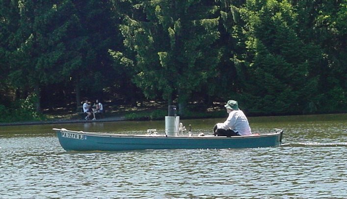

I made a car-top steamer several years ago, able to be setup with only one person. The boat was a 15 foot Coleman plastic square stern canoe, which fit on the roof rack of an automobile, no more than 50 pounds to be lifted by the person at any time during unloading, setup and launching. The steam plant was mounted on a 2 ft x 4 ft plywood base, which had a total weight of less than 100 pounds, but the unloading/installation in the hull required only 50 pounds lifting by the operator.
Complete description here:
https://steamboating.de/steamboat/steam ... propulsion
Car Top Steamer
Nominal 150 PSI steam, 600 RPM, 4.7 CID single acting engine, about 1/4 horsepower.
Flash Boiler, 5 square feet surface area, from 1/4 inch OD tubing. Propane fired
I suppose, as usual, the place to start is to determine what output would be required to push it along a reasonable pace. Then find a suitable engine and work out the boiler heating area etc..
Of the hull, I would I think prefer to see a little camber on the foredeck, and perhaps fatten the gunbels a little, but minor visual enhancements.
