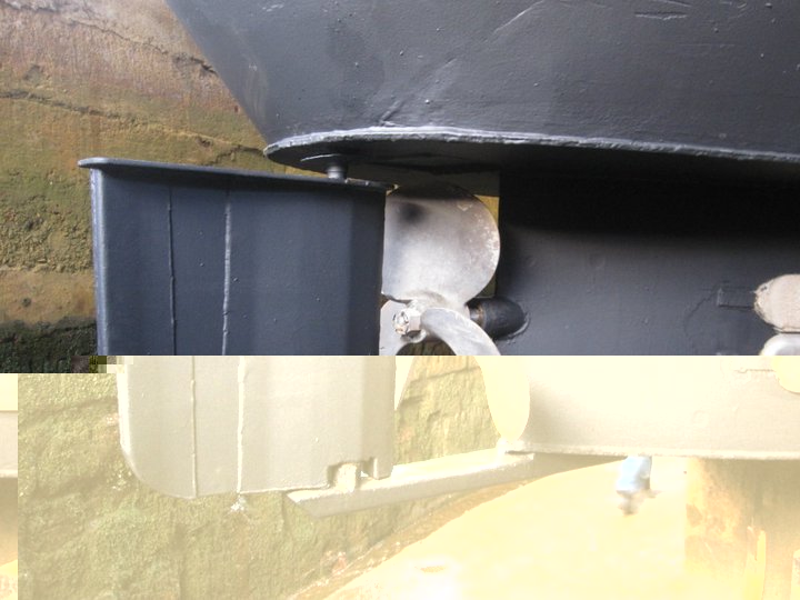

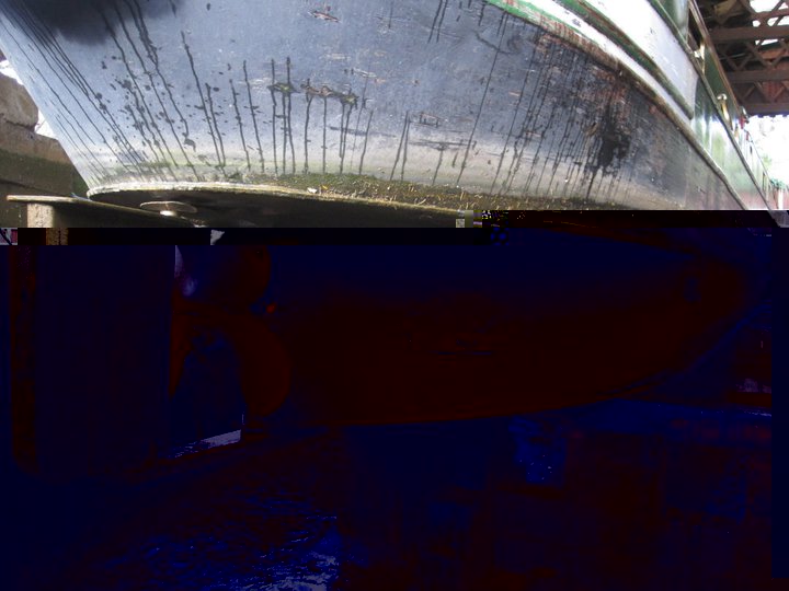

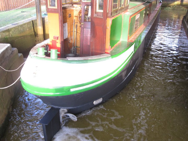

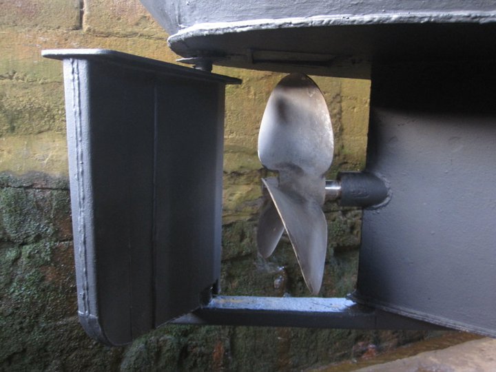

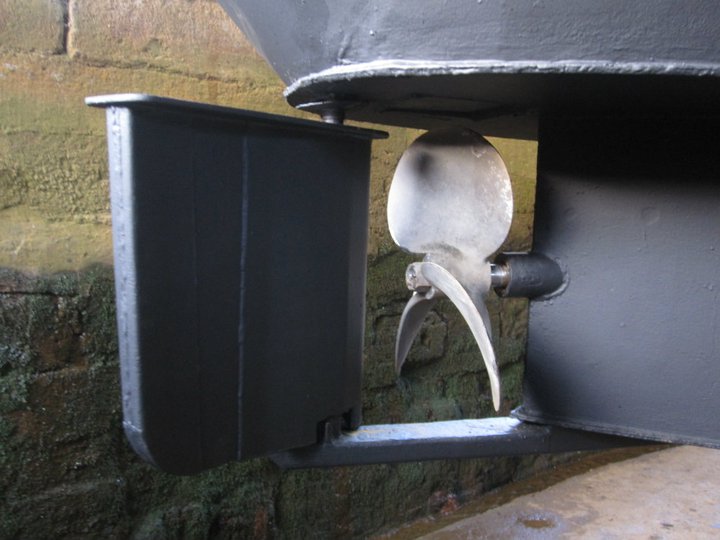

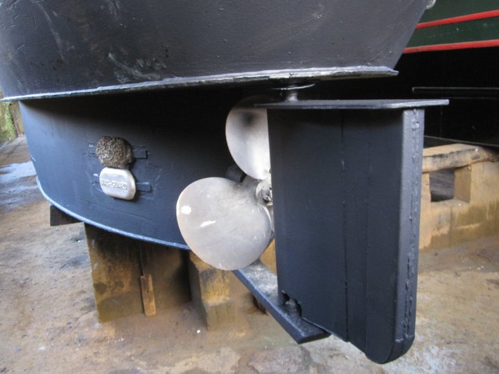

I will bluntly say, I have yet to read this thread top-to-bottom, however as there has been a few threads on my own forum about fitting such devices to narrowboats on the uk canals I thought I would share a link to one of the main threads on it, below.
We dont have on our boat to the complexity of retro-fitting one and because in my mind, they are not well suited to shallow canal, issues with debris, etc however what we do have is a shilling rudder, which was a very simple retro fit and I would say added around 20-30% extra lift. I wrote the wiki article on the Shilling Rudder at the time, and it contains as much information as I had to make ours...

Photos, for what its worth:
