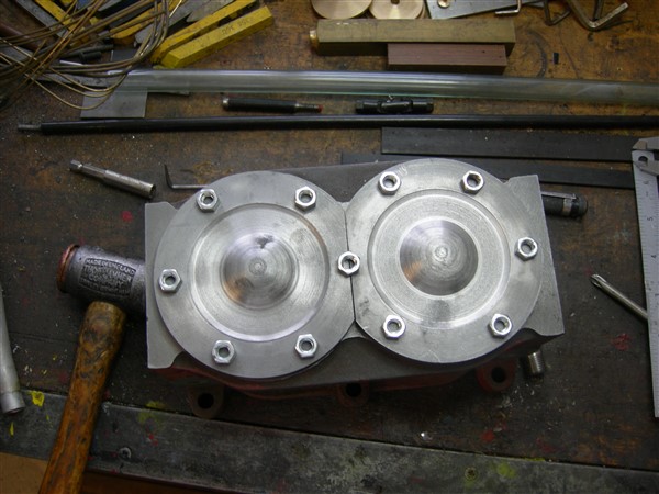

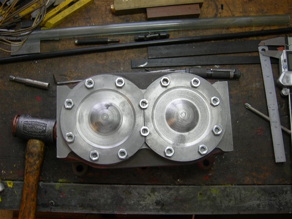

I spoke too soon, I managed to skip a 'task' and sneak out to the w/shop for some pics!
12 M6 in North/South formation shows that the centre four do indeed spanner-foul.
11 M6 in East/West works Ok.

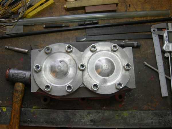

Fred's 14 looks really pretty in M6.

M8 in East/West works but looks a touch 'heavy'

I vote for more and smaller. Looks more like a big engine.

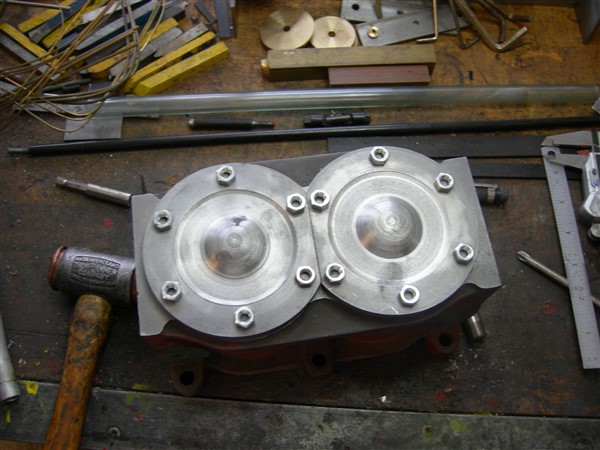

Hmmm! It was nice to dodge the 'domestic overload' and spend all but a whole afternoon on this problem and am rapidly coming to the conclusion that there is no 'right answer'.

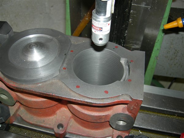

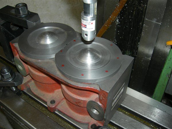

After re-learning to use the DRO's P.C.D. function (and getting it wrong a few times, angles in decimals, not degs and minutes!) I tried 8 (14) and it only works (ish) if the two on the join are misplaced to be actually on the join. No biggy you might say, but that leaves the two over the valve port end, VERY close to the edge. 6 (11) works pretty much everywhere in East/West, but as we said, not in North/South. I also tried 7, but that throws up 13??? as a total, and 9 (17) with only one on the join, but that's getting precious close to spanner-foul again on the next four out, but looks nice. I haven't tried that with two (16) on the join yet; that might do the needful, but they would also need the join two misplacing slightly.

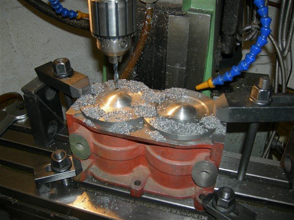

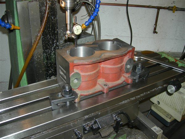

Right, first job was to set the block on the miller table, nice and true. I used the finger-clock on the bore edge, checking for the bore centre-line with the 'Y' axis, and at the same time re-proved the bore centres to be exactly 3.3".
Then having eventually re-programmed my head to the P.C.D. function, it has an inexplicable habit of converting some co-ordinates to neg. on entry, in this case the first angle. Most frustrating! I set about plotting all the possible stud number variations talked of above. In the end it boils back down to Fred's 8 (14) being the most suitable, the two on the intersection need moving about 1/16" to find the join and if I move the two at the steam port end a little, they should survive the closeness to the port. That's the only place where 7 (13) with one on the join, would be a mild improvement.
Hole positions on the cover,
and next to the bore.

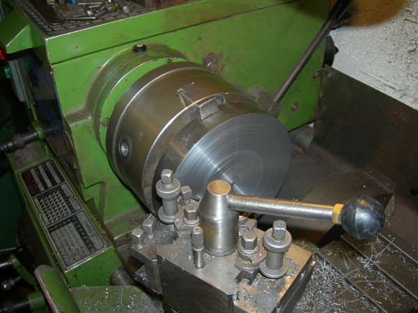

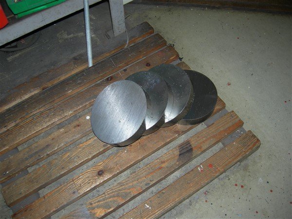

Meanwhile back at the ranch, there's been a delivery.
Not only that but they've been for a spin. Just facing up for now.
