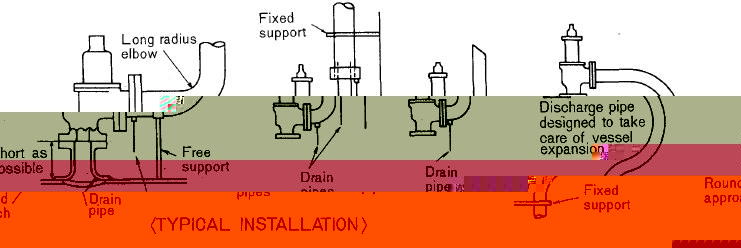

However the Bologna slice isn't some hypothetical thing that I made up. This has been industry practice in the past.
Example, 3rd from the left: -CB
Instead of focusing on the brain storming excercise of this thread you are stuck in safety mode?

This is exactly why you are making assumptions that are not true about me!
LOOK AT THAT IMAGE.
P.S. I can't even reference something that was industry practice without this damned knee jerk safety reaction. That's what just happened. Way overreaction.
LOOK AT THAT IMAGE.
