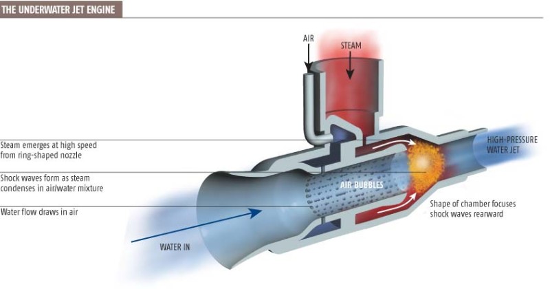

Several years back this device was promoted as an effective steam powered thruster. Where has this thing gone?....nowhere. A quick review of their advertising nonsense, quoted below, is just "Mumbo-jumbo".
"The Pursuit Marine Drive produces thrust by using the energy from high-pressure steam to draw in water through an intake at the front and expel it at high speed through the rear. The steam emerges at high speed from a rearward-facing ring-shaped nozzle into a cone-shaped chamber, where it mixes with the water (see graphic). Shock waves created as the steam condenses are focused by the chamber to blast water out of the back...............' followed with several more paragraphs of statements that are laughable to anyone who has a firm knowledge of thermodynamics and fluid dynamics.
Nonsense Thruster.jpg (42.16 KiB) Viewed 55903 times
Re: Steam Thruster?
Fred,
They didn't really have a full understanding of thermodynamics when Watt and Fitch were around, and as far I know, this level of knowledge while maybe necessary for ASME boards and PE exams is not really required to build a steam launch or participate in a technical discussion about steamboats theoretical or otherwise.
I really do appreciate your engineering/science explanations when you give them though.
