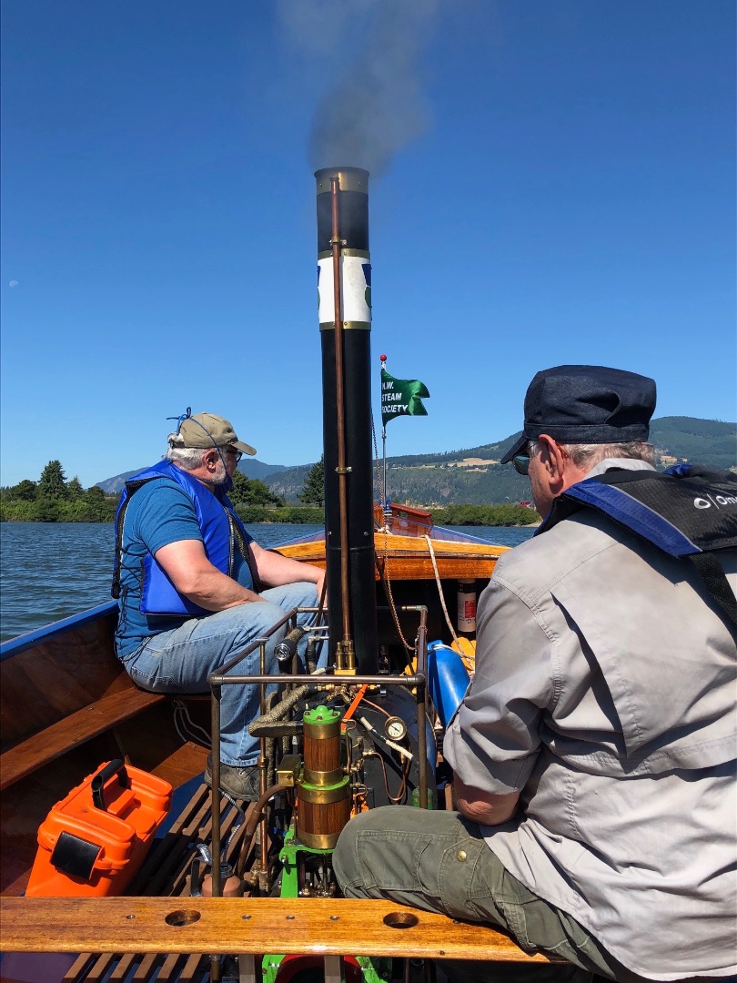

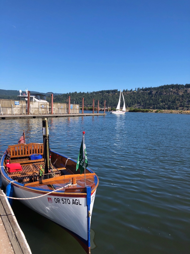

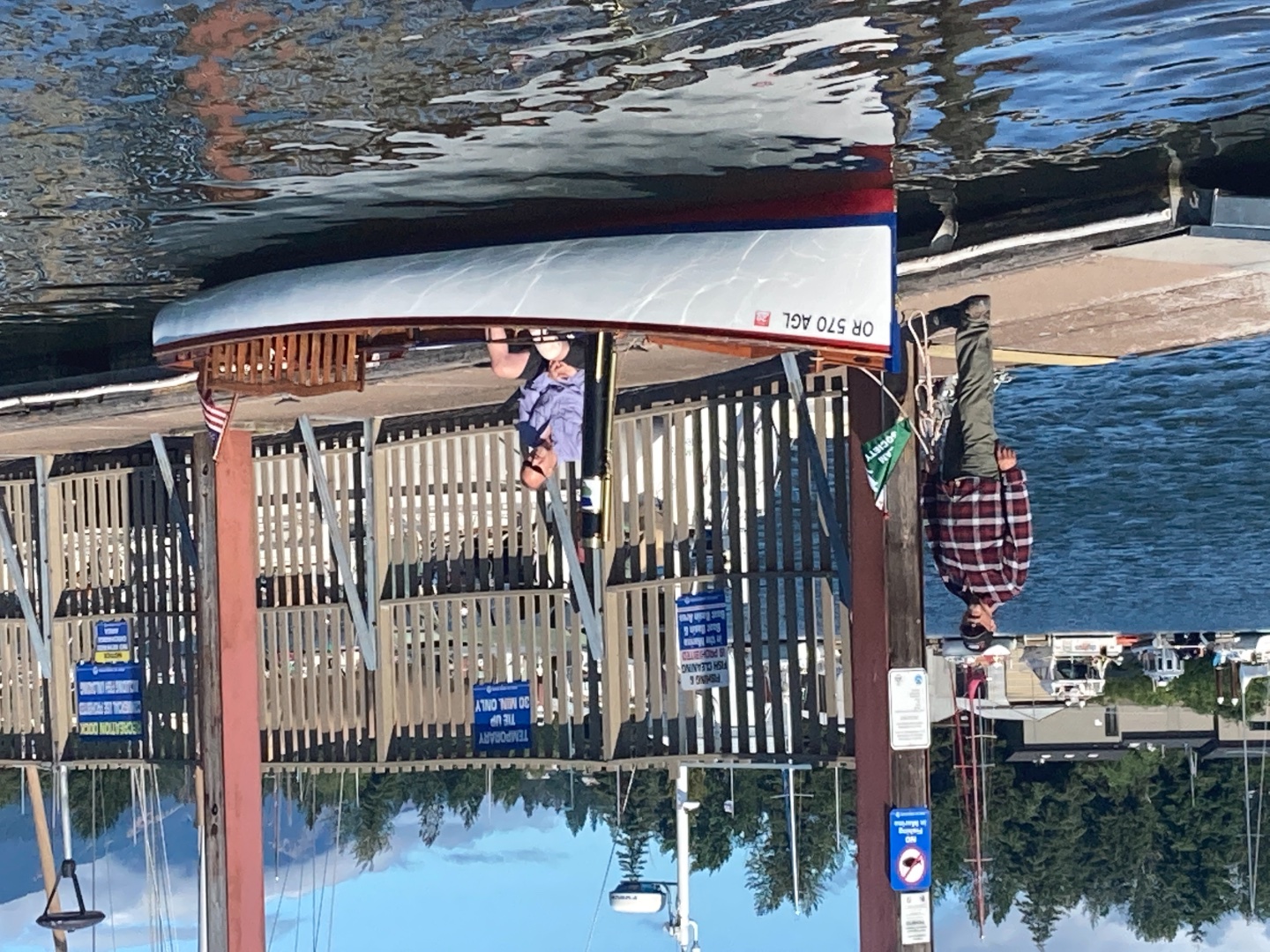

Well, Steam Thistle Cluaran went into the waters of the Columbia River this morning, in the "almost" protected breakwater of the Hood River Marina!!
Aside from way too much wind for a First Test, and the rudder deciding to jam due to the pintle and gudgeons being machined too tight...
The cold water shrank the reamed holes in the gudgeons just enough to bind on the steering pintle shaft. Not my machining work, and I will correct it.
Beat on them...
We made it safely back to the dock and proved this little steam launch should work as intended.
We look forward to the next water test when we can better steer the boat! And a calmer day.
Pics show my neighbors assisting.
I'm delighted and tired. And happy to report success.

I see those two photos are not correctly oriented. Sorry. They appear correct on my computer...
For those on you in Australia, the second photo should be just right...

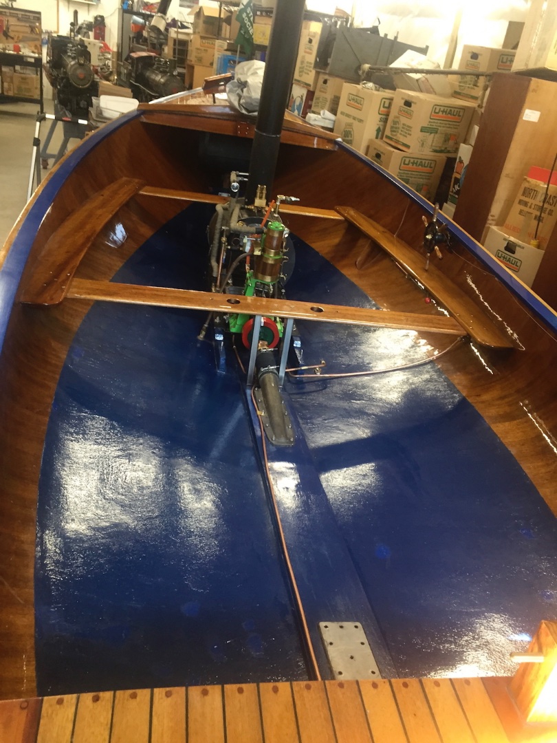

Yes, Thistle hulls are not tiny:
17 feet long by 6 feet wide, with a flat bottom planing hull.
And our boat moved along nicely.
Looking forward to further testing, in lower winds...

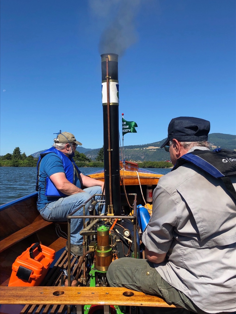

One of my loyal dock hands sent me a nice picture as we steam away.
'Hope it posts in the correct orientation...

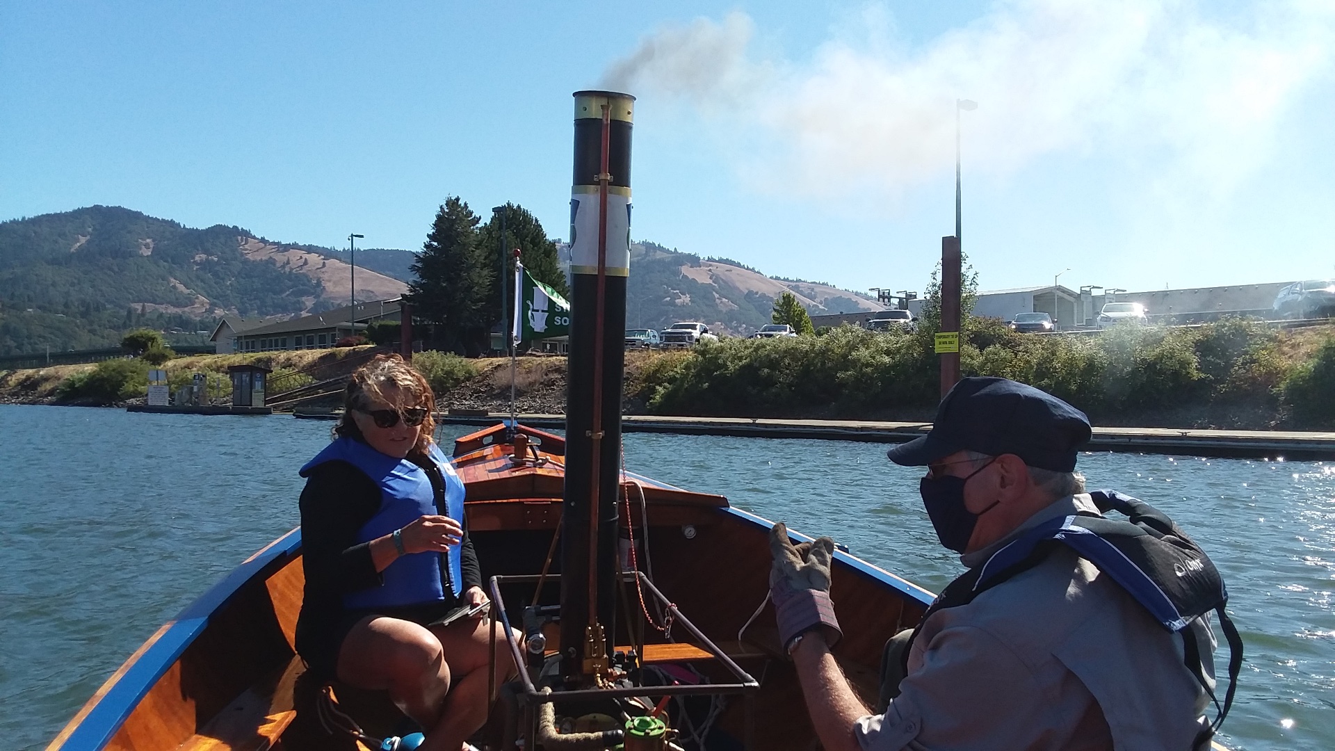

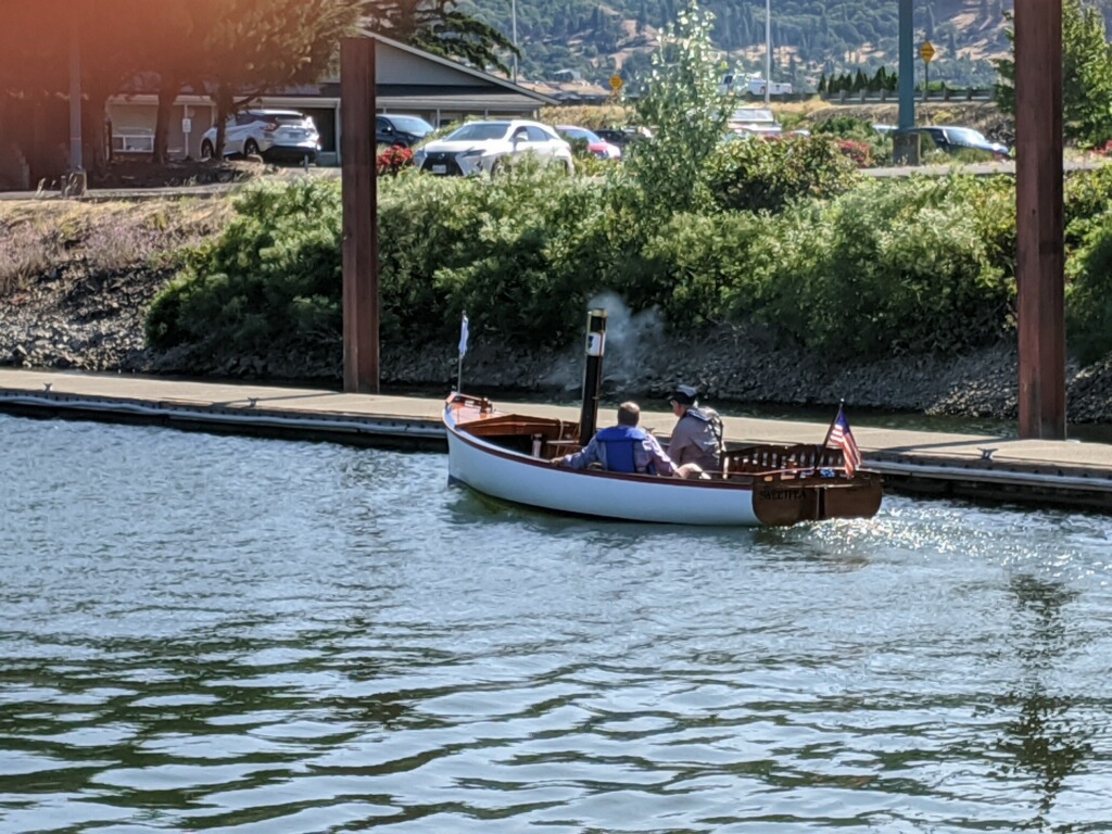

I am happy to report that yesterday's Steam Trials #2 went perfectly!
We steamed around the inner harbor of the Hood River Marina, on the Columbia River, for a good hour.
That was sufficient time to let the power plant reach an equilibrium of efficiency. The condenser gauge was indicating 11 inches Hg vacuum, better than expected.
Was eventually able to maintain 100 psi boiler pressure at full throttle, with 4 people aboard Cluaran.
And I continue learning how the oil fire needs to be managed.
So: No problems, medium stress as the new operator, and much pleasure experienced.
And she scoots along nicely. Very stable, and tracks well, with noticeable side slip when turning sharply. Expected with her planing hull...
We now have an operational steam launch!!
