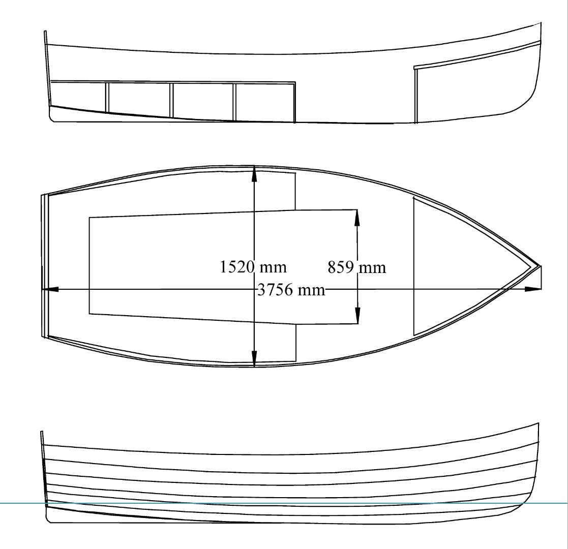

Various discussions with Mike Rometer about the Fairlight 13 have raised a small problem - basically its a small, if pretty, canoe. Having space for friends and grandchildren is not really possible given that steam plant would be equivalent to a person leaving space for perhaps one small other. However, keeping the boat small enough to fit in the typical UK garage was a red line not to be crossed. So where should one go next?
Tipped off about boat kits by Dietrich I have been doing some browsing and have come up with another suggestion for consideration. Below is a quick sketch and some photos:
Fyne Four Minimal.jpg (104.7 KiB) Viewed 20204 times
This is a design from Selway Fischer who sell it as the Stornaway 12. It can also be had from Fyne Boats as a kit of parts under the name the Fyne Four. What appeals is the way the side benches and the forward 'tank' can provide storage/tankage and buoyancy. With the centre board and centre thwart removed (and replaced by a frame cut from the building mould) there is reasonable space in the centre for some steam plant. The front tank could be turned into a rear facing seat by the addition of a backrest and cushion. The side benches at the rear would accommodate the skipper and one other thus meeting the "and the grandkids too" criterion.

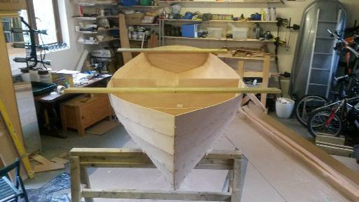

These photos give a feel for the boat under construction:
Fyne Four Overall.png (359.16 KiB) Viewed 20203 times
What we probably need now is some input from Russ to explain how his Thistle hull had the propeller, etc added.

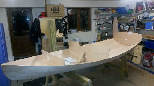

Here is another photo:
Fyne Four Part assembled hull.png (404.54 KiB) Viewed 20200 times
Lovely lines!

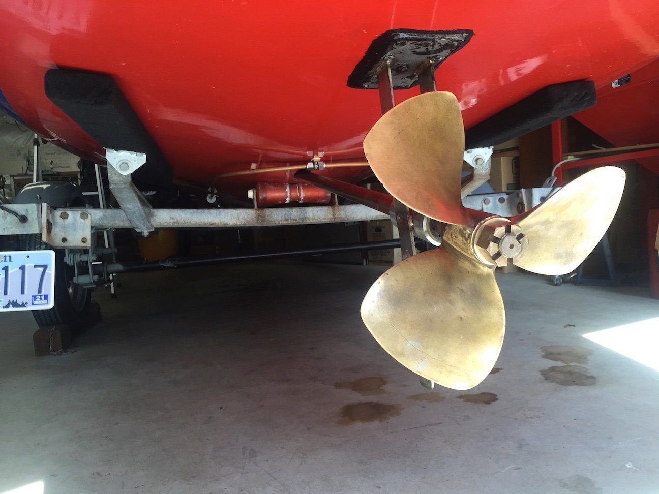

Many thanks for 'picking up the bait' and explaining what was done. That looks a wonderfully roomy hull from your photo, but coming from Small Garage Land we need to think rather less expansively. To further satisfy my curiosity, how is the drive and propeller dealt with under the hull? Looking back at you posts for your restoration, I found this:
ST prop installed 2 sml.jpg (151.81 KiB) Viewed 20156 times
I suppose my real question is whether that was the final implementation or did you add a skeg or other paraphernalia?

No skeg has been added. The visible stainless steel aft support for the cutlass bearing has two bars extending down to provide some impact protection for the prop. The welded parallel bars make a very stiff structure. This is actually a Bill Paulsoulich improvement over the original support which was V-shaped with no extensions below the bearing, leaving the prop blades exposed.
I expect the boat to exhibit sliding in turns due to the lack of any keel or skeg. 'Should be fun. The relatively sharp bow shape does provide some pivot area for turning, based on my experiences with Thistle sailboats.
