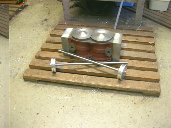

Not that I've actually done any more, except I have now acquired a copy of the drawings (I don't intend to follow them at all closely).
They show 5 fixings per head with one on the centre-line. That very neatly steps the outer four well away from the port area. As I said above "Too late" they are already drilled. Hmm, must get round to tapping them!

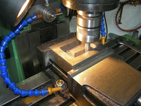

The ali pistons are finished and fitted to the rods, which aren't yet cut to length. I've gone with two rings in one groove to maintain the 3.25" stroke that I wanted.

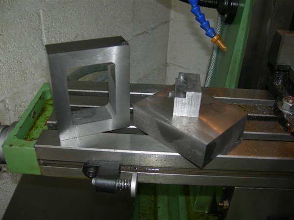

I acquired a large chunk of cast iron from which I've fashioned the valve chest blanks. Lot of metal still to remove from the middles.

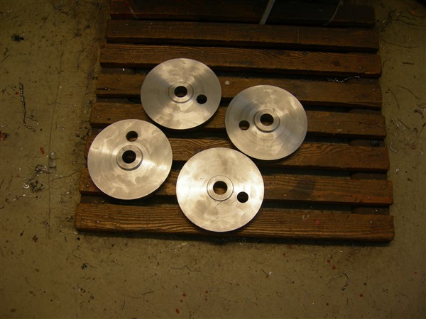

The crankshaft webs have been reduced to an overall thickness 0.750" with main bosses left at 1" for stiffness. I then made a fixture for the mill bed and bored the crankpin holes. They may just need a smidgeon more removing (reamer) before the pins are pressed in, after the shape of the weights has been machined.
Crankshaft (12) (600 x 450).jpg (62.57 KiB) Viewed 28720 times
Lots of metal to come off yet!

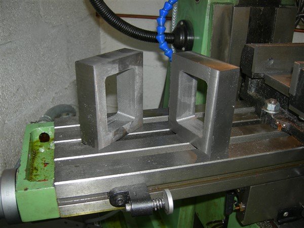

Progress has been with the valve/steam chests. Some cast iron was obtained some time ago, and I've spent a while ploughing out the centres. This method is cheaper and easier than making a pattern and then a 120mile round trip (twice) to a foundry.

Tomorrow, if I get left alone by the Domestic Officer, I might get some fixing holes planned and drilled. Two on each side (8 total).

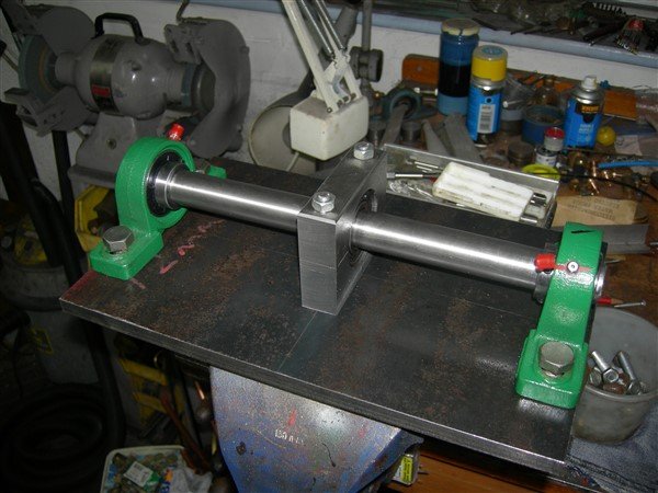

Main Bearings (2) (600 x 450).jpg (62.19 KiB) Viewed 28442 times
The base-plate marked out, drilled and tapped with the main bearings bolted down (upside down!). Further marking out has been done and the next stage is - remove the shaft and plough out the holes for the crank-webs etc. making sure to leave somewhere to bolt down the end pillars!

Mike,
It looks like you're doing a first class "best-o-gear" job on it. :-) Those pillow blocks in that service will outlast all of us. Give em a shot of white lithium grease occasionally. Curious though, not seeing a tail shaft to put a fly wheel on etc, not that a simple twin really needs one though.
Re: And Now for the Twin
That's only a length of drill rod for lining up the bearings. I still need to assemble the crankshaft, but the bits are made.

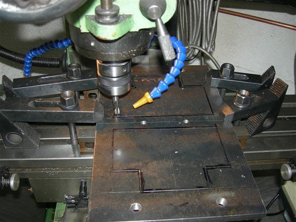

After a short interlude Base-Plate work has continued.
Base-Plate (3) (600 x 450).jpg (70.88 KiB) Viewed 28395 times
Truing to the machine was simple, just aligned it against the column, because the plate had been squared beforehand.

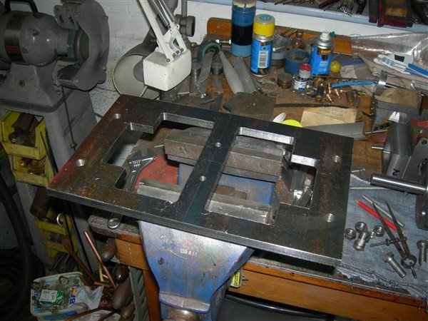

Base-Plate (7) (600 x 450).jpg (77.21 KiB) Viewed 28395 times
Almost ready for the mounting angles to be welded on.

Mike,
will you re-machine your engine bed plate after welding bits to it? The whole thing is probably small enough to put into an annealing oven if you can find one, or a potter's kiln would do at a pinch. Domestic ovens don't really get hot enough. I suppose that's why many engines have cast iron beds, although I quite like the idea of built-up beds designed carefully and bolted together.
