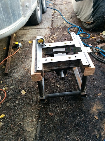

Well, I managed to spend a few days in the shop over the last month, and have made some more progress. The engine base has the crank mounted and is supported on a stand on casters so I don't need to lean over so much:
More photos and a very short clip of the crank turning here:
https://goo.gl/photos/QCMViFjvYNQRpW9K9
Next up: make columns, column cross-braces, crosshead guide, crosshead slipper, and connecting rod :). Should keep me busy for a while :).
