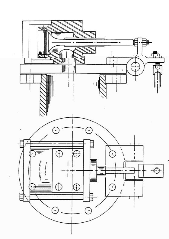

Re: Steam Actuated Inlet Valves?
From Lionel: "If your engine is running at speed and your inlet valve opens too soon you could end up with an extremely high pressure event in the cylinder as the piston tries to compress a lot more steam than was intended."
Back in the 1970s the US DOE financed GM, Lear Industries, plus a few others to build a modern, low emissions steam car. Single seated poppet valves for admission and exhaust were generally used, the exhaust valves usually used what looks like an ordinary IC engine exhaust valve configuration.
The admission valves were also poppet valves, but reversed such that main steam pressure seated the valves, and thus if there was too much compression the admission poppet valve would just relieve compression back into the steam chest. This worked fine, and GM stated that this did not hurt engine efficiency.
So on that knowledge, probably this relief feature would be easily incorporated into any new steam engine design. The poppet admission valve on my uniflow domestic heat-power module steam engine had this feature, along with sharp cutoff that is usually difficult to achieve with a simple poppet valve.
