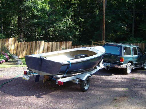

Two aluminum angles, 2 inch x 2 inch x 1/8 inch are bolted through the hull to act as bilge keels, about 2 feet apart, about 6 feet long each, to keep the boat tracking properly. Inside the hull, the thru-bolts attach to wood stringers for mounting floor boards.

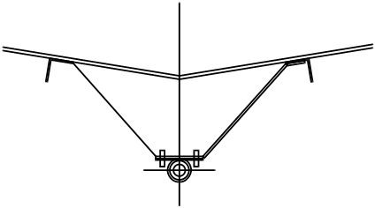

The stern shaft bearing (1 inch diameter shaft) is a WW Grainger food service UHMW plastic spherical bearing, with a pressed stainless steel mount. This bearing has been in the boat for 14 years, initially with the 3/4HP electric motor, and now with a 13 horsepower 1000 RPM IC engine drive, bearing is still very good. The struts holding the outboard bearing are 1/4 inch x 2 inch steel flat bar, extending out to the bulge keels.
This configuration of angled braces can take considerable side loads, like the ones you get when the turning propeller hits an underwater obstruction.

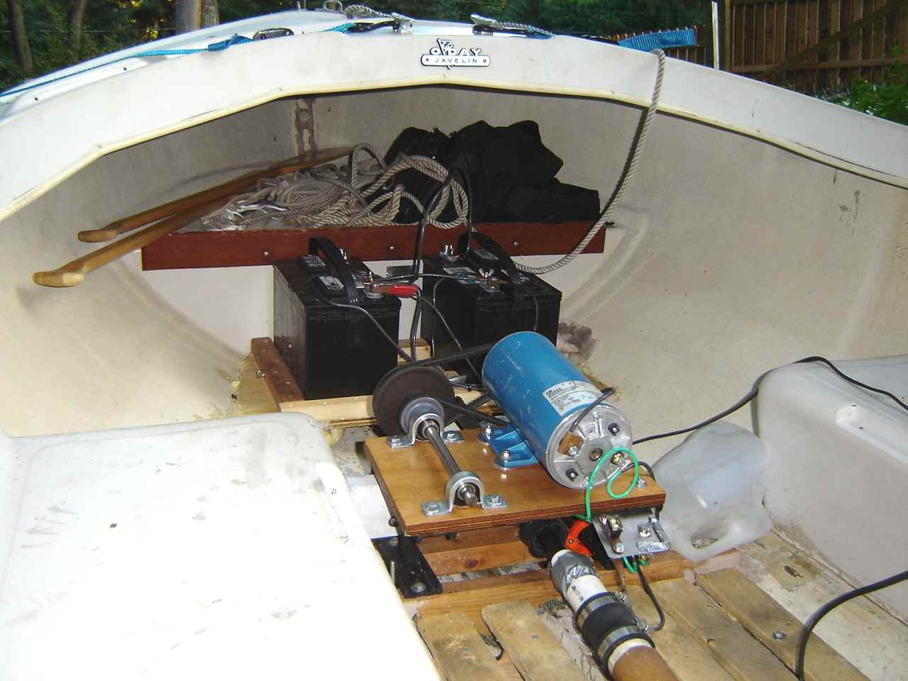

The electric installation. The 1 inch main propeller shaft is about 6 feet long, and I used a Home Depot PVC sink drain fitting as a stuffing box for the shaft, with some greased twine as packing. Believe it or not,this $2.00 fitting is still in service, all OK!

Electric boat, ready for its first outing.
The boat is almost all e-bay purchases:
Boat with trailer, with broken mast, $107.
I then paid the guy I purchased the boat from to fix the trailer, new tires, new bearings, new lights, and deliver to my house for $250.
Pacific Scientific 3/4 HP 24 volt DC Continuous duty PM Motor, New, $40.
Bronze 3 blade prop, 14 x 16 RH, slightly damaged, but OK at 400 RPM, $35.
Two Group 27 Marine batteries, new @ $69. each (now batteries are far more expensive)
Plus about $100 for jack shaft and bearings, pulleys, cables, etc.

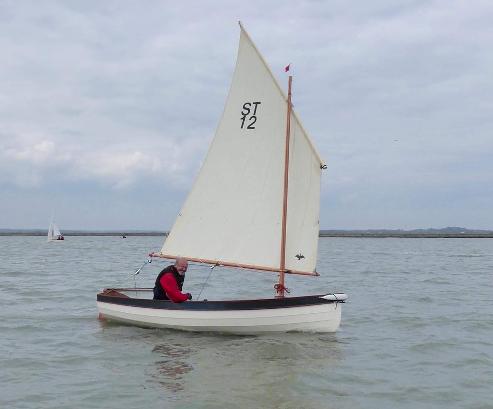

Hi Folks
Thanks for all your posts.
I have just stumbled across a nice photo of the Stornoway 12 which shows what a pretty boat it is but does emphasise just how small a 12 boat is.
The boat in the photo is for sale. See: [https://www.davidmorrisboats.co.uk/blo ... nghy-1900]

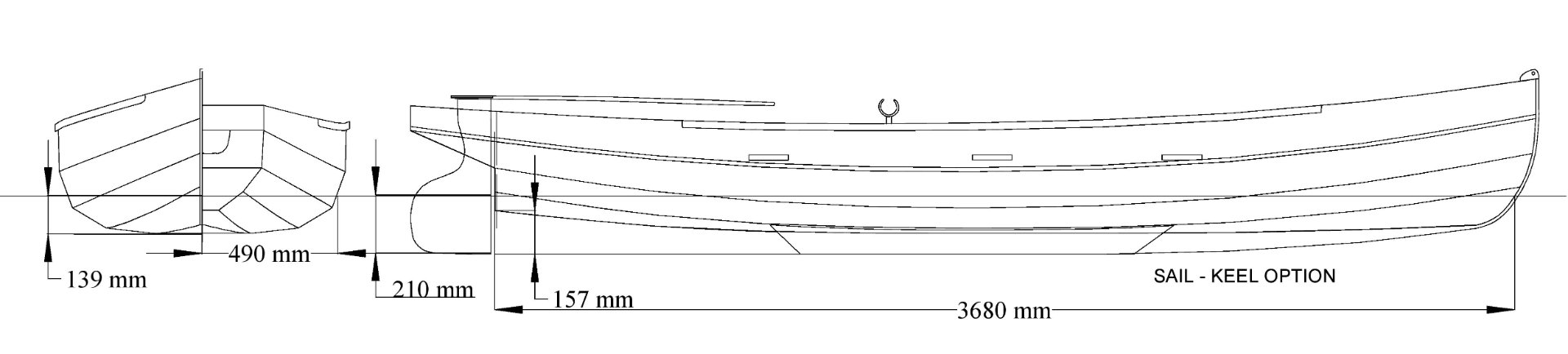

I have also been working on the drawings and, following the discovery of Simpson's Rule, can offer you some data with which to play:
Displacement = 19.14 Cu Ft, 571 lbs or 259 kg. Typical build weight is 45 kg.
LCB is zero.
The Block Coefficient is 0.00000052 (Slippery as an eel!)
Waterline length 3680mm, 12.07349 ft.
Breadth is 980mm, 3.21522 ft.
Draft 139mm, 5.47244 inches.
V = 4.66 knots, 5.36 MPH.
Power requirement by rule of thumb is 0.45hp.
