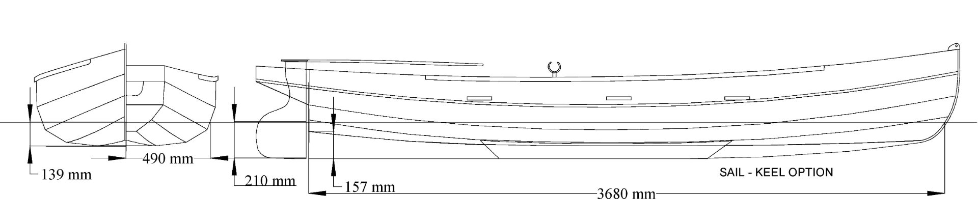

Hi Everybody
Here in Wales the Welsh Government has lifted most of the Covid 19 restrictions, but it looks as if nobody told the Weather Department. It is cold (10.9 degrees C), windy and wet which made it seem ideal for yet another session in the Office with the computer. However, this time I have come with my shiny new copy of Dave Gerr's Propeller Handbook that I have read once and am now struggling to use. https://brownsbfs.co.uk/Product/Gerr-Da ... 0071381765 (11.19 GBP for the original edition or 18.99GBP for the Second Edition).
I have also been working on the drawings and, following the discovery of Simpson's Rule, can offer you some data with which to play:
Displacement = 19.14 Cu Ft, 571 lbs or 259 kg. Typical build weight is 45 kg.
LCB is zero.
The Block Coefficient is 0.00000052 (Slippery as an eel!)
Waterline length 3680mm, 12.07349 ft.
Breadth is 980mm, 3.21522 ft.
Draft 139mm, 5.47244 inches.
V = 4.66 knots, 5.36 MPH.
Power requirement by rule of thumb is 0.45hp.
Picture for the Forum-page-001.jpg (86.62 KiB) Viewed 10815 times
Re: Antidote to Cabin Fever?
Posted: Sun May 23, 2021 8:15 pm
by PeteThePen1
The output I have generated using Dave Gerr's book is as follows. Some items do not seem to be quite right to me. Part of the problem is that for such a small light boat the calcs are all off the bottom of his charts.
Power requirement (SHP) = 0.47 HP
SL = 0.088
Estimated Slip = 0.583%
Suggested propeller size - this varies significantly with engine revs:
Summary Table
Shaft Speed---Diameter “ ------ Pitch “ Pitch Ratio
300 ---------------- 13 -------------- 19 ------- 1.46
350 ---------------- 12 -------------- 16 ------- 1.33
400 ---------------- 11 -------------- 14 ------- 1.27
450 ---------------- 10 -------------- 13 ------- 1.30
500 ---------------- 09 -------------- 11 ------- 1.22
550 ---------------- 09 -------------- 10 ------- 1.11
600 ---------------- 08 -------------- 09 ------- 1.13
The original hull design in the sailing mode (i.e. with a keel and skeg) suggests only space for a 6 inch propeller if the propeller is not to drop below the line of the keel. Given that this is the sort of boat for exploring little creeks and shallow waterways it would be a shame to increase its draft with a lot of bronze hung under the stern. Thus I was idly wondering about twin screws. The idea has been well tried by the Victorians in the launches that they built for work in the 'Colonies'. Whether it would be possible today I am uncertain. There are certainly plenty of very small plastic propellers offered on eBay, though I have seen none that are left handed.
Addendum: I have done a few more calcs. I have assumed that the slip figure for a single screw is the same as for a twin although strictly twin should do slightly better. I have also assumed that the shaft horsepower from the single screw calc is split into two for the twin calc since there would only be one engine. The figures that emerge rather suggest that it is hardly worth the bother:
300 ---------------- 11 -------------- 19 ------- 1.73
350 ---------------- 10 -------------- 16 ------- 1.60
400 ---------------- 09 -------------- 14 ------- 1.56
450 ---------------- 09 -------------- 13 ------- 1.44
500 ---------------- 09 -------------- 11 ------- 1.38
550 ---------------- 08 -------------- 10 ------- 1.25
Thus it looks as if a shaft speed of 450 would work best with a single 10" prop. Fred was right way back at the start! I will now have to look at the bits in Gerr about more blades and the amount of clearance next.
