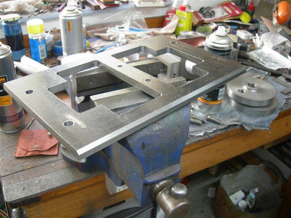

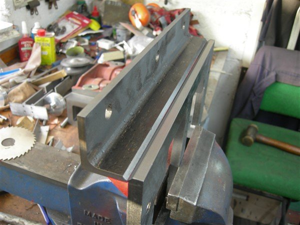

Progress has been a bit piecemeal. The weld preps are done but as I have to weld in the yard it's been delayed by the weather.
The base angles : -

Both preps are approx the same size with the one on the angle taking about 2/3 of the thickness (1/4"). Keeping the remaining plate thin assists with penetration. It is probably thinner than would be left for 'stick'.
Base-Plate (9) (600 x 450).jpg (56.8 KiB) Viewed 28250 times
For the final set-up a gap of approx the wire thickness will be left also to aid penetration. I'll show that later.

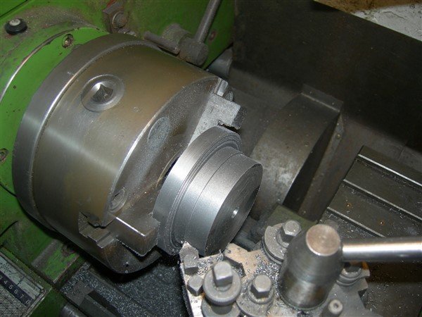

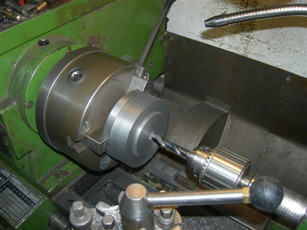

So, unable to weld, I had to do something, so I got on with a left-over job, the bottom cylinder covers.
Cyl Cover (21) (600 x 450).jpg (62.96 KiB) Viewed 28249 times
Lots of metal to remove as these are C.I slugs rather than castings, for the same reason as the valve chests (cost and hassle).
Cyl Cover (22) (600 x 450).jpg (57.46 KiB) Viewed 28249 times

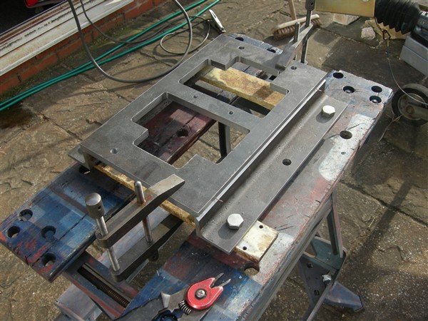

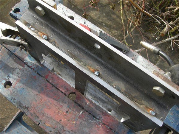

Having prepped all the plates for welding, the weather held things off for a bit, as I have to weld outside and MiG has no friend in the wind. Trying to weld between gusts is just that, 'trying'. First the set-up.
Base-Plate (12) (600 x 450).jpg (84.02 KiB) Viewed 27908 times
(Note the pieces of wire in the joints to give a penetration gap.) This set-up was a possible cause of extra distortion that I hadn't allowed for. Hindsight is a wonderful thing! I should have taken a cleaning cut across the under-sides of the side angles AND the set-up bars. I finished up with a slight twist (a few thou) to the final assembly which I surmise could be due to that, as I was careful with the weld order to eliminate that as much as possible. No matter, it all came right in the end.

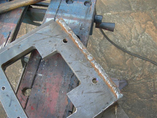

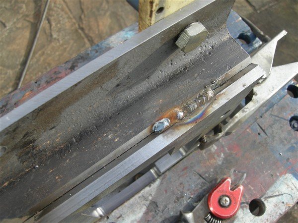

Tacking is the first point where distortion can begin. I only used four tacks initially. Right then left, turn the job around then left then right, trying to keep the cooling time constant (contraction). Next was short root runs into the preps.
Base-Plate (15) (600 x 450).jpg (69.18 KiB) Viewed 27908 times
DO NOT attempt a complete run down one side, the heat build up WILL build in distortion. Do similar to this the other end, on each side, then do a third in the middle.

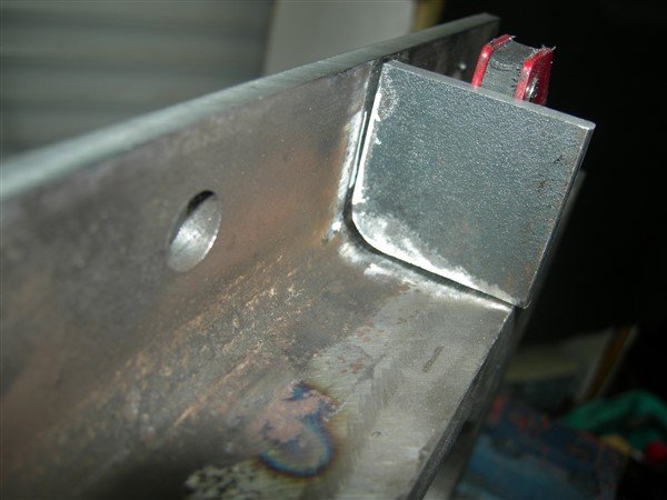

The welds were initially cleaned off with an angle grinder (welder's friend) and also some preps added for the end plates.
Base-Plate (19) (600 x 450).jpg (65.98 KiB) Viewed 27907 times
Base-Plate (21) (600 x 450).jpg (72.79 KiB) Viewed 27907 times

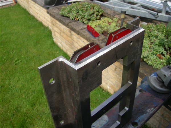

Until recently I have been limited to CO2 for MiG gas so splatter can get quite heavy. A lot will just chisel off or the angle grinder get rid. Obviously the end plates add stiffness, so I decided to add a little more with some gussets one on the inside and two on the outside (each side).
Base-Plate (25) (600 x 450).jpg (42.28 KiB) Viewed 27907 times

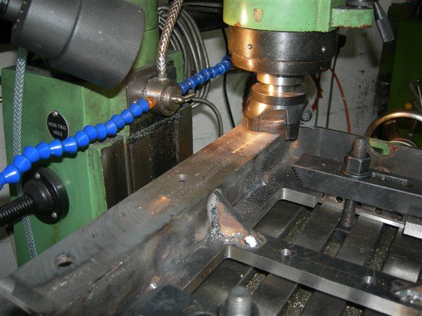

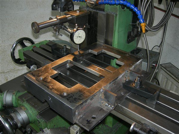

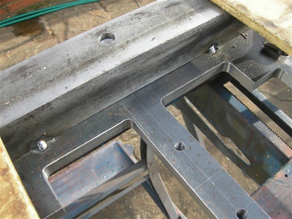

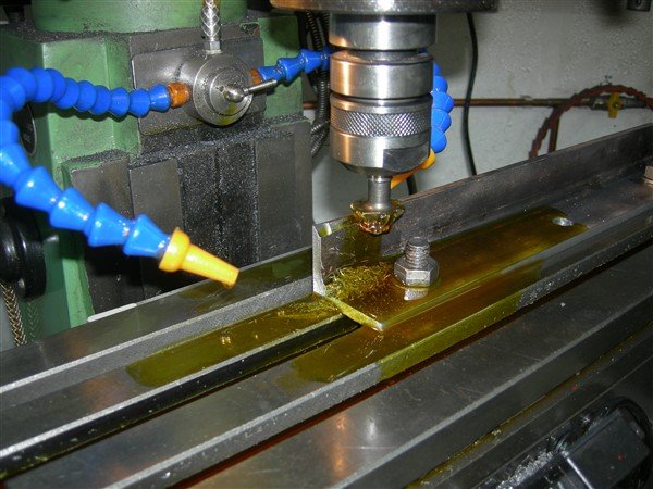

The assembly was then checked with a straight edge for distortion and found slightly wanting, showing a small twist, as I said previously, I endeavoured to remove that in the press, fairly successfully. I then set up on the mill with shim packing, checking for the best set-up with the D.T.I. and proceeded to true the bottom faces.
Base-Plate (27) (600 x 450).jpg (68.23 KiB) Viewed 27907 times
As mentioned earlier my mill is too small for a one hit set-up so a two cut job was called for, checking for the best start with again the D.T.I.
Base-Plate (29) (600 x 450).jpg (74.25 KiB) Viewed 27907 times

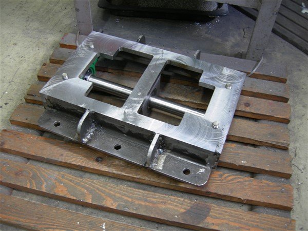

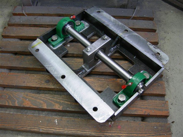

It took two passes, as unfortunately on turning the assembly round for the second end, a bit of unnoticed swarf got under one corner and caused a tilt. I never actually found it, but it had to be, as the discrepancy was 0.005" and I was taking 5 thou cuts. The under-side of crank bearing pads were then cleaned off with a long series cutter ( to get in), and the the bearings bolted in and tested. Nothing is ever perfect but these are as close as I ever expected to achieve, perfect! The outer gussets and base corners were shaped with the welder's friend.
Base-Plate (30) (600 x 450).jpg (65.84 KiB) Viewed 27906 times
Base-Plate (31) (600 x 450).jpg (66.12 KiB) Viewed 27906 times
Now I need to look at the crank webs again, or the con-rods, or???
