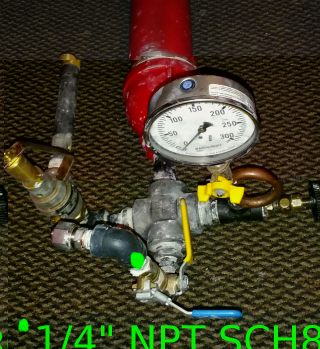

Re: What are the concerns/safety of an unfired >100C vessel
Fred,
Please comment on this picture.
The cross is Class 3000 Forged.
Pipe after Red PV is schedule seamless 80 pipe to the first Valve and Class 300/3000 to the first Valve.
I tried to use MAWP 200 except for: Lockable 3/8" 150SWP Valve after 200SWP Apollo ball valve. (I can take it out, but I wanted the
[Attachment Redacted,: Physical Layout Changed See Newer Post.]I tried to use MAWP 200 except for: Lockable 3/8" 150SWP Valve after PV valve.
From CB "Fred, Please comment on this picture....."
I see code violations here, and questionable functionality. More tomorrow, need sleep, I have to drive to NYC at 430 AM
Redacted first picture, mis understood about the piping orrifice restriction.
PV Top Rev2
PV Top Rev2
* No Restriction from ASME Safety to 4" pipe
* 1/4" NPT SCH80 Restriction on incoming lines
Then the other end will just have a double valve for condensate and drain.
Thinking about just one of the 4" diam 36" piece for first test.
Not sure I understand 100% on which (if any) of the valves can be at the lower MAWP.
The yellow handled shutoff on the pressure gauge and the blue handled ball valve are only rated 150SWP.
So I need to get a bigger pipe wrench or cobble together a strap wrench because part of the 4" pipe is being difficult and just my hands isn't enough.
I was then going to hydro it, but I wanted Fred to let me know if he saw any code violations on the last image. :-P
