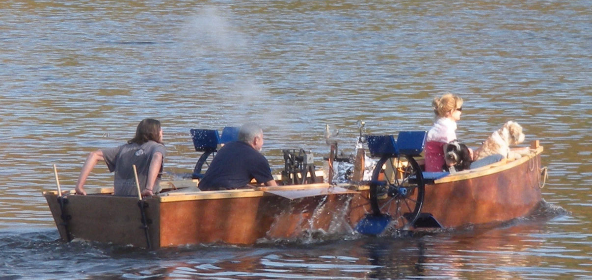

A picture that appeared in the steamboating magazine "The Smokestack" at the end of 2010, (although there was no smokestack on the boat at the time).
Much thanks to all of you who provided guidance and suggestions during the building process. I remember buying the steel wheels (farm implement wheels), which form the basis of of the paddlewheels, in the late 1970s, at a “yard sale” for $10. At the time I knew exactly what I would use these wheels for, yet it took more than 30 years before the sidewheeler was actually steaming on the water.
I think the real spark that got me to proceed with the project came from a seafaring man named Sterling Hayden, his words that follow hold value for me, and possibly many others:
“The years thunder by, the dreams of youth grow dim where they lie, caked in dust on the shelves of patience. Before we know it, the tomb is sealed.”
- Lookout-Wife Katharine, with our two Tibetan Terriers in the bow, Son Jeanpaul at the stern, and Fred tending the machinery, First Outing

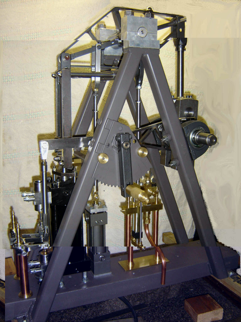

What a fabulous sound! DO you have more info on the engine you built for her. You gotta love walking beam engines!
Regards,
Bret
Bret
There is info on this engine under the "Technical - Engines and Boilers" Section of this website, under "American Walking Beam Engine". I really like the slow speed of the engine, getting to see everything rocking and rolling, making the boat move forward. I still plan a condenser, which will virtually silence the exhaust note, but I think I will usually run with the exhaust to atmosphere, I like the music of the machine. It uses Marshall-Bremme Valve Gear.
- Walking Beam Engine, with Wet Vacuum Pump and Boiler Feedwater Pump, 90 RPM 1 HP Rated
- WBE2007S.jpg (206.26 KiB) Viewed 19748 times

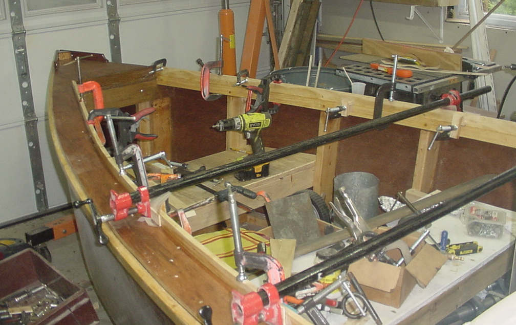

Putting small deck pieces around the hull, about 5 inches wide all around, with a small coaming.

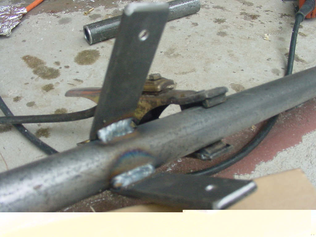

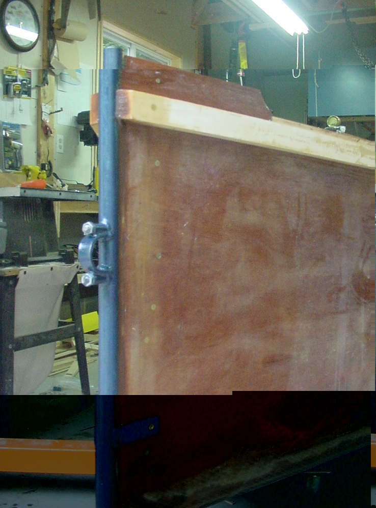

Also epoxied in the vertical stem piece, made of 3/4 inch extra heavy steel pipe. I was going to use brass pipe, but they wanted $175 USD for a 10 foot long piece! The forward eye for trailer winch attachment was welded to the pipe, and through bolted to a large reinforced piece of wood epoxied into the bow. I think the entire boat could be suspended from this eye. Lower down, two steel flat bars secure the stem to the bow, so I can ram something without the stem coming loose.
- 1/2 inch thick nine layer plywood decking with small coaming 1-1/2 x 1/2
- FwdDeck-Coaming.jpg (88.87 KiB) Viewed 20318 times
- Stem Piece in Place, with Winch Eye
- Bow-Stem.jpg (84.32 KiB) Viewed 20318 times
- Stem Flat Bars, Welded
- StemWelds.jpg (73.97 KiB) Viewed 20318 times
