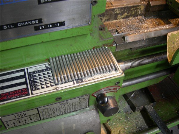

Work continues, but not necessarily in the obvious place. The purchase of some materials made the attention wander a little and having bought 303 for the studs I thought to cut some for the steam chests (20) and have threaded the 'block' ends, when perhaps I should have been getting on with the con-rods.

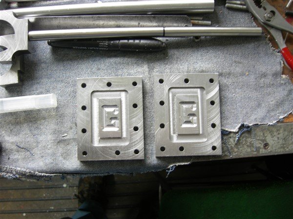

With the steam chest still in mind I added a little frippery to the covers, though it took a lot to actually push the button and start the cuts, what if it all went wrong?
Steam Chest Covers (600 x 450).jpg (73.93 KiB) Viewed 28759 times
Why 'G', well Cyril Taylor had a 'T', and Stuart Turner have a 'S' so Mike Rometer has a 'G'. :lol: :lol:

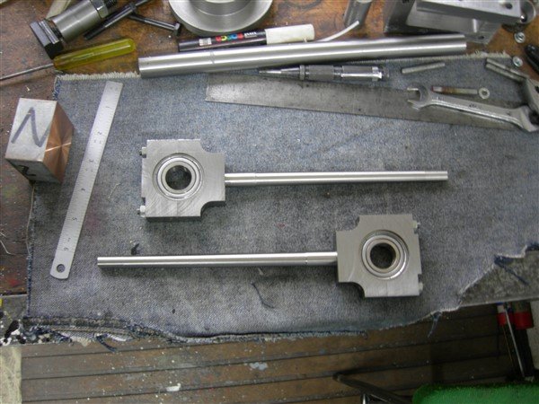

The big ends housings were tidied up a bit (I think there's a bit to go yet, perhaps a few corners to go) and the rods taper turned, threaded and attached. Threading was done in the lathe and chased with a die I find that the quickest simple way to get a true thread, the die always seems to leave a better finish than the tool.

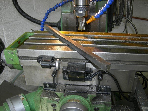

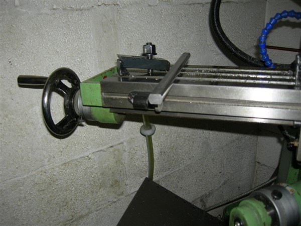

Whilst not a lot physical was going on I was allowing my two brain cells to rub together and eventually I've come up with my solution for the cross-head guides and mountings. Material choice is silver steel, however, whilst round would maybe do, I preferred square. A slot would be provided in the boss of the bottom cyl cover and a cross-bar fitted on the pillars to attach the bottom end. The cross-heads would be brass/bronze with a yolk small end on the con-rod with the gudgeon (wrist) pin fixed in the cross-head. (I hope that's all clear). Problem one. No square silver steel available in the required size (1/2"). I don't know about on the lee side of the pond but over here things like this are a problem generally, some materials are just not there! The only option was to make some round square!

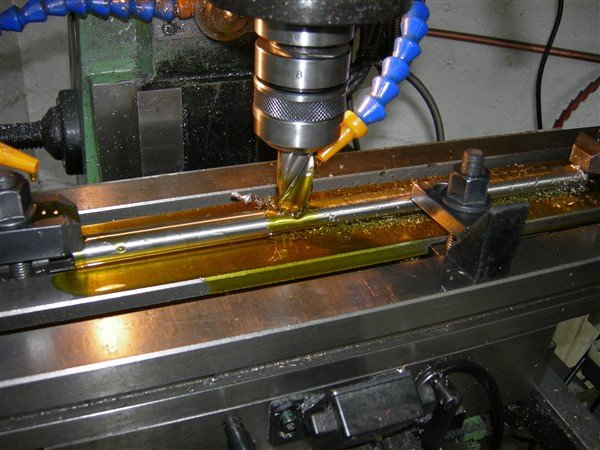

Across corners of 1/2"square is a touch under 18mm which just happens to nicely sit in one of the 'T' slots on my mill. Clamped at both ends and a floating clamp in the middle 0.100" was removed. 0.100" is not quite enough, but there is a method in the madness (0.104+" would be more correct).
Crosshead Guides (3) (600 x 450).jpg (71.87 KiB) Viewed 28156 times
Bar turned over and repeat on the other side.

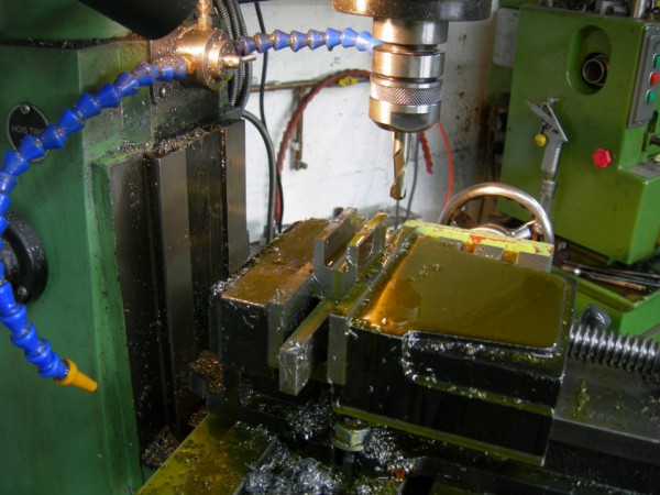

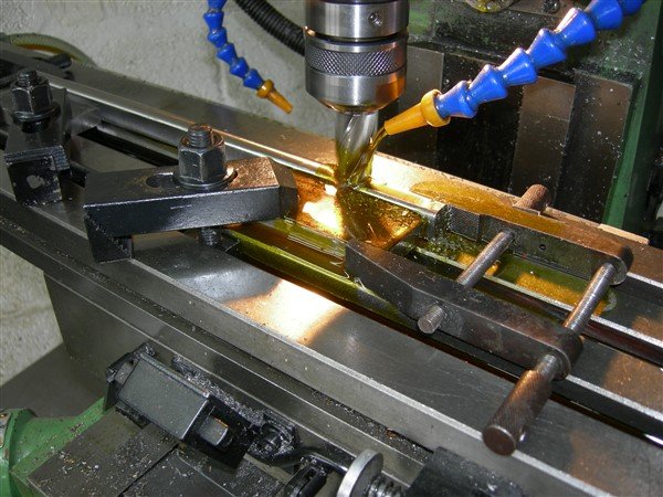

Re: And Now for the Twin
Two parallels were loosely clamped to the mill table and side one of the bar clamped to each of them, everything tightened up and a half depth cut removed.
Crosshead Guides (7) (600 x 450).jpg (78.57 KiB) Viewed 28153 times
The rational is that this isn't quite as rigid or possibly accurate a set up, so leave plenty for removal later.

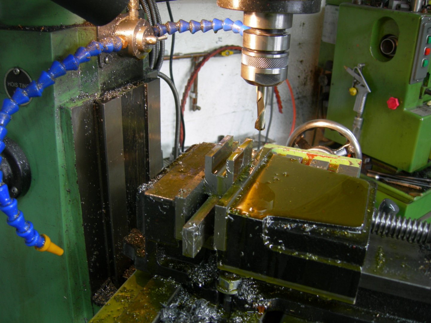

The bar then turned over and the last side cut to depth, then returned to the third side for finishing.
Crosshead Guides (9) (600 x 450).jpg (71 KiB) Viewed 28153 times
Boom boom!
Ahh! But what about the extra 0.008ish"? Well being a lucky fellow I have a small surface grinder so it will (perhaps tomorrow) be finished to exact size on there. I will cut it into two first as it is more than long enough to make both slides, and that will ease the grinding, as it is a 'hand pedalled' affair.
